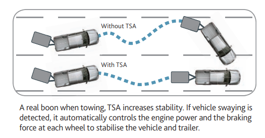

I know that at least Mitsubishi has been offering a similar feature on their L200 trucks since the 2016+ models. It's called Trailer Stability Assist (TSA). It won't apply the brakes for you but will control the trailer sway.
I'm sure other manufacturers have a similar feature.

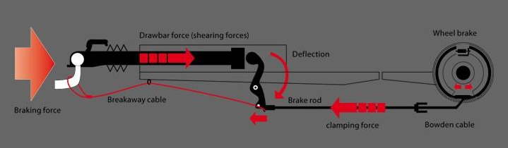

I think AL-KO has exactly what you describe. Even works with surge brakes since that's the most common here. We also have electric but it's very expensive and less common.
"How the AL-KO Trailer Control works
There are situations which any driver dreads: Even minor avoidance maneuvers, gusty winds or wind pressure when overtaking trucks or buses can soon cause the caravan to start snaking. In the worst case scenario, the caravan starts to snake and causes an accident. AL-KO offers an anti-snaking system with the ATC, which – similarly to ESP in cars –registers swaying movements on the caravan axle using a lateral acceleration sensor. A tolerance range for permissible lateral movements is stored in the system. If this is exceeded, the system intervenes, before the caravan is able to snake. The Bowden cables tighten causing the wheel brakes to be applied. The vehicle combination is stabilized and is guided back into the lane. The AL-KO Trailer Control brakes gently, but can be noticed by the driver. The brake lights do not otherwise light up."
Another simpler solution available here is the friction couplers. There is basically some friction elements inside the coupler that apply lots of friction on the ball to prevent trailer sway.
