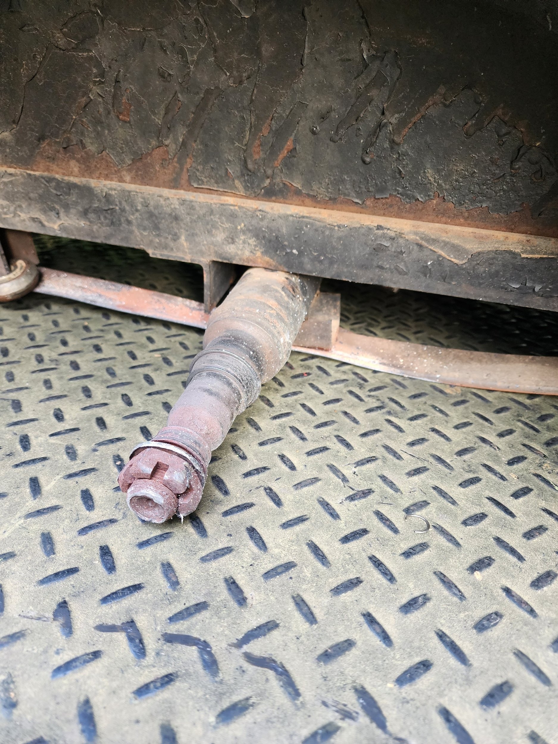

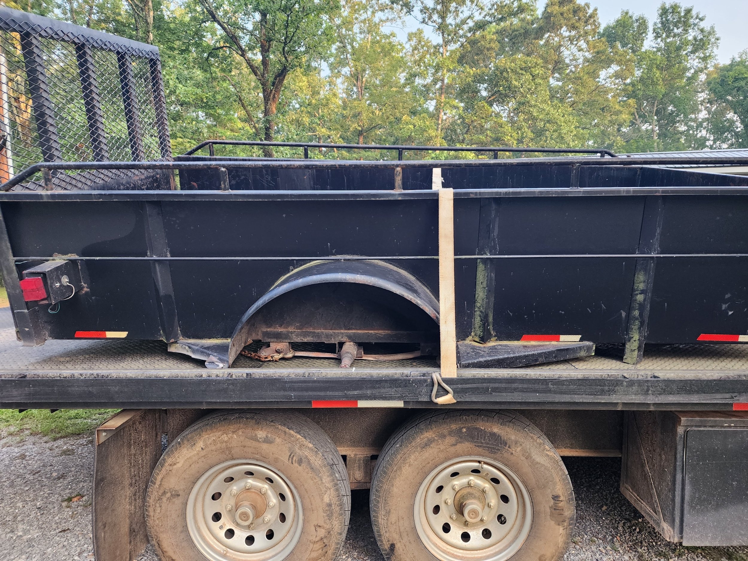

ok so you wants some pictures, I do believe this trailer was hauled wrong before I loaded it on my trailer and yes that was a 4 leaf spring before.

Ouch!!! They either had it overloaded or the springs were tired. It looks like something you can easily fix up and use, however.
Nah, it's not the springs fault, the nut is still on the spindle but the hub is missing, they've neglected to add grease to the wheel bearings for many many miles, the tire exited the situation then they continued to drive for long enough to wear through the backing plate, U bolts and the springs left the situation too...

you nailed it that is exactly what happened, I replaced the missing hub, springs and tires had to repair the wiring also.
20230719_092457.jpg Look closely and you can see that the metal got so hot it melted the wire going to the tail light.
