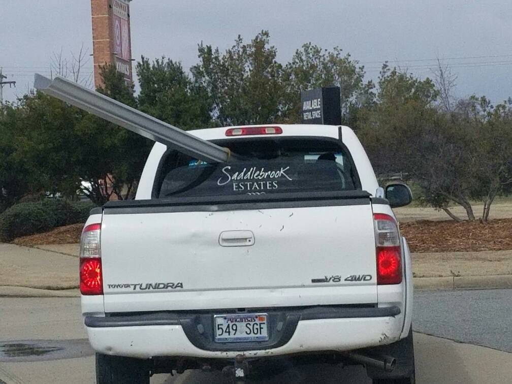

I think there is a more efficient way.
There aren't many single-photo memes that I've stared at longer than that one, just wondering... "how"?
