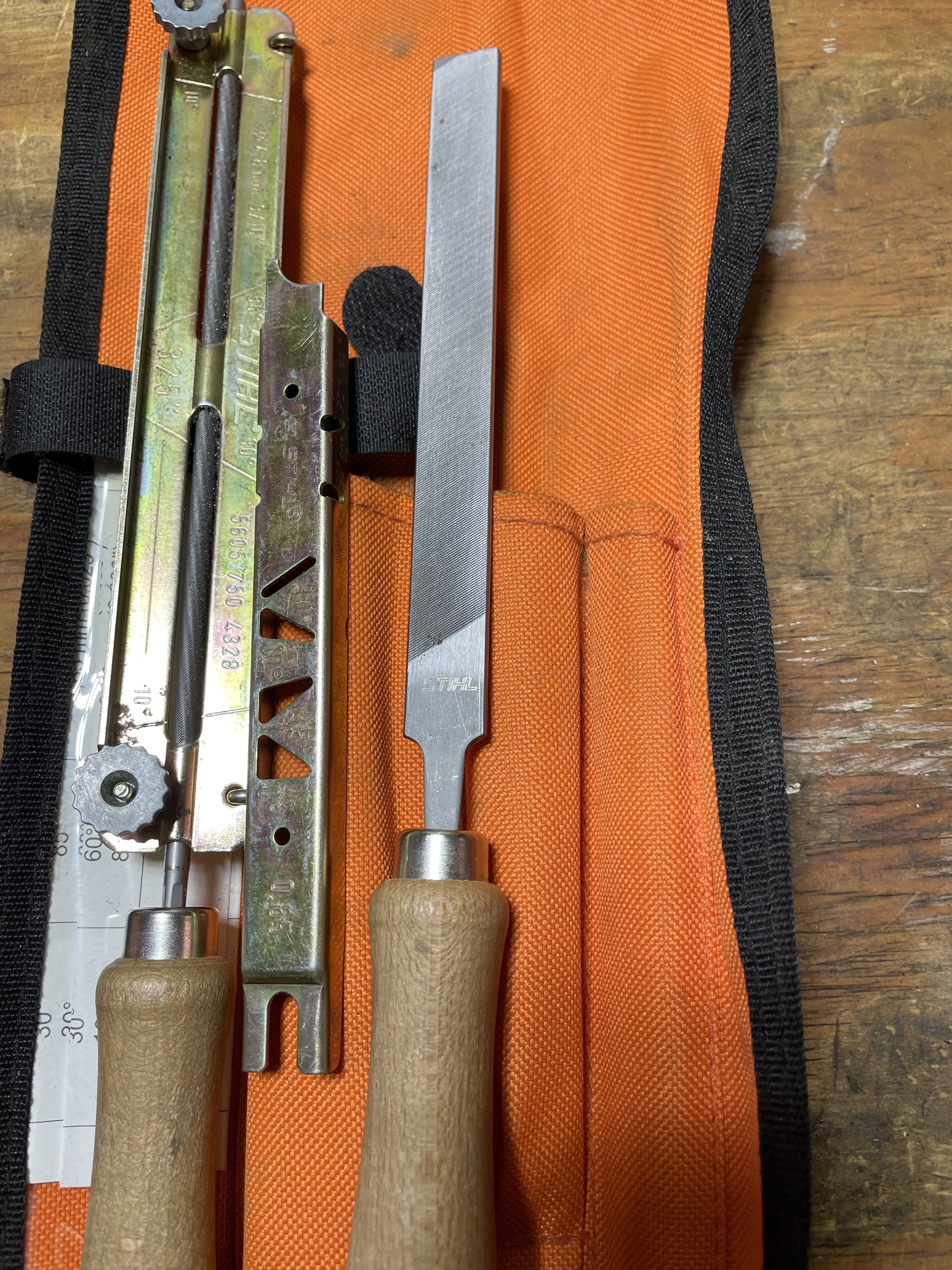

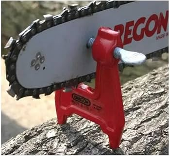

I use this thing, there is a guide for the angle, and you can't screw the depth it works pretty good for me. As for file I am not sure a file is a file but I think I use Oregon. I simply buy lots, I am not scared to throw it out and grab a new one.
This is what I use as well. Always have good luck with it and it doesn’t take that long to do. I also have the raker depth guides that I use every other sharpening.

... and for anyone reading about clamping a bar while filing, and wondering how you do that in the woods:
Available from many sources from $15 - $35.

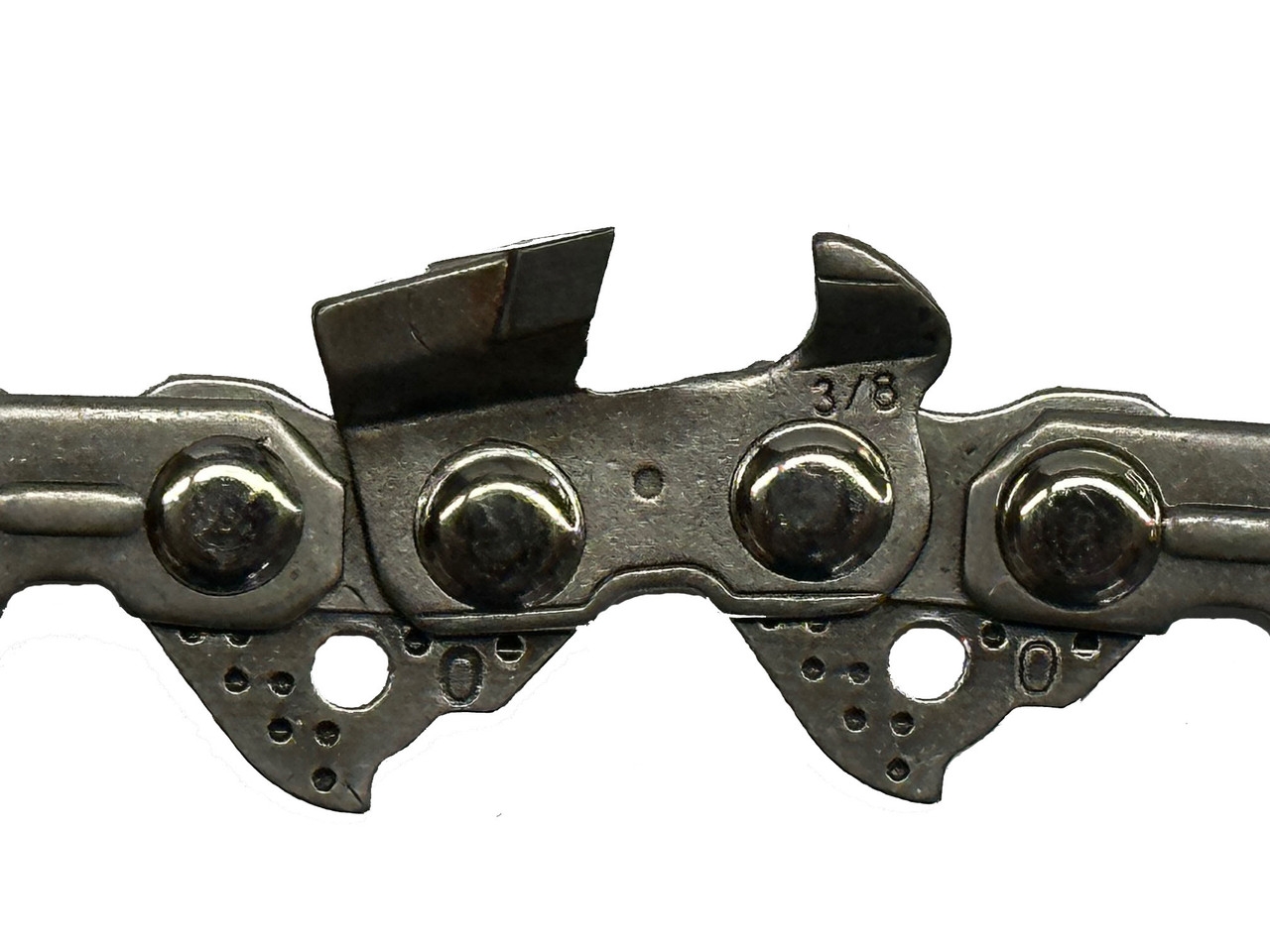

I don't really enjoy sharpening chainsaw chains. Does anyone have tips on sharpening as well as a good file? Also does anyone use carbide tipped chainsaw chains. Were they worth your money? Thanks!
I don't either. To minimize sharpening time, I switched to carbide chains. Yeah, they don't cut quite as well and need a diamond burr to sharpen, but it needs to be done a LOT less frequently.

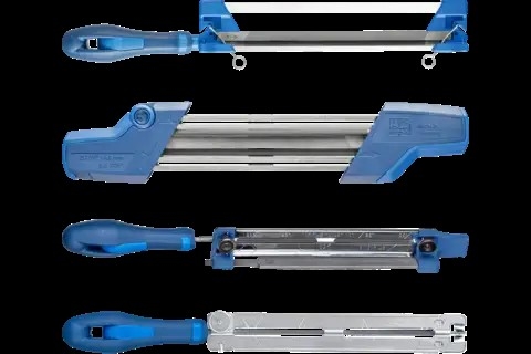

IMHO either the 2 in 1 if you cant get hand of just use a file guide with file and raker file. Pferd blue makes the ones for stihl too.
Agreed. I recommend one of these two (2-in-1 or Pferd) to every acquaintence who's learning to sharpen. Hard to beat.

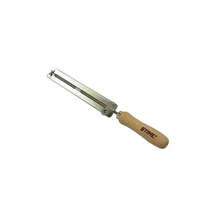

Use the Pferd 2 in 1 on all my small saws, use the Stihl file guide on the .325 and 3/8 saws. The Stihl does acceptable but not as well as the 2 in 1 Pferd

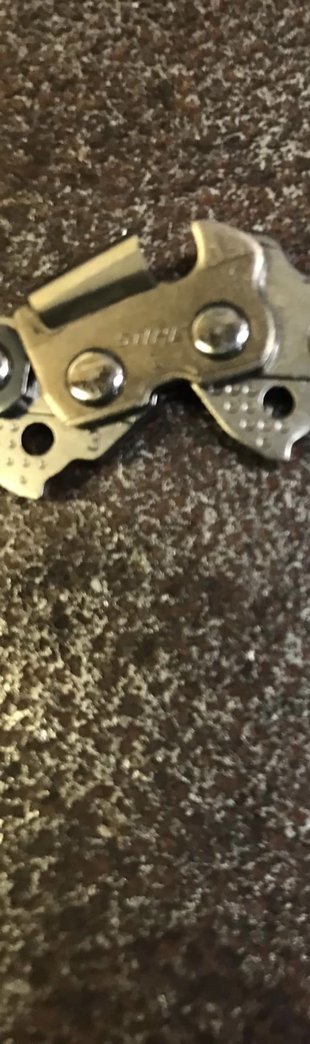

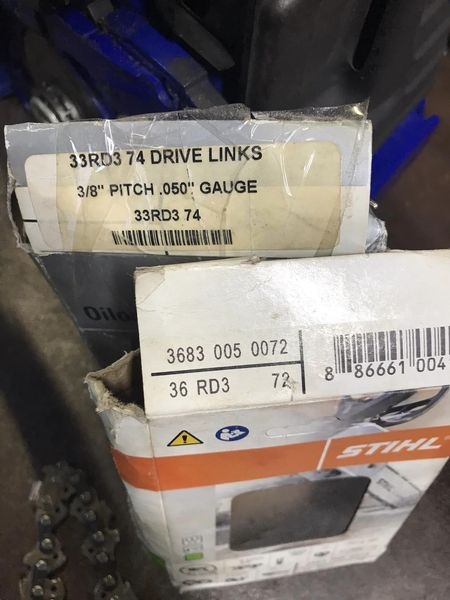

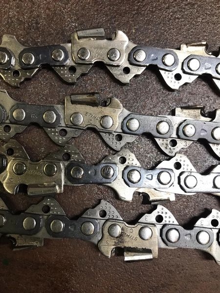

IMHO the cheap carbide chains aint worth it. They fling the lee press on nails right off. 🤦‍♂️
That is one place where I will say. Stihl carbide worth the money.
IMHO unless cutting roots or very dirty sandy burnt up stuff. Still not worth it.

Try to file carbide with diamond file or bit on dremel is joke at best.
My stihl carbide chains I get out once maybe in a year if unlucky.
I also use a diamond wheel for carbide chains.

Here is what a cheap carbide chain looks like with lee press on nails. IMO not worth it.

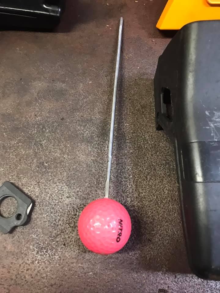

I posted this some time back. It might help you some.
Get the right size file for your chain and drill a small hole in a golf ball - one that the sharp end of the file will stick into. Tap the the ball onto the end of the file and you got an instant handle that will work perfectly. Don't drill the hole too big. Clamp the bar tightly in a bench vise (make sure the vice doesn't keep the chain from rolling) Using the kickback for a brake file each tooth and then take the brake off and advance the chain to file the next section of chain. Make sure the chain is fairly tight on the bar and file each tooth using a motion that pushes and turns at the same time. DON'T use a sawing - back and forth motion- doesn't work very good that way. Try to maintain the angle that is already there and get in the habit of doing this often so that the chain doesn't get too mangled up. When you're done with that side take the saw out of the vice and do the other side. After some practice you'll be surprise how quick it is to touch up a chain. Remember too that the guys that use a machine are taking off more steel than you would using a file. Filing the chains gives more use since your not grinding off more than you need to.
This is how I do it. I like to mark the first tooth I file with a felt tip pen so I can easily see when I'm done. I also like to lightly drag a finger tip 90 degrees to each tooth to judge sharpness. If my finger slides easily with no friction, I give it another pass with the file.
Another thing, the teeth don't have to all be the same size, and some may require more passes with the file to get sharp than others.
Finally, I like to give the end of the file a tap and also brush down the length of it in between each tooth to get rid of any loose steel chips that accumulate in cutting face.
