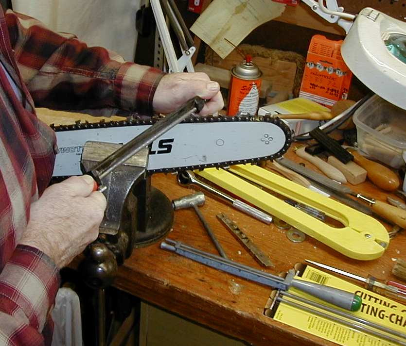

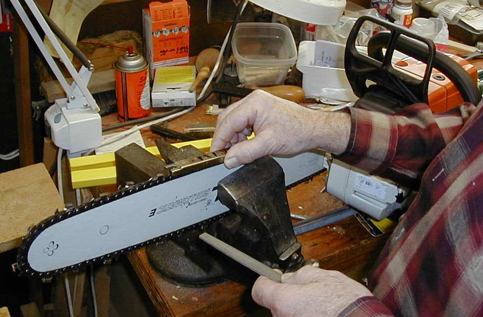

When I referred to grinding wheels I had in mind the "bench type" that PineRidge uses, but I'd include the Dremel type as well. I have to believe that they are going to heat up the chain a lot more than hand filing.
I had an Oregon 511 at one point in my "career", and ended up selling it for what I paid for it. I bought it from another tree guy who got it as a gift from a well-meaning admirer, but he shared my opinion that hand filing is the way to go.
I was just thinking about this thread yesterday as I put razor-sharp edges on my [Stihl] 191T [climbing saw] and [Stihl] 066 ["The Big Dog"] in about 5 minutes total. The 066 needed about 5 strokes per cutter (it was quite dull), and maybe 4 for the 191. Shortly thereafter, the 191 pieced out a 120-year-old, 44" diameter white oak, and the 66 felled the trunk like nobody's business. Man that saw cuts.
Call me old-fashioned ("You're old-fashioned"!!), but to me, nothing, but nothing cuts like a chain that has been sharpened by hand, with a nice fresh file, using the two VERY simple tools I have described. Plus, you don't have to remove the chain from the saw - a HUGE advantage over a bench grinder. A few strokes with a good file, and you're back in full "samurai" mode. Can't beat it. Pure zen. What more can I say.
I have tried, and own, or have owned, every chain saw sharpening system that there is, or that that has been described in this thread, and in any other thread I have ever read on TBN, or anywhere else. I have used my current method exclusively for the last 6-7 years, and can't see myself ever using any other method ever again.
To paraphrase one of my more frequent statements - "I don't say that this method is the best because it's the one I use ... it's the other way around."

When it comes to deciding how "best" to sharpen a chain, there are indeed many factors to take into account. For me, some of the main factors are: quality of the result, expense, convenience, and ease. "Hand" (well, jig-assisted) filing wins on all counts, hands down. Razor-sharp results, economical (restore an edge in 4-5 minutes, versus paying someone to grind it, or finding an outlet for your Dremel), take the rakers down to not only the correct height but also a good sloped angle (that's where the EM raker gauge shines), the ability to sharpen your saw any time, any place, better than it can be done anywhere else, without taking the chain off. I dunno, it works for me. Not saying it has to work for anyone else, but I'll put one of my chains up against any other (except square ground), and none will cut better. Maybe just as well (although probably not), but certainly not better.
And one hardened tooth on a chain is, in my opinion, one too many.

I learned how to file one day many years ago. I always carried 2 chains and 3 files. Within an hour I had both chains dull. I figured if I totalled ruined one chain learning how to sharpen it it would be worth the effort. I learn a lot that day. Now I take 1 saw and 2 files. After 3 or 4 had sharpenings I take it to the shop and clamp it in the vise. I have a clamp on the bar hand filer. It will do each cutter exactly the same angle & depth and also the do the raker. BTW no one makes a clamp-on-the bar filer like the one I have anymore.
