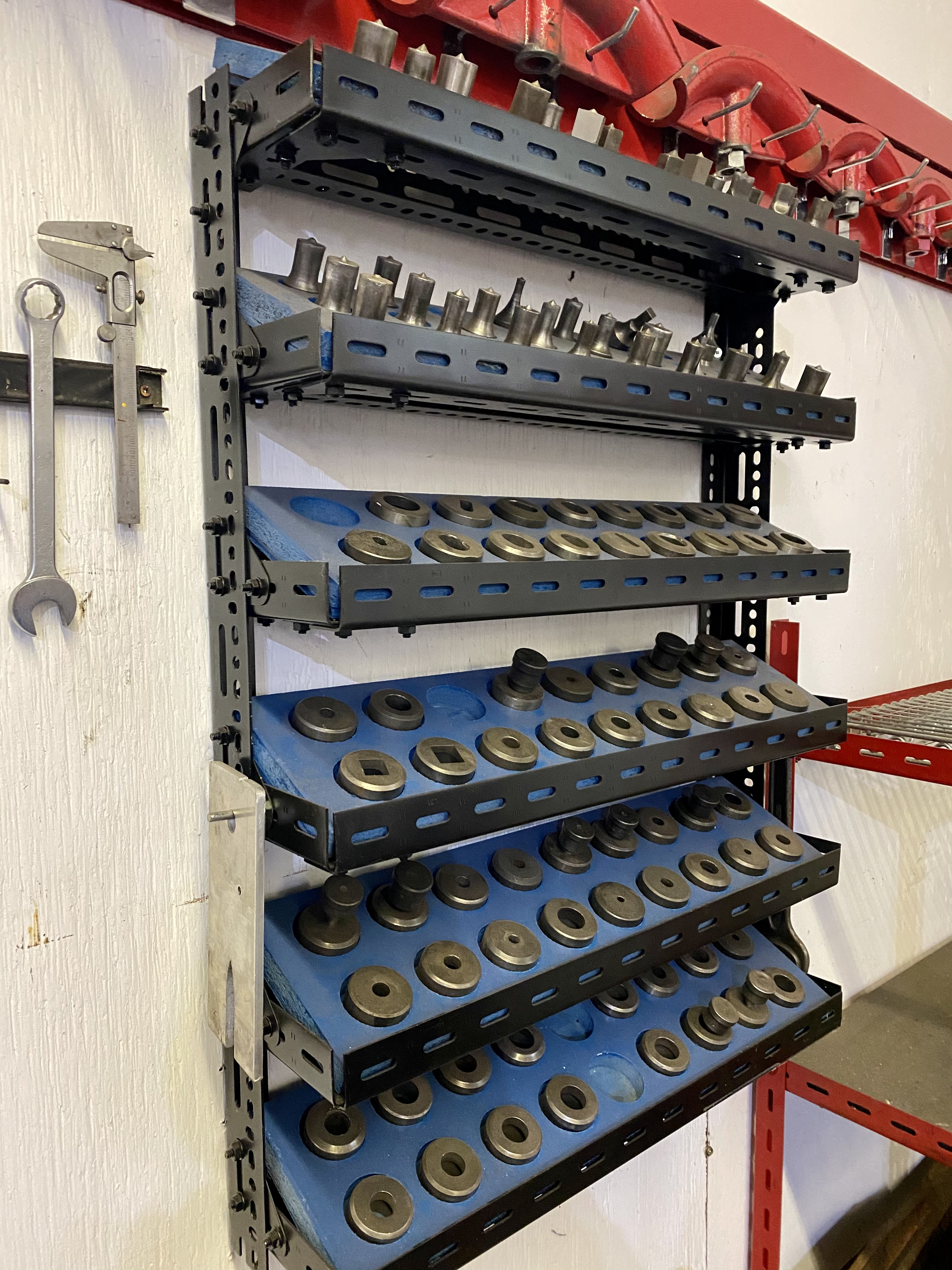

Using Handi Angle shelving drops
for brackets and tool hangers

Terry, If those are punches and dies in the blue rack there doesn't seem to be a sharp punch among 'em. :eek:

They are being saved up for the day I find a surface grinder Jon.
Either that or design a jig to hold a spin index for my belt grinder.

Cover the bed-ways and chuck 'em up in the lathe. Use muffler clamps to attach an angle grinder to the tool-post if you lack a TP grinder.
Turn lathe and wheel spindles in the same direction so where the wheel contacts the punch they're moving in opposition.
The op is called a spin grind and is easier than most folks think to set up. Punch points aren't critical and can be dressed as needed with file strokes and switching the lathe spindle back to it's normal rotation. (toward us)
Surface grinder will clean up the dies

Thanks OG! That is what I will do!

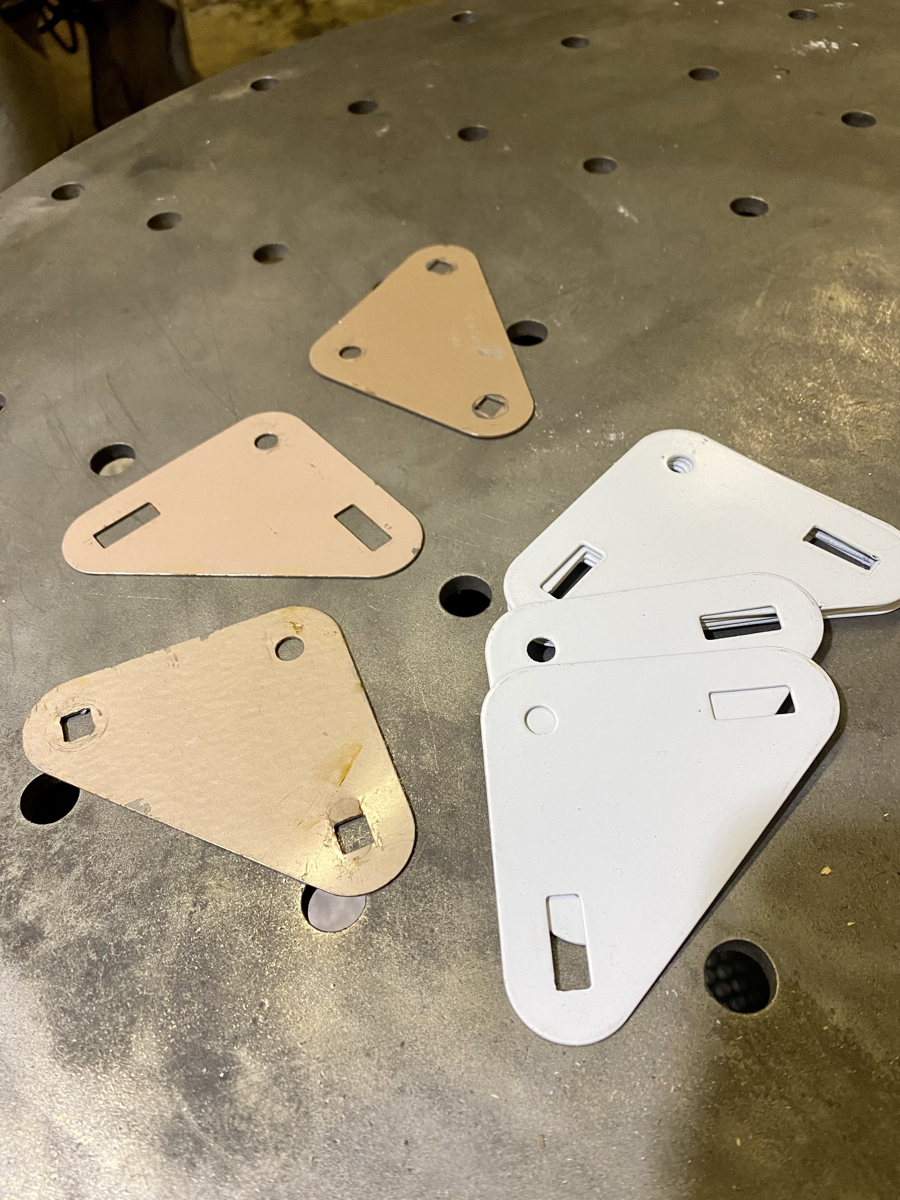

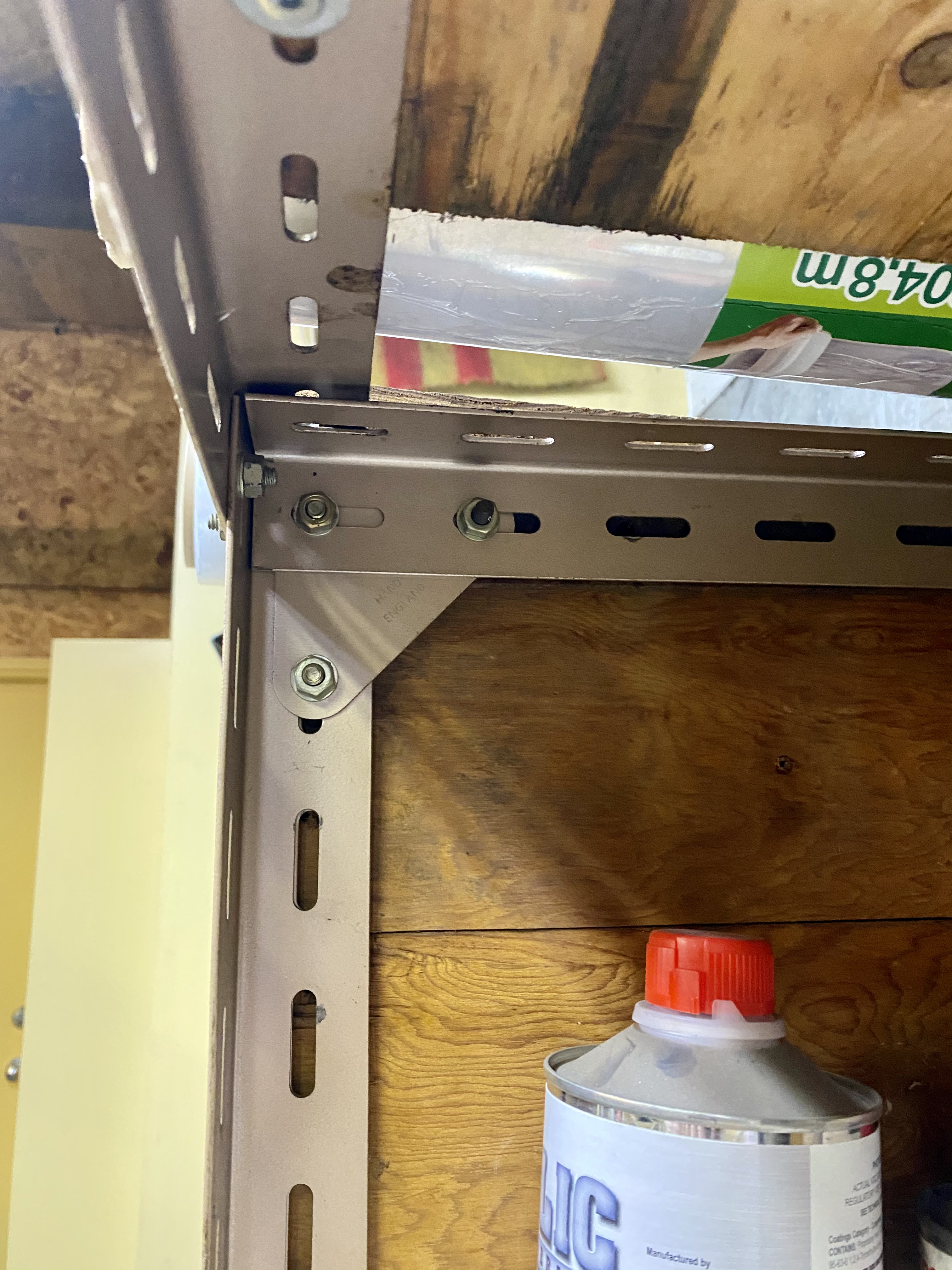

Thanks JK. I assume you are referring to these triangular corner braces. They are OEM parts.
