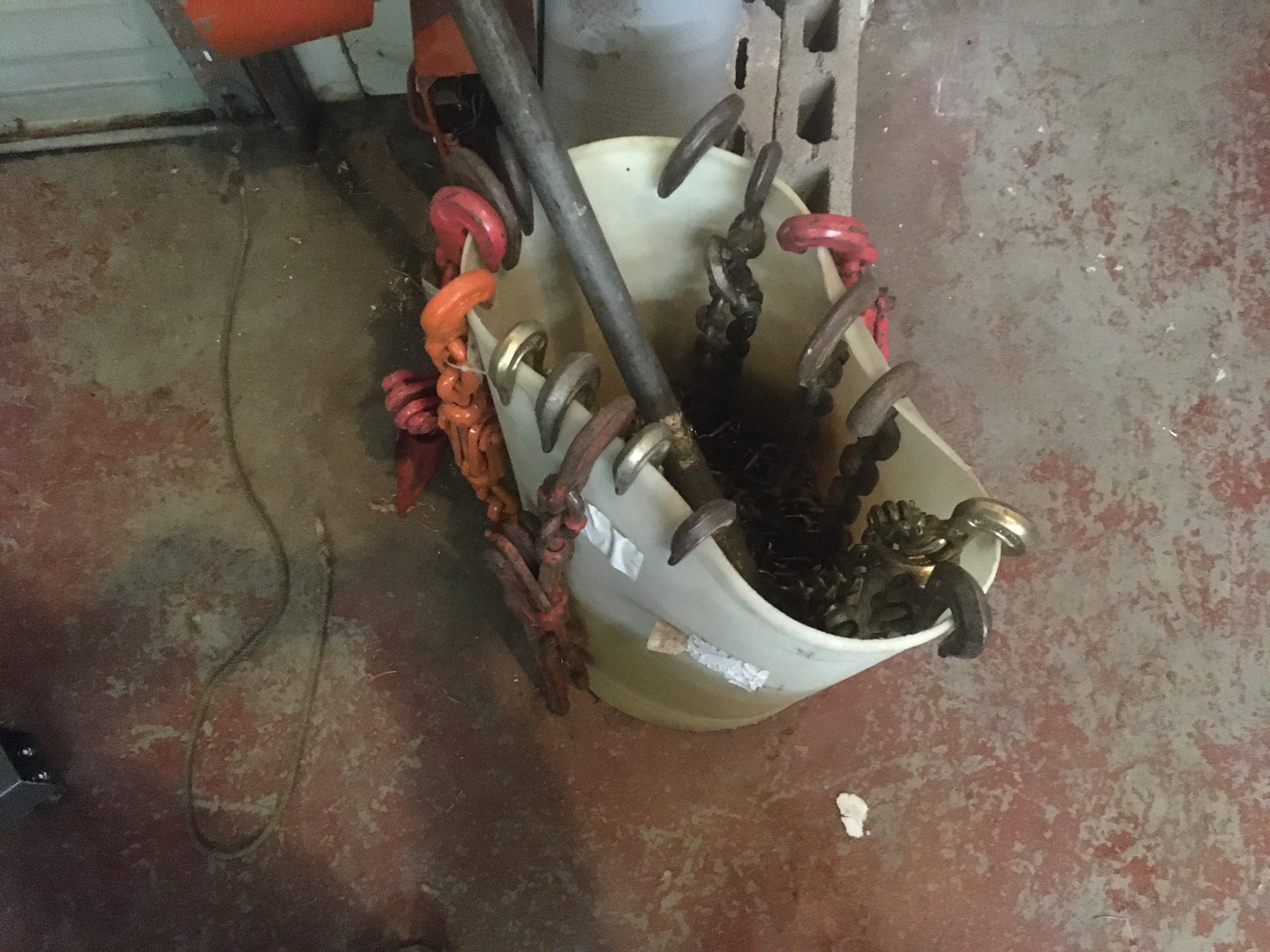

In my shop wall space is scarce so my chains are kept in a plastic 15 gallon container with the top cut off. Chains inside the container, binders on the outside. Makes them easy to keep track of.

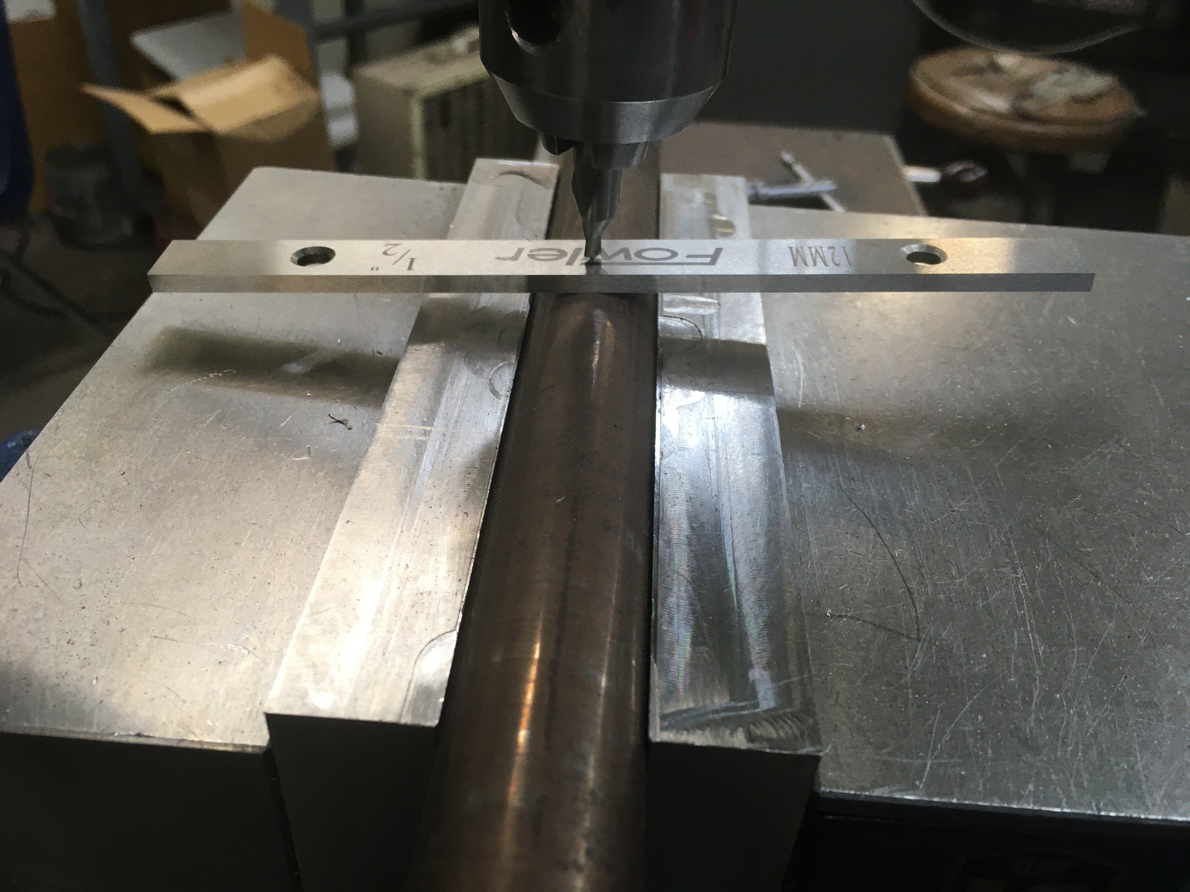

Most probably know this already but if you are needing to find the center of round stock to drill a hole, the quickest way I have found is to use a ruler or something straight on top of the round stock, then place the drill bit on top of the ruler. As the material is moved back and forth, the ruler will rock from side to side accordingly. Once the ruler is straight you are in the center of the material, or at least close enough for most purposes. The same can be done on a lathe to get the cutting bit in center.
View attachment 682151 View attachment 682152 View attachment 682154
I've done that trick on a mini lathe, but never thought to use it on a drill press. THANKS!
HaHa!
That is exactly how I store my tire chains off season.
Bonus is that they are never tangled either.
The bucket sits outside with a plastic domed hood to shed water.

That is the nice part of storing them that way, they don't get tangled so they are easy to pull out. And it is easy to see which chain I want.
/ Smart Shop tips! #308
I don't know where to find 15 gal. plastic containers.
I'm not sure how to help you on that. I get them at work so they are free. I have two, one for chains, the other for diesel fuel.
I suppose the 15 gallon steel containers would work just as good but you may have to smash down the folded lip at the top if it is too thick for the hooks.
/ Smart Shop tips! #309
Big heavy duty trash can or steel barrel should work. Chains I spray different bright colors every few feet so I can find them!

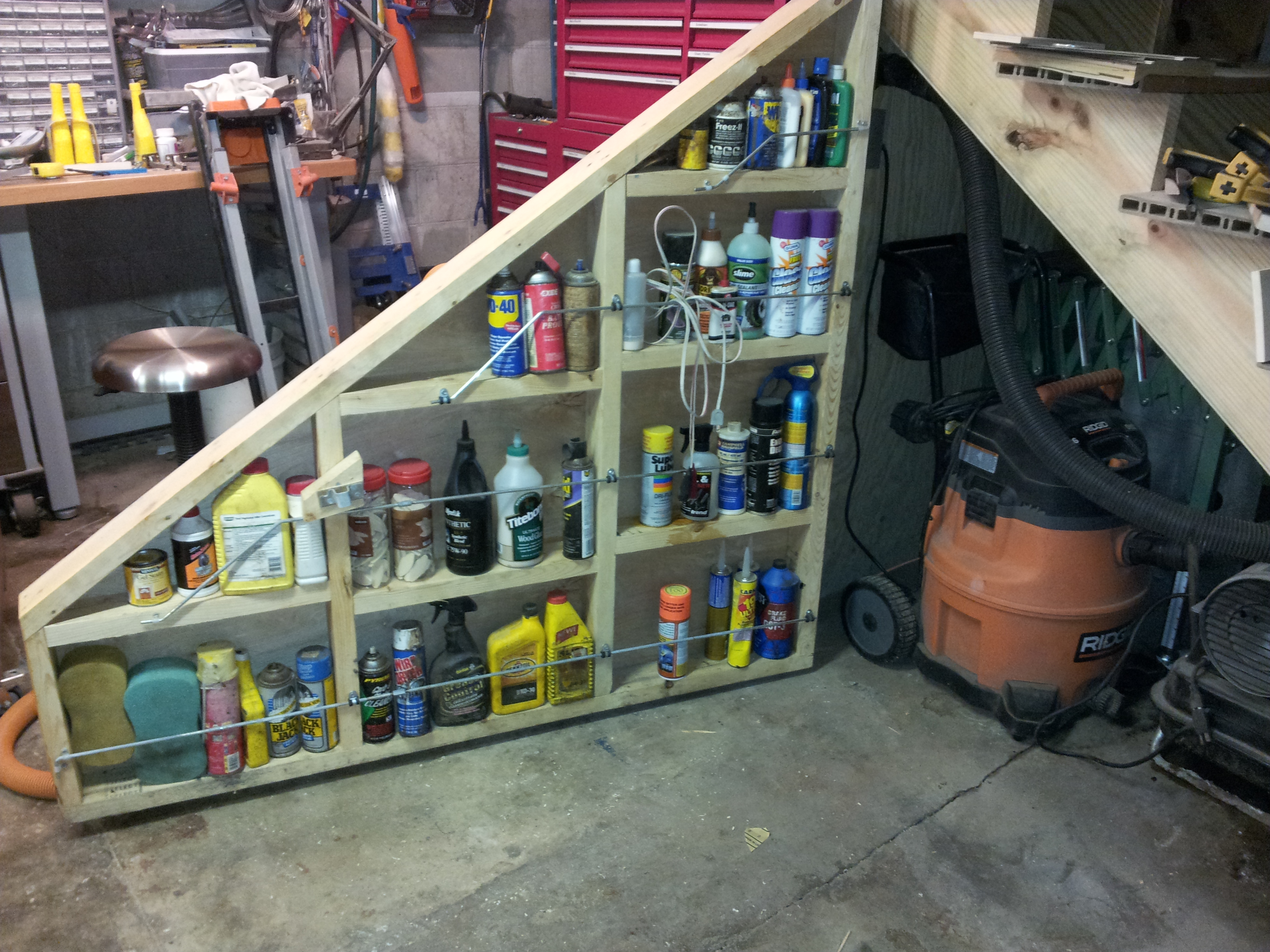

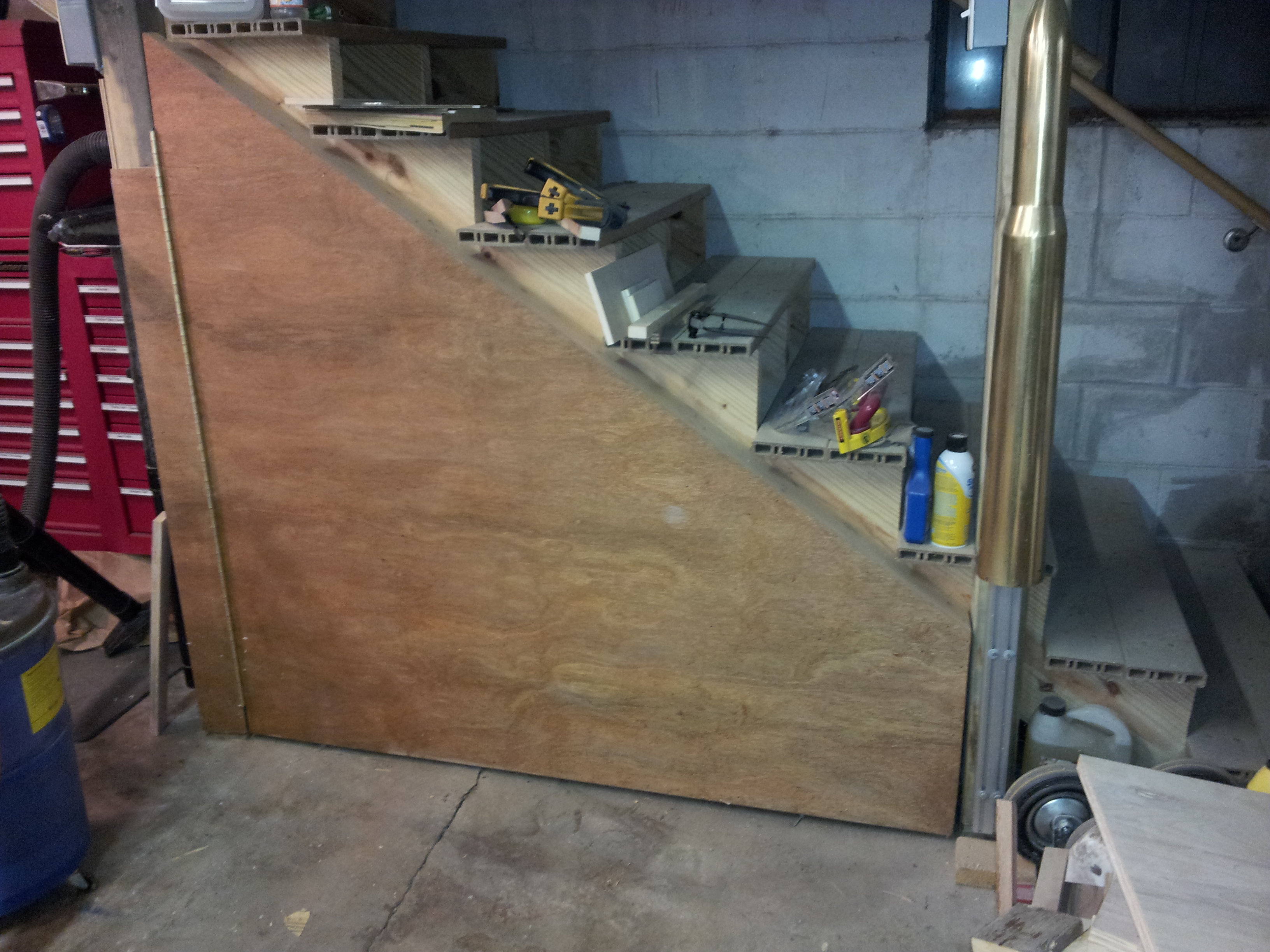

Homemade heavy duty hinge A.K.A. Mother of Piano Hinges
Bought 1/4" spring steel piano wire from hobby shop, 12 hinges from Menards. Removed hinge pins, ran 1/4" drill thru hinge parts, reassembled on 4' piano wires.
View attachment 682025 View attachment 682026
96 wood screws later, have large under stairs door for chemical storage. No problems in 16 years.
This is real smart!
