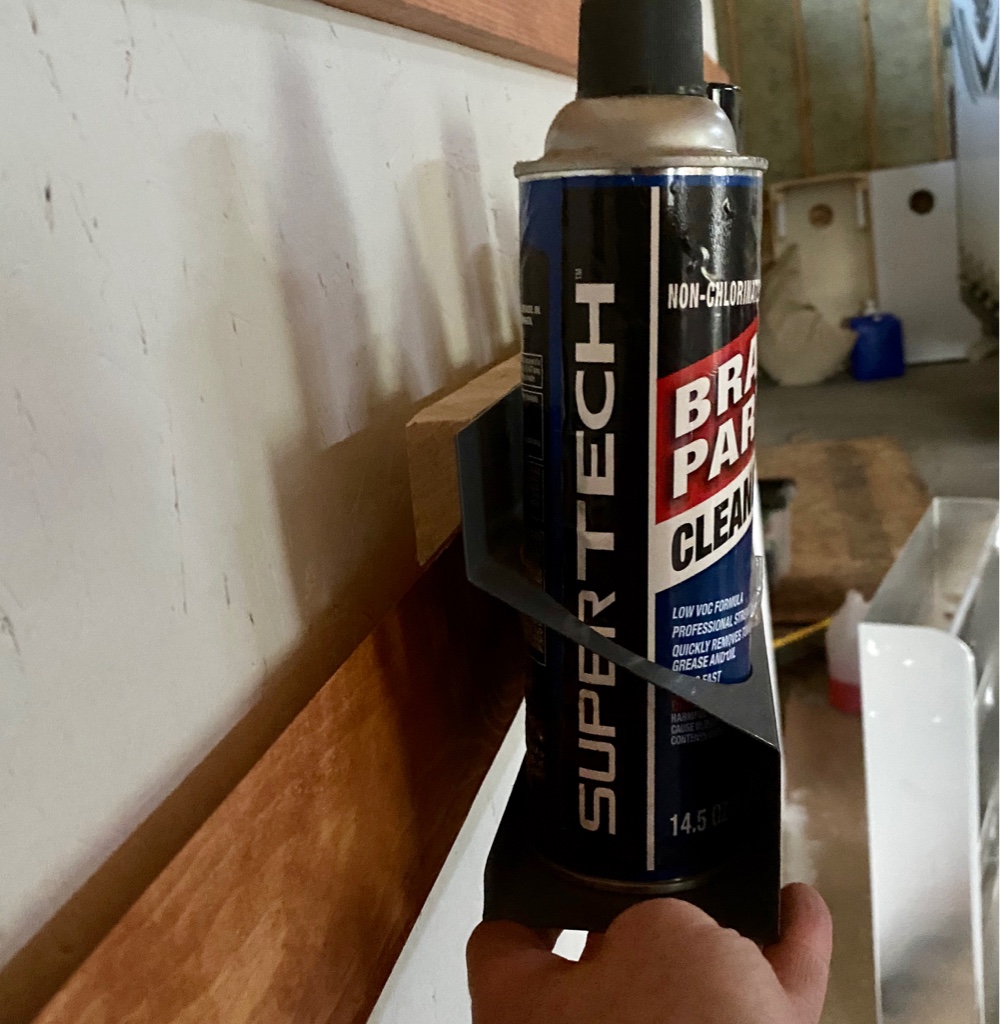

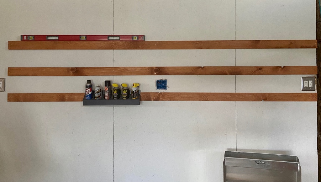

Custom hooks for those of you who use slatwall..

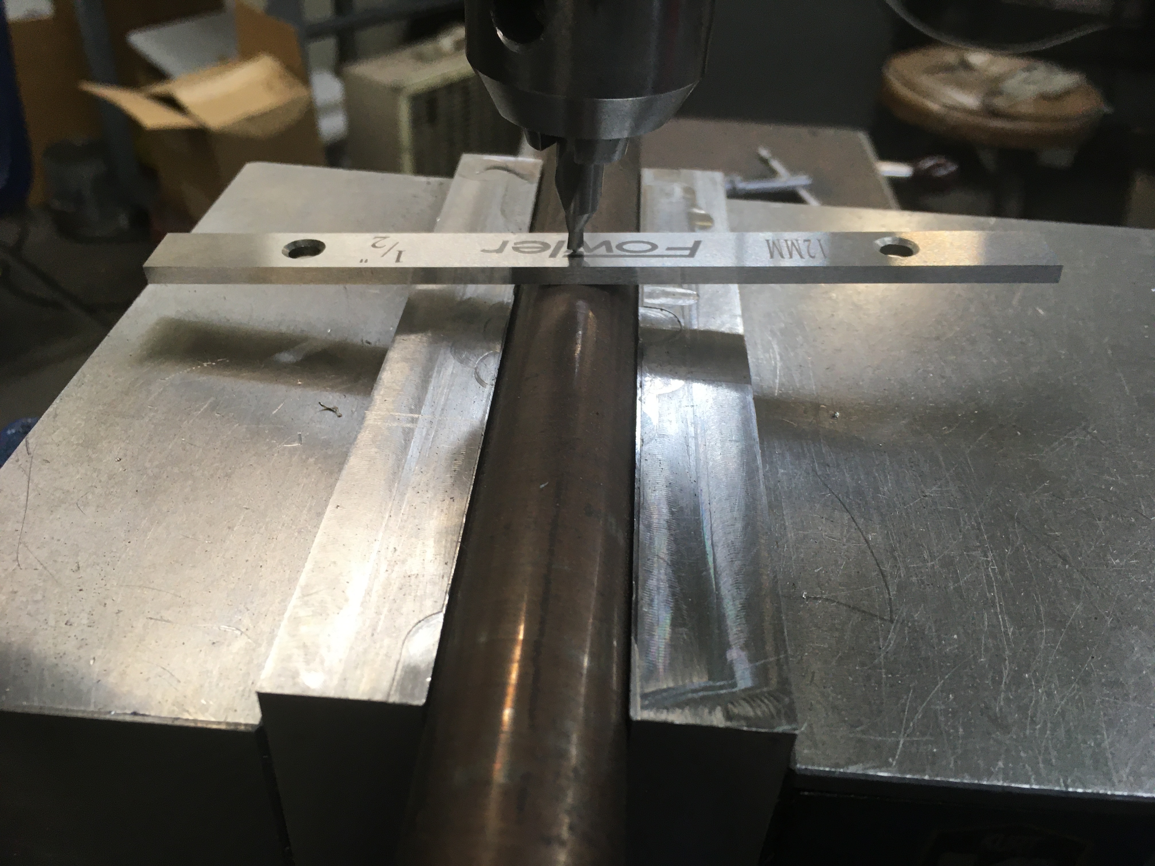

Most probably know this already but if you are needing to find the center of round stock to drill a hole, the quickest way I have found is to use a ruler or something straight on top of the round stock, then place the drill bit on top of the ruler. As the material is moved back and forth, the ruler will rock from side to side accordingly. Once the ruler is straight you are in the center of the material, or at least close enough for most purposes. The same can be done on a lathe to get the cutting bit in center.
