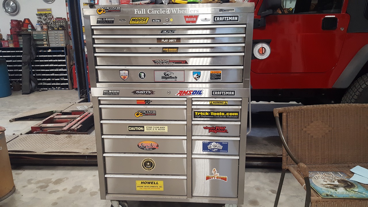

My Son is a mechanic. When I bought a new toolbox he gave me a pointer on how to organize it. Load the box as you think will suit you. When you start using it pay attention to the mistakes you make opening the wrong drawer. An example. If you open the third drawer down when looking for a pair of pliers twice, move the pliers there. I used that method. My box makes perfect sense to me and I never pull the wrong drawer. Being a sticker guy, I put stickers on each drawer front. When "guiding" someone to the correct drawer I mention the sticker. :)
Where do you get the stickers? I see them on tool boxes all the time but don't remember being given any. Maybe I toss them without thinking about it.

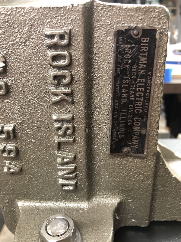

Okay... for those of you that do restorations, Big Barn are you listening? :D Don't start with Acetone (like I tend to do).
Take your time and start with less aggressive solvents and work your way up if you are worried about losing some identification. I am really impatient but it has cost me on metal labels, etc. where I wiped clean the info. Here is an example where I got lucky... if you see a tag riveted on... that is a clue.

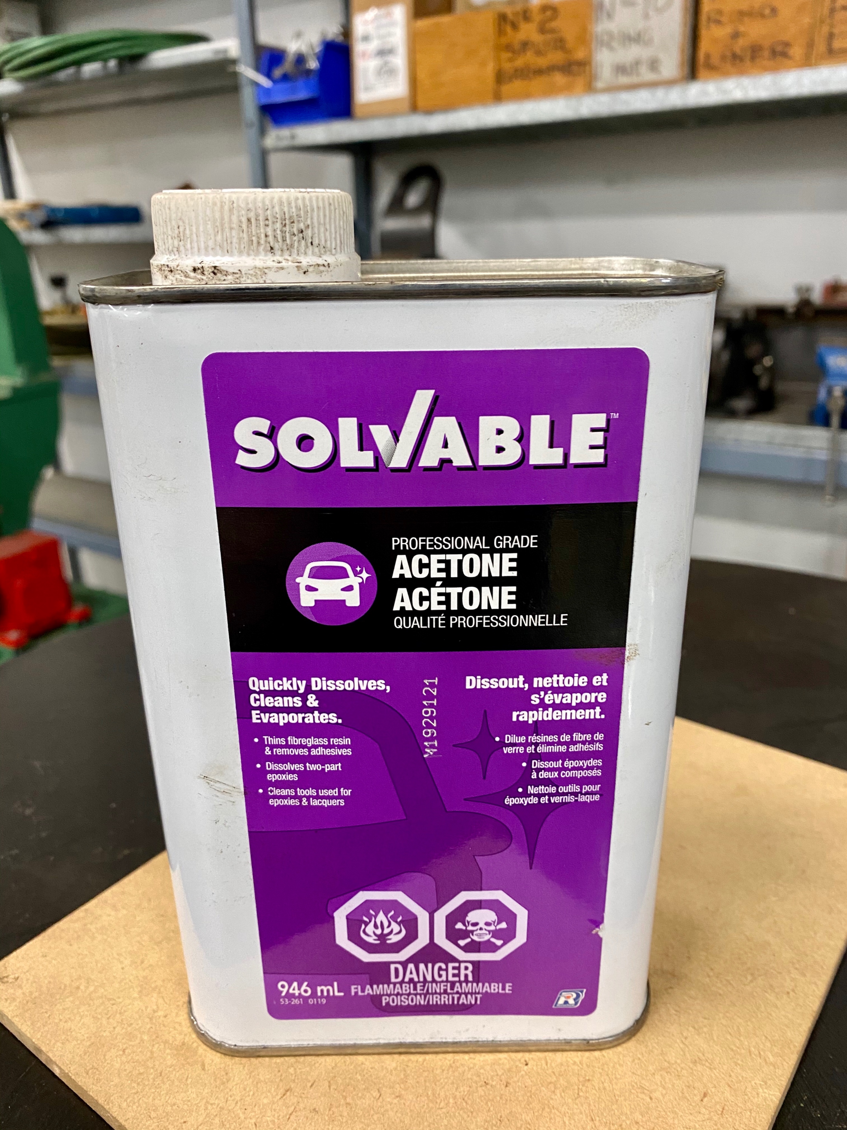

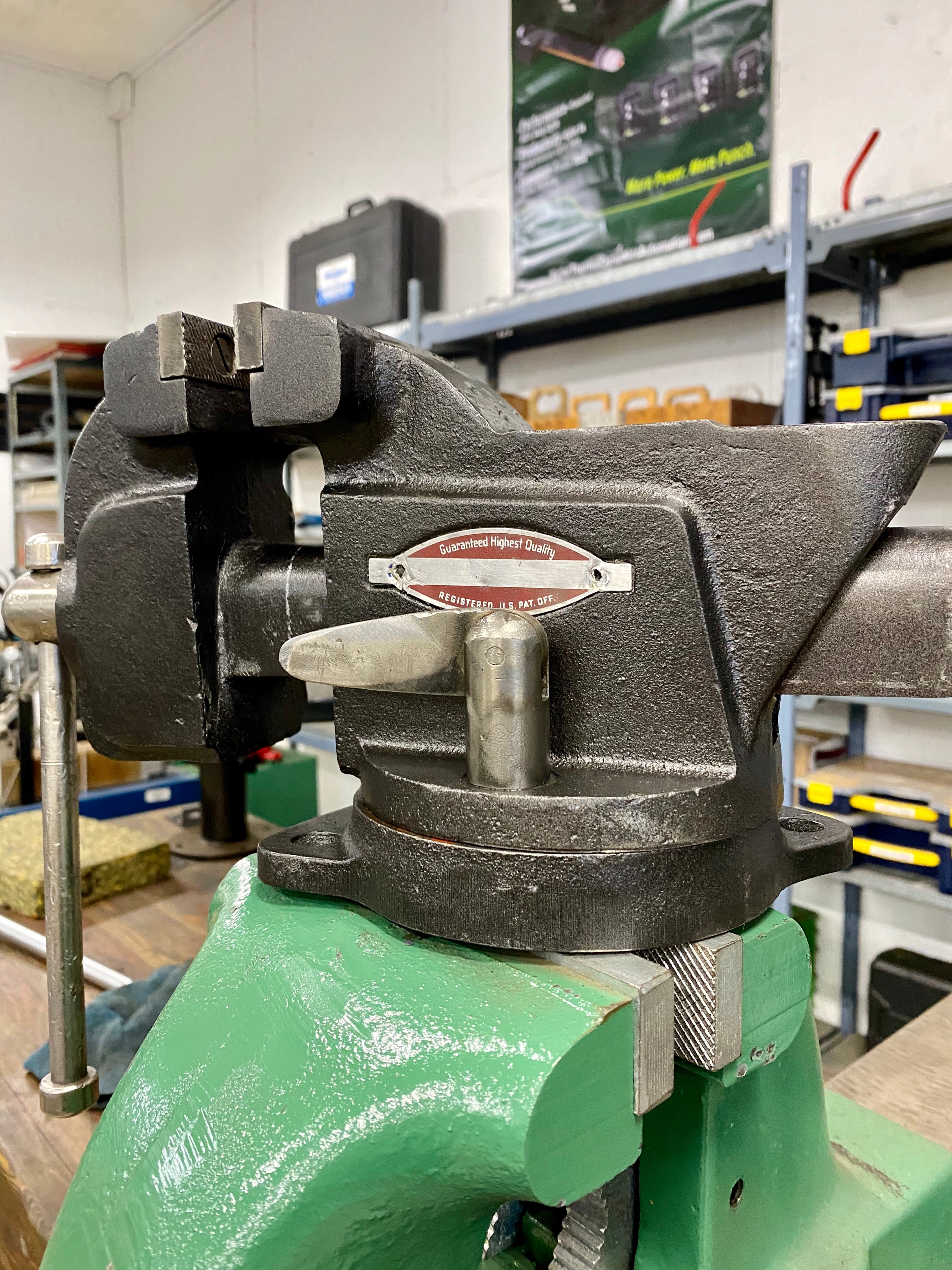

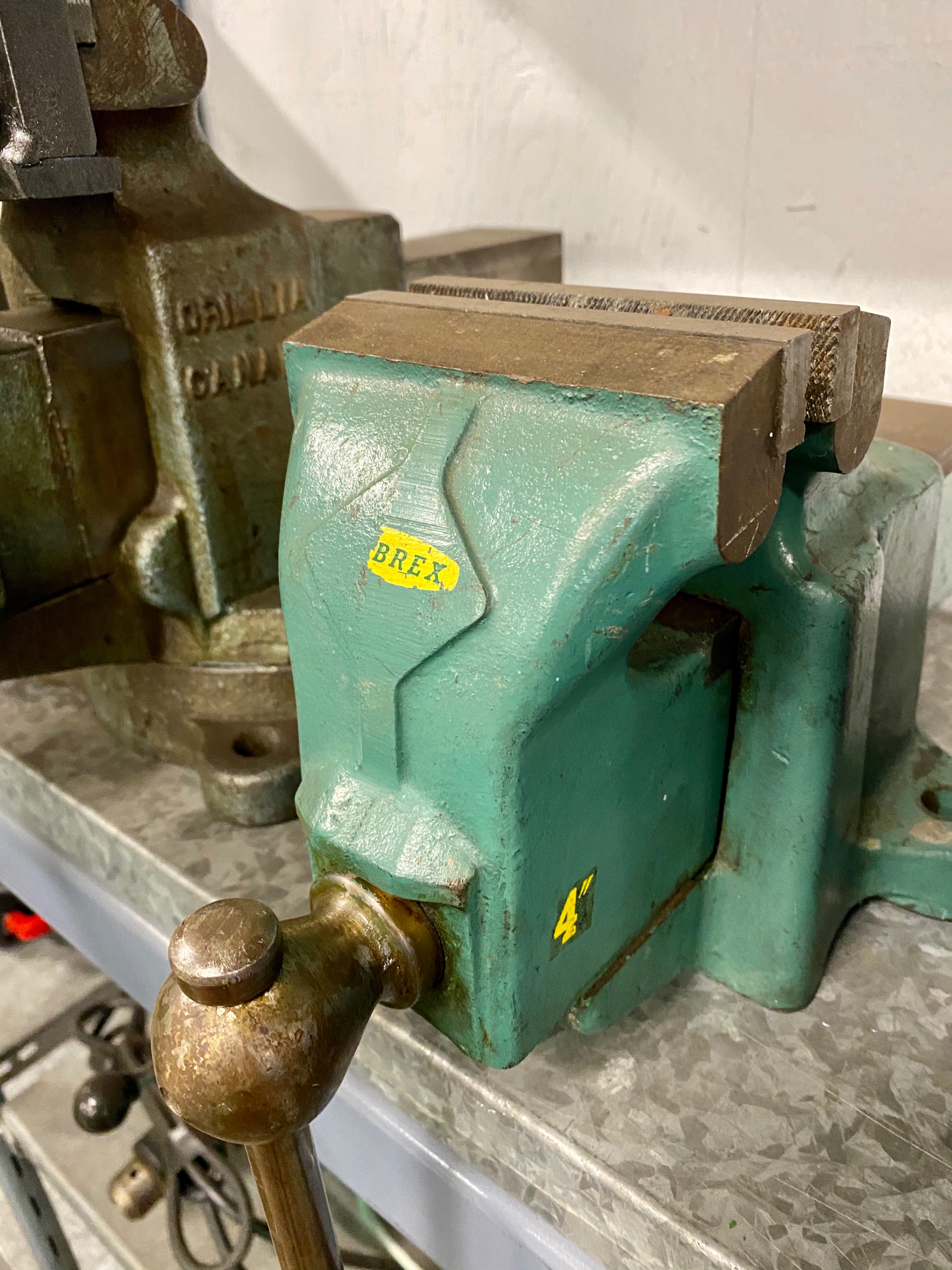

and end up with this...
and this. It should say CRAFTSMAN in the center.

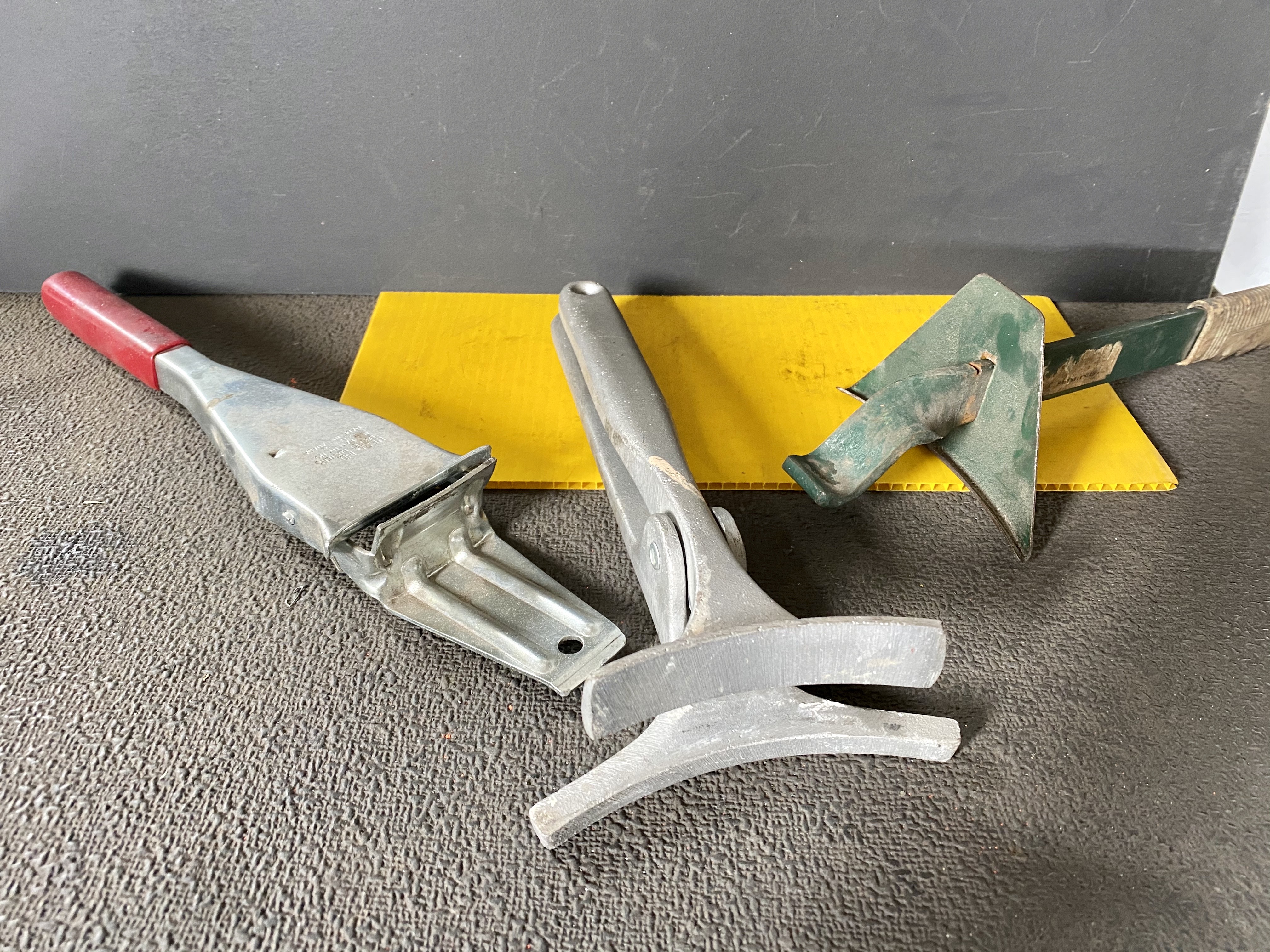

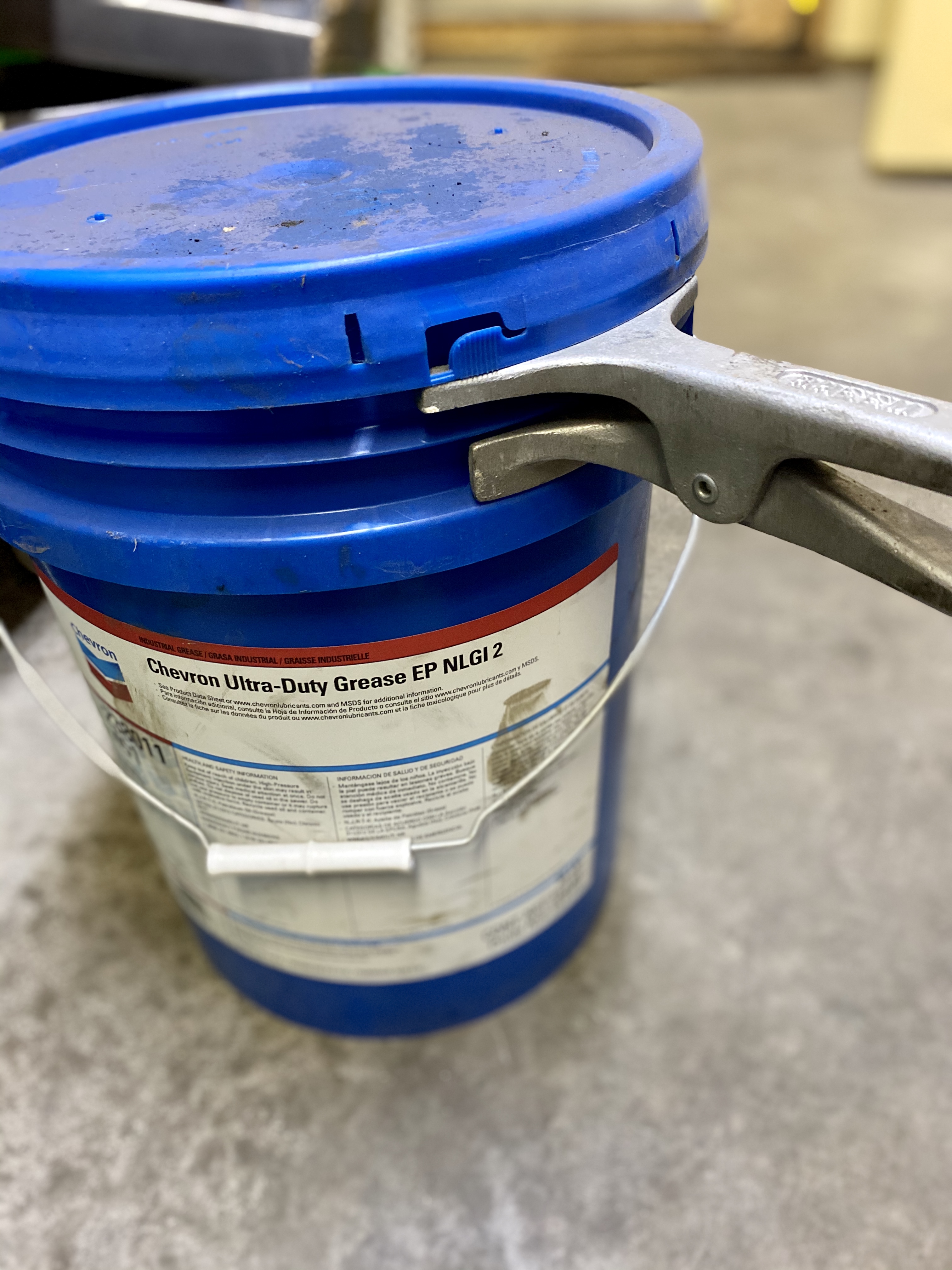

What a novel idea! I hate to admit in being so ignorant about there even being such a thing as a 'lid lifter', but I will. Just this week I fought a plastic can with a lid for about a half hour. Finally got out my sabre saw and cut the dang thing off. Silly me. I'll be buying one of those - as soon as I find them for sale. Thanks for the tip.

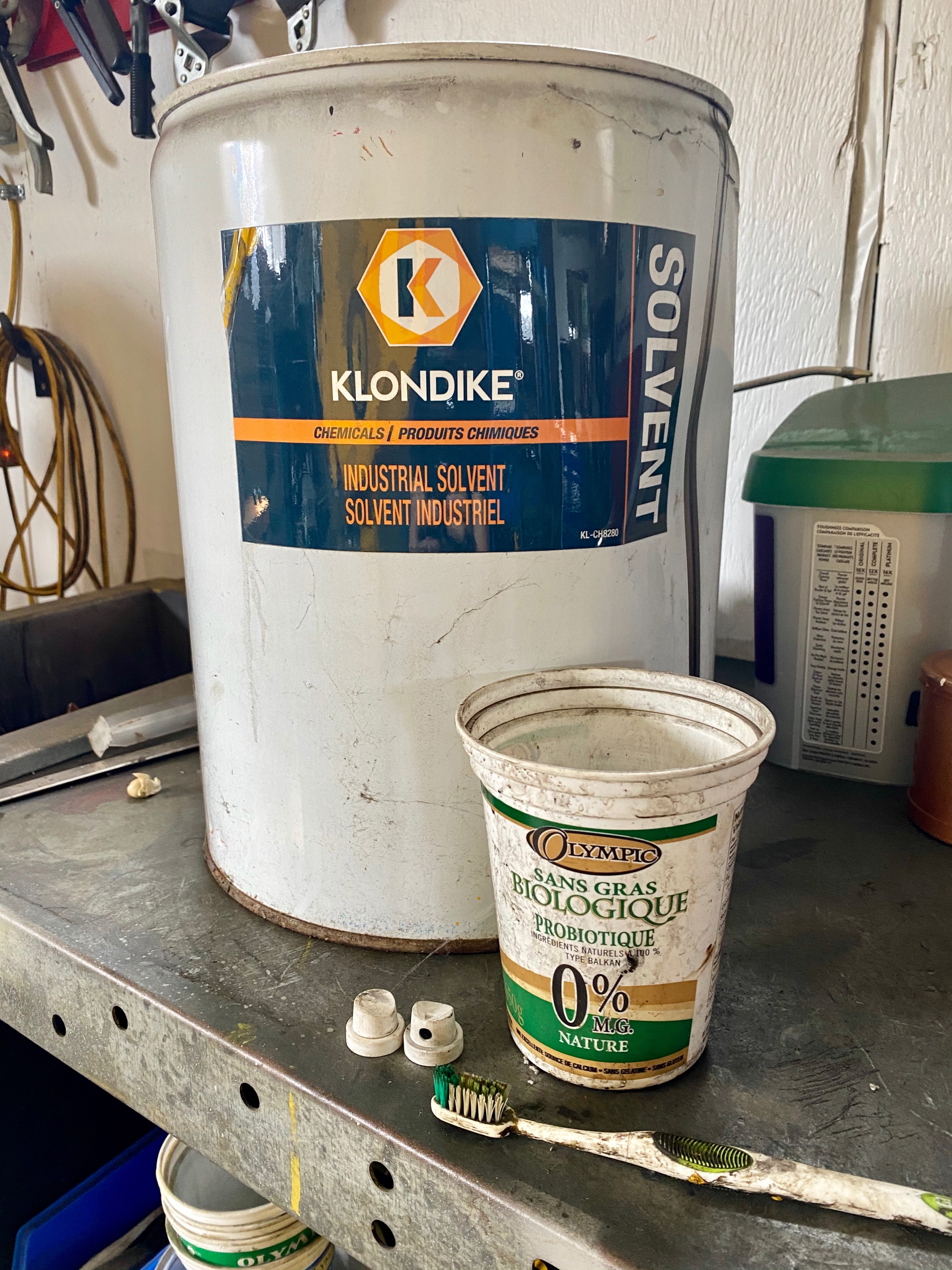

For all position rattle cans I clean and soak the nozzles in solvent.

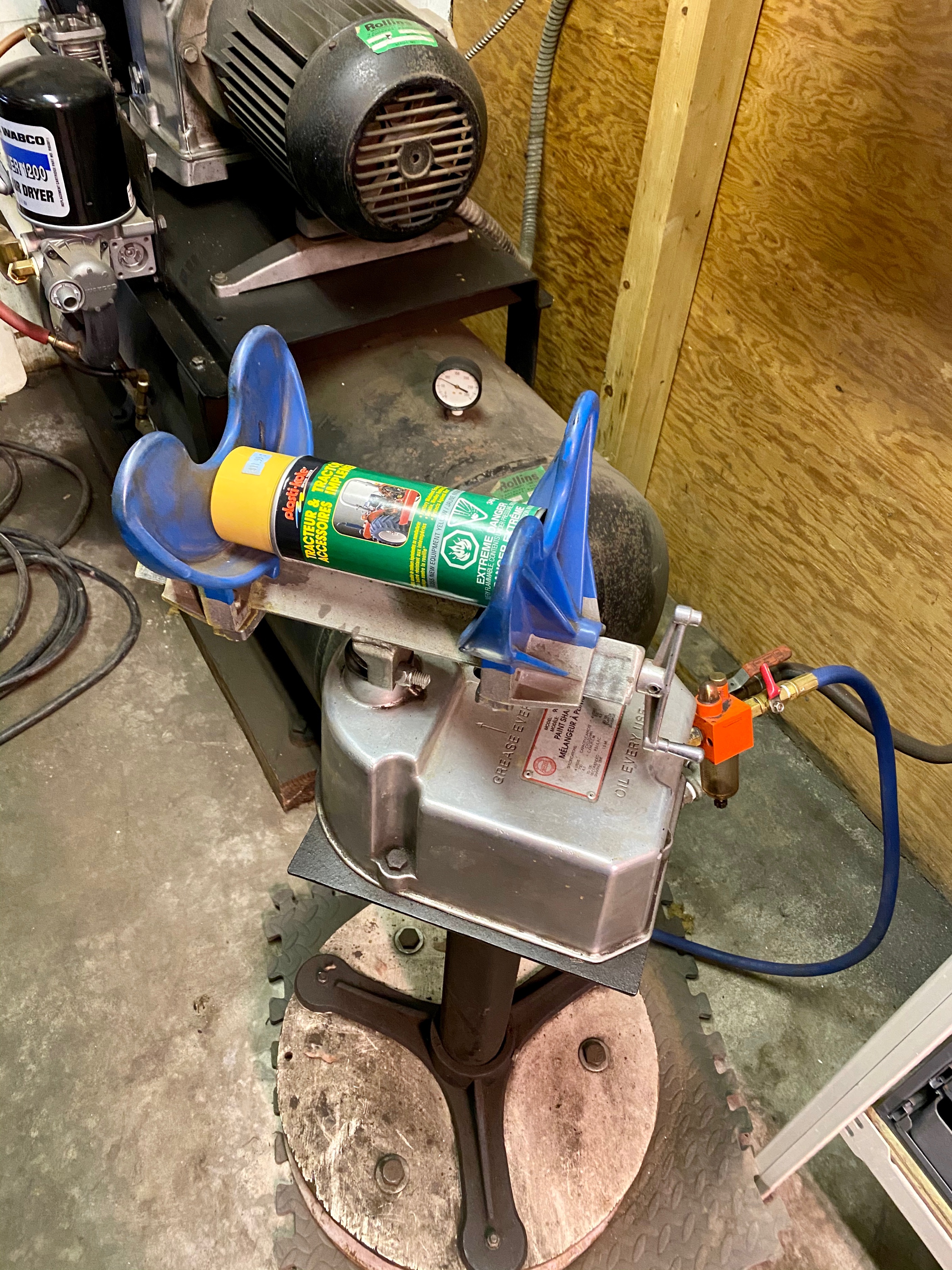

Rattle can shaker.
/ Smart Shop tips! #79
Shaking up a spray can is one of the hardest things for me to do. Arthritic wrist. I need/want a can shaker like BB's.
