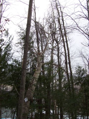

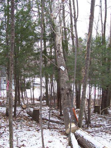

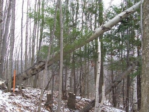

Seriously, kinda, if any one wants to "test drive" /forums/images/graemlins/smirk.gif any nice heavy snatch blocks, I've got plenty of poplar/aspen on a steep bank, up behind the house. Even one that's already off the stump and hung up in the crowns /forums/images/graemlins/shocked.gif. Been there since November and I'm not thrilled at my options for getting it down. I know, they're pretty light as trees go but 18" diam. and 60' (?) tall, on a hillside that I can't get to with a road yet. They're not much good for anything but kindling but they've been snapping like twigs with the winds this winter and I want to clear for a road and let the ash, hard maple, and some red maple get some daylight up there. Was hoping that one would come down by itself some windy night...no such luck.

Yes, I use a come-a-long (with the snatch block). Normally, I don't have to put a lot of tension on the lines, block, or come-a-long...just enough to persuade the fall direction. This tree is so hung up, and butt end wedged into the steep bank that I'm still ciphering on the best direction to pull and where on the tree to pull to prevent further wedging of the butt and/or hangup of the top.
Am at work now but, now my puter is back up at home, I'll try to get a pic and post it.

Yup, don't think it would be an advisable time to brave either the tourists or the cold. Appreciate the thought though. Not even sure where you'ld set the L4630 to reach a snatch point to pull on that tree. I think it would take well in excess of 100' of cable (maybe twice that), to get the right position and angle. As said above, I'll take a pic, or two, if I get a chance and then everyone can get a good laugh at the predicament. Main problem is probably just not heavy enough equipment to yank what and where I need to.

Pic's...any suggestions? If not, hope you at least get a good grin out of the predicament /forums/images/graemlins/smirk.gif.
(O.K., maybe what's left, after having trimmed off the 1st 10' is only about 1' diam.... /forums/images/graemlins/tongue.gif but the pic's definitely make the terraine look flatter than it is.)
Tom
   / Snatch blocks #49
2nd Pic.

   / Snatch blocks #50
Last one
