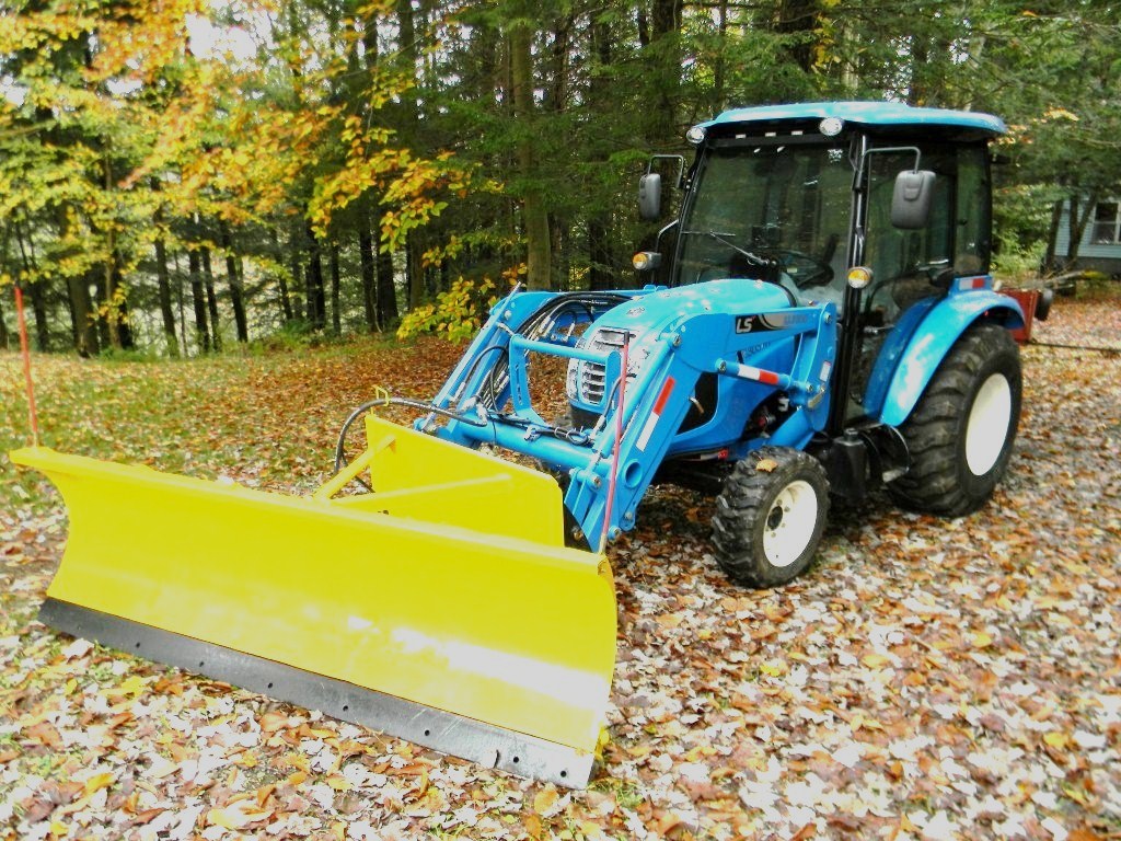

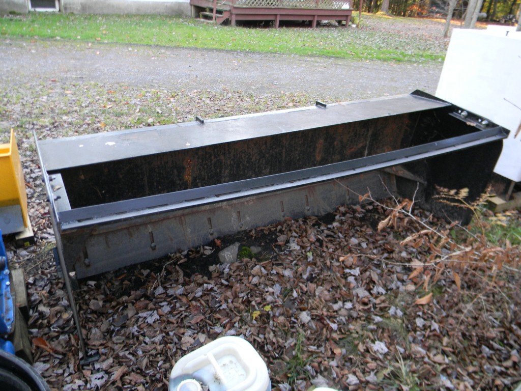

I have a 7'6" pusher and a 7'6" power angle plow. In my area of Upstate loaded tires, chains and rear ballast are a must have for deeper snowfalls. For lighter snows I don't put the rear ballast on. My pusher has an adjustable height steel cutting edge. I have it set up a half inch so it doesn't dig into the gravel drive. Same with my plow. The shoes are set so the cutting edge is also up 1/2". I also made and installed an adjustable back drag blade on the pusher shown in the third pic.
If you don't have weight, chains, and ballast a snow pusher blade will stop your tractor when it fills up and you have no traction.

You are correct that pusher blades don't have trip springs but neither does your 72" bucket. I plowed with a loader bucket for many years. I recently made my power angle plow from an old truck blade mounted to a SSQA plate. If you do build a PA plow install a crossover relief (Black device in center of QA plate) so if you do hit something with the blade angled the relief will let the blade turn.

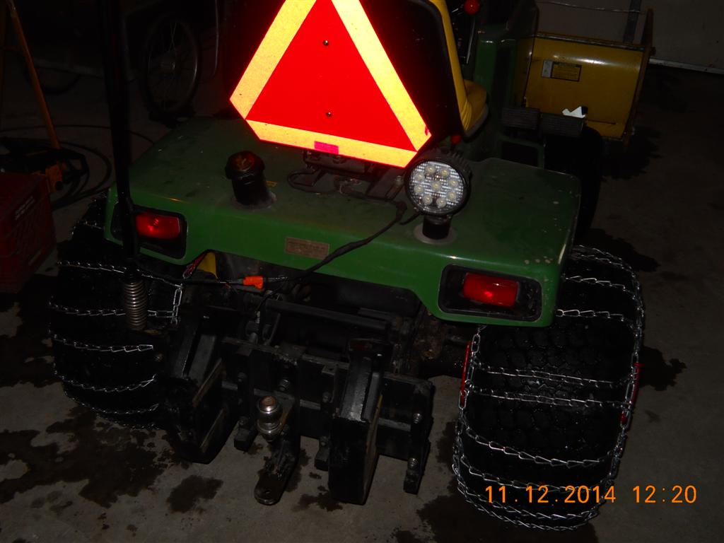

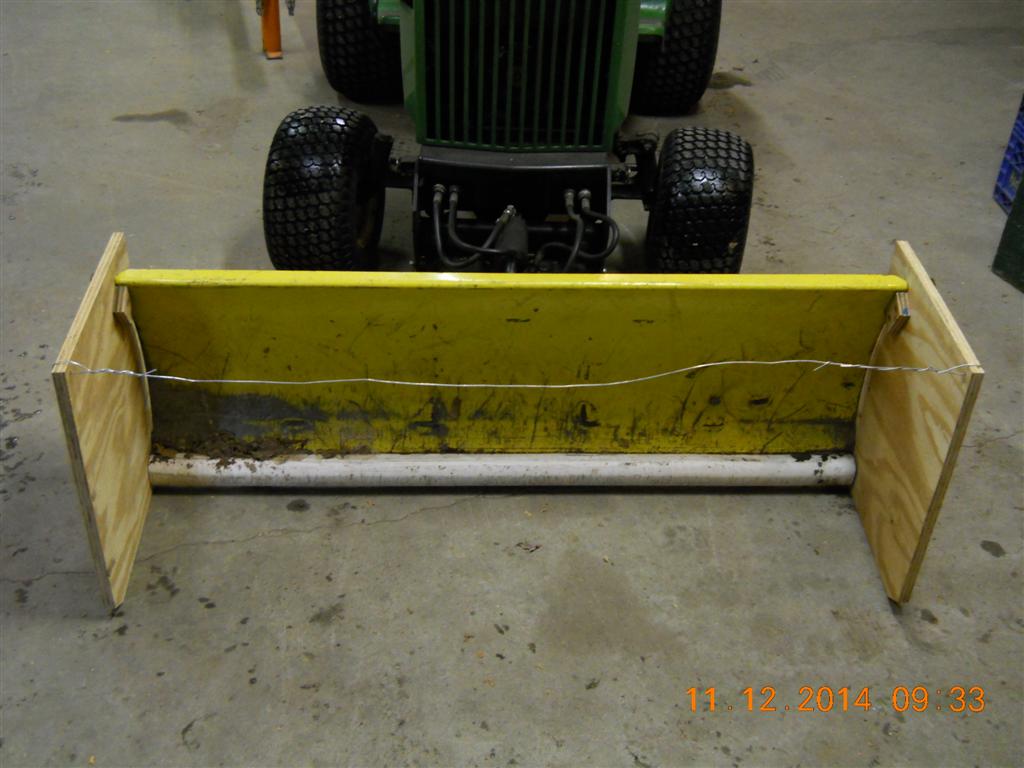

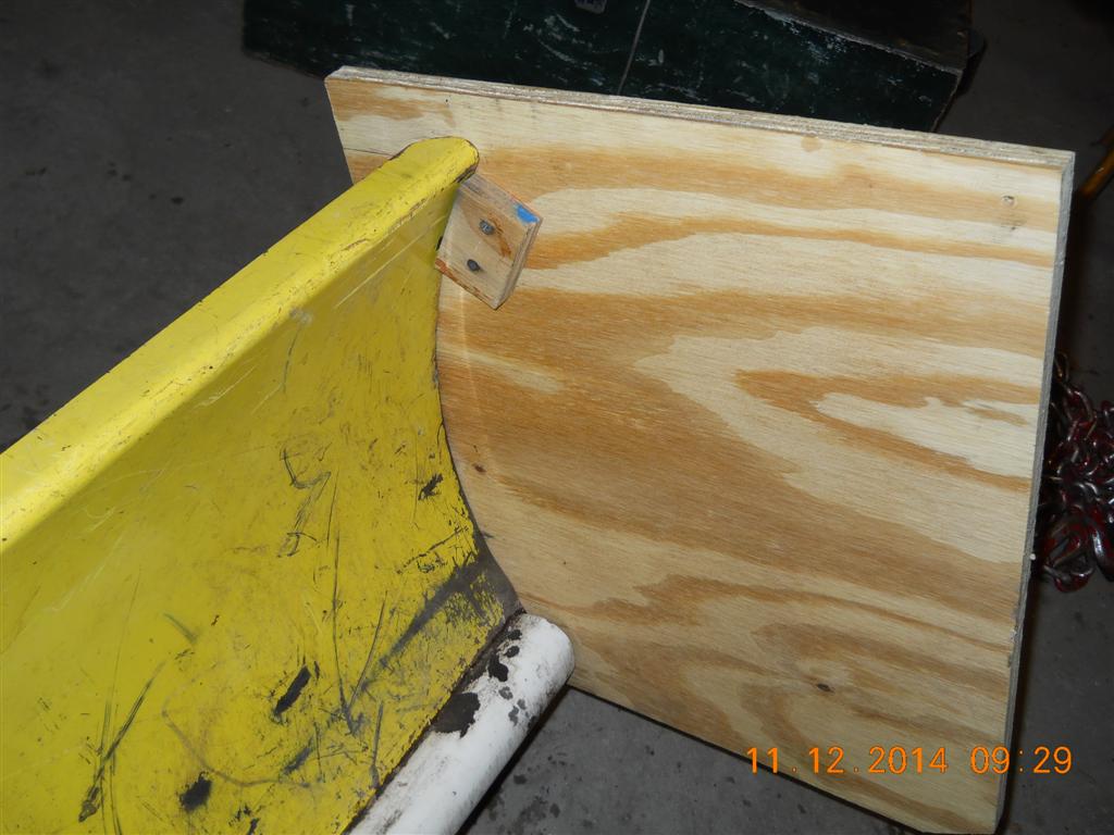

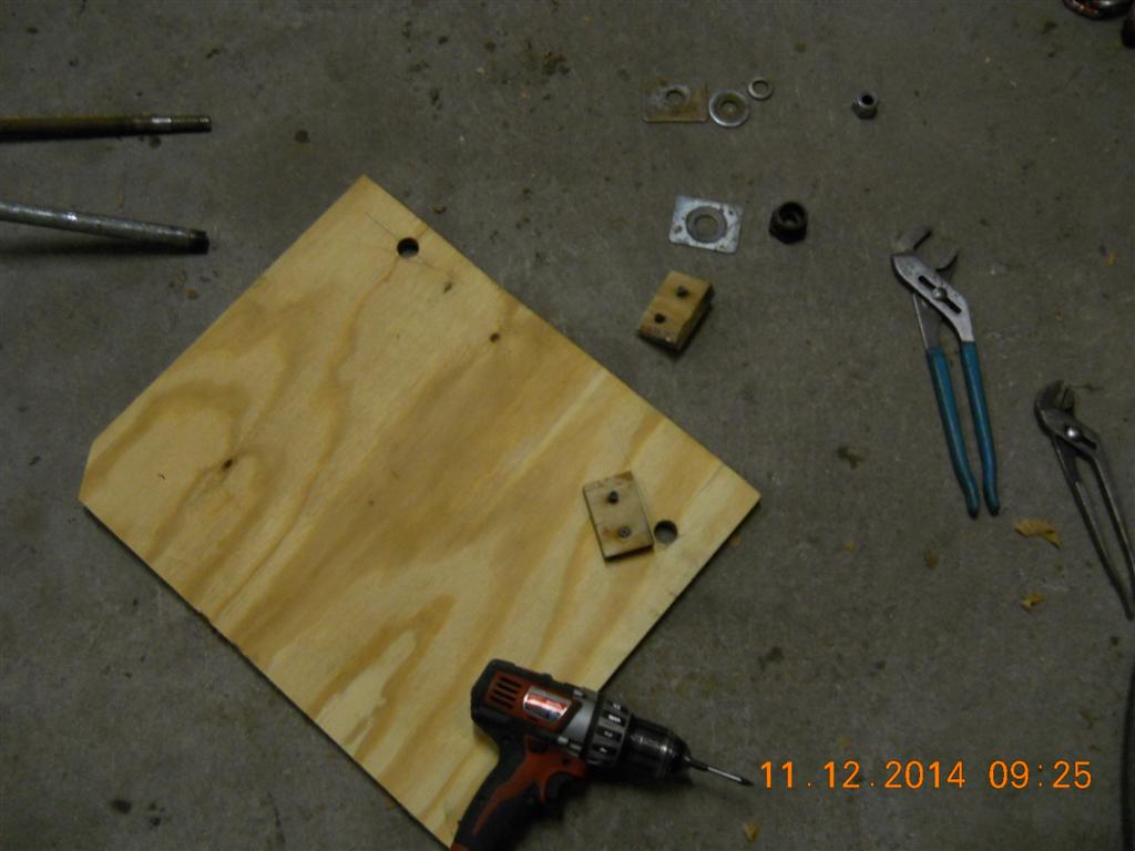

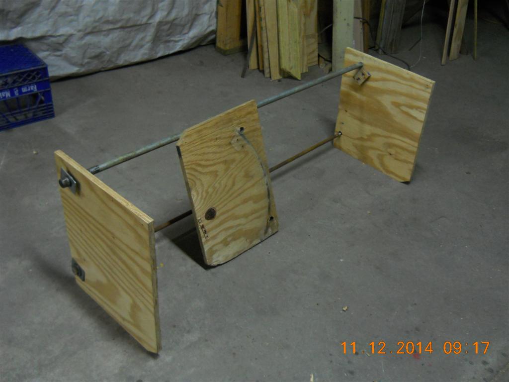

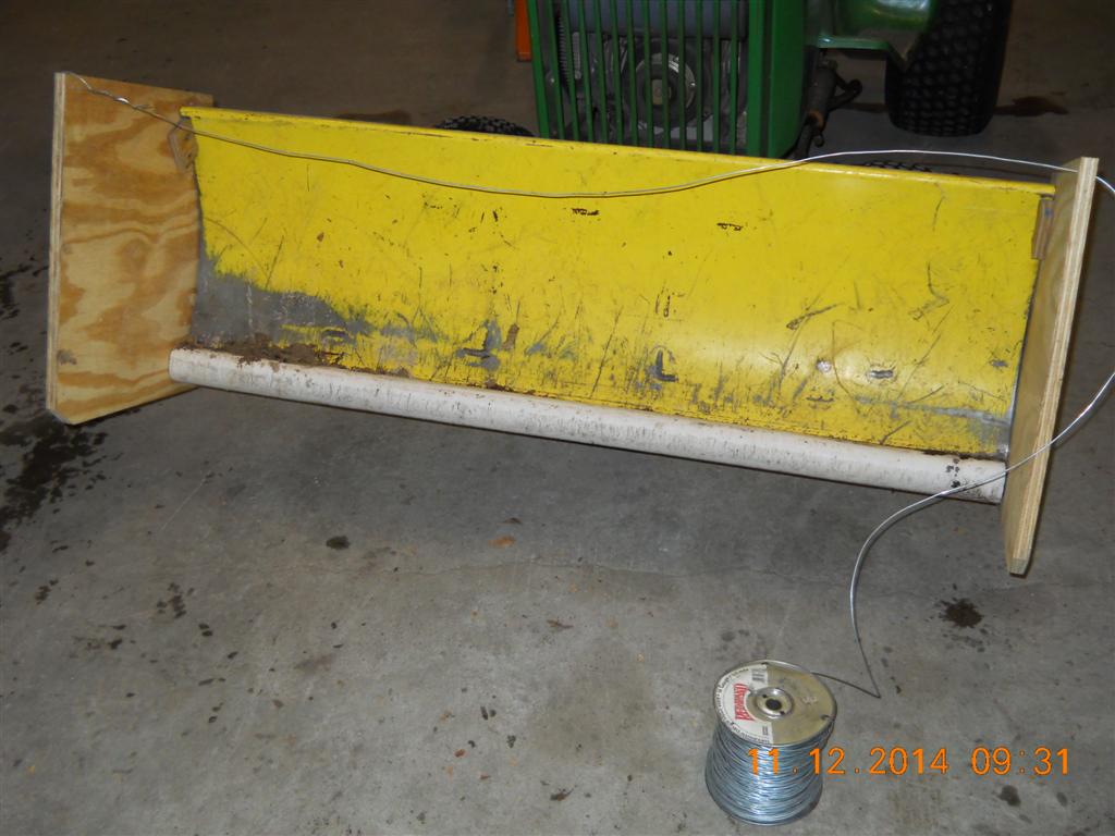

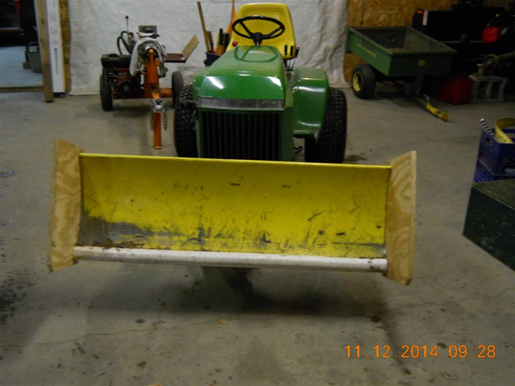

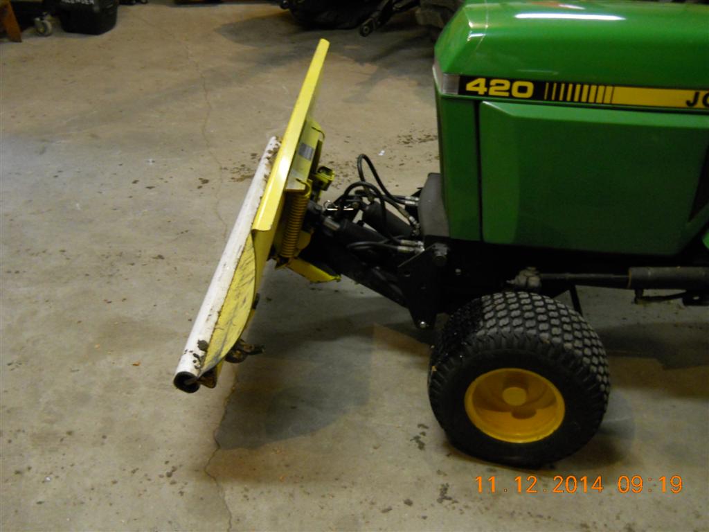

I normally run a snowblower, but here is my snow pusher I use for lesser snows... like the 6" of lake effect we received this morning. Just adding wings to my 54" front blade on an about one thousand pound JD 420 garden tractor. Two range HST, Onan 20hp. Just put two 100 pound Allis Chambers weights on the rear this year, usually put four... and she will push straight ahead until the engine stalls.... unless heavy ice. Used to use just one plastic pipe on the bottom edge, but now I am adding a second PVC pipe over the first. Having a harder time finding the black plastic pipe. The inner pipe seems to keep the outer one from cracking as easily. This setup I am putting on this year is new, with one of the older 'wings' shown in one of the pictures. When I got it assembled, I put a fresh Tractor Supply electric fence wire on the top to keep it from spreading. The bottom rod [ 1/2" stainless bolt lengthened in the middle by adding some 1/2" rod ] goes thru the angle brace behind the blade, and the top rod is a piece of 1/2" galvanized pipe. The rods hold the 3/4" plywood wings in place snugly on the end of the blade. I put two small woods blocks on the front of the blade to hold the wings in place on top. And the added wire keeps the wings from trying to spread too far apart. Anywhilst, this is how I have been doing it for years.... :)

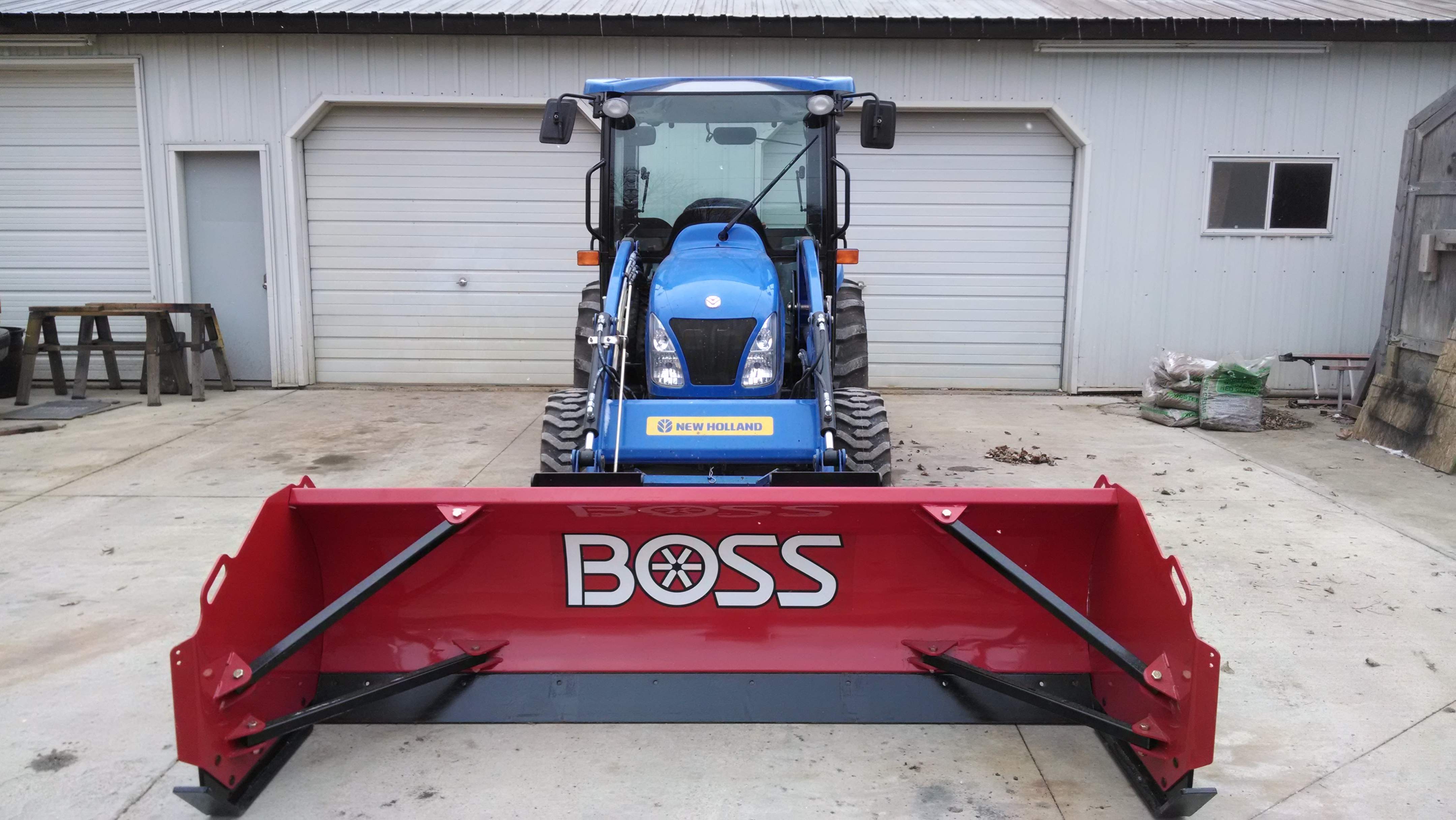

We had our first chance over the weekend to try this set up out. 8' Boss pusher with steel trip edge on 50hp New Holland. Moves snow just as well as our Boss V plows on a truck with much better visibility. No chains, but some additional rear weight would be nice.

Nice:thumbsup:,, I just don't understand the difference between a pusher VS a bucket.
To me, they do about the same job:confused:

A snow pusher holds more snow than most buckets. Work much better for clearing large areas.

I have the same set up. But with 2 link v-bar chains on the back and if it gets real bad I put them on the front also. Loaded tires and a 1400lb blower on the back. It pushes real well! CJ
