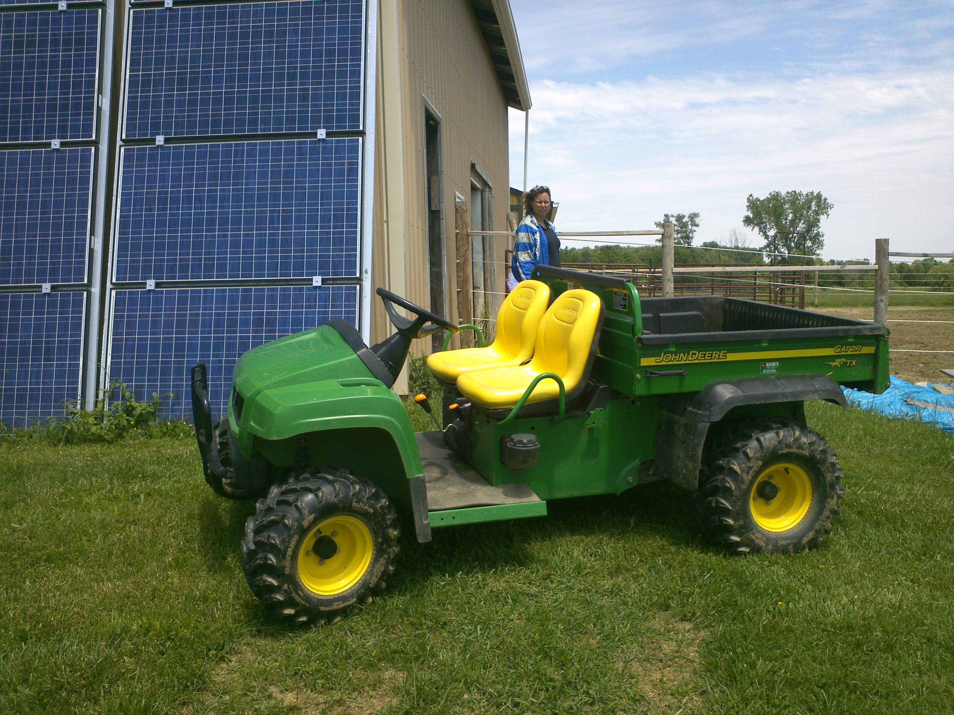

This picture is of my gator but you can see next to it my solar panels
I have 10 205 watt evergreen panels (but only have 8 in this string as my charge controller can only handle 80 amp) with an Outback MX80 charge controller that puts power into 32 72 amp/hr batteries
I have about 1100 amp hrs of power at 24 volt for storage
I run all my lights from 12 volt marine type fused rocker panels I get off of ebay
my lights are all LED (some flood off road lights out in the mud lot, some flood from Northern tool in the barn and some rope lighting in the stalls)
I have an 8000 watt inverter to run things that are 110 volt AC (bucket heaters, fans, battery chargers, hay elevator, ect)
My inverter has a built in battery charger to back feed the batteries with my gen set if no sun in the winter
If I remember tonight I'll take some pictures to post on my set-up
Has been on line for 3 years with no problems
