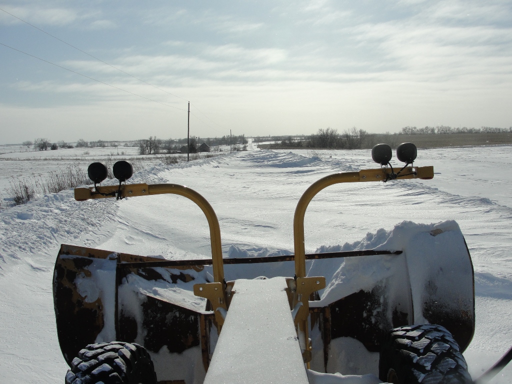

I run a grader on rural gravel roads. Every big snow I will find myself on the verge of getting stuck. I usually push at night and will lose track of where exactly the roadbed stops and the ditch starts. Last time I pushed my big "stuck" was that I backed into an unfrozen gateway and found myself sitting crossways in the road, buried to the top of the rear tires with the moldboard jammed into the roadbed in the raised position. Worst possible situation for a grader. Took me twenty minutes to get myself out. I never spun my tires more than one revolution in the entire process. Patience, patience, patience.
Once in a situation I STOP AND DO NOTHING until I've analyzed every step of the extraction. :eek:
For example, okay, first I'm gonna get the blade curled and firmly stuck into the ground and ready to push, then I'm gonna set the direction of my front tires, then I'm gonna make sure I've got the diff locked and 4wd engaged. Then I'm gonna very carefully start reverse wheel movement in time with blade push with the goal being to not spin. If I start to spin while curling with no tractor movement I immediately stop!!!! Don't want to spin a hole. Now, I reanalyze and pick a different method. I continue this process until I'm out.
Sometimes I might choose two or three methods before I get one that works. NEVER, NEVER do I just throw it in reverse and watch the wheels spin!!! All that does is make things worse. There is absolutely nothing gained by spinning tires and no vehicle movement.
I've pushed snow for 21 years and never have been pulled/stuck. I've always got myself out. Been in situations where the snow was piled higher than the grader roof around me and couldn't see any of the drive tires, still got myself out. It takes a lot of patience and careful methodical thought with each action. Makes a difference when you're not 100 yards from the warm house too. I'm usually in situations where the nearest help is a mile or more away. I've never made tracks in the snow walking for help. Now I've jinxed myself and will get stuck the next snow!!! :)
