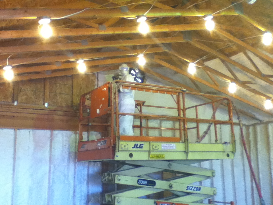

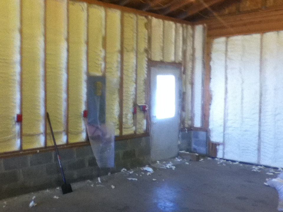

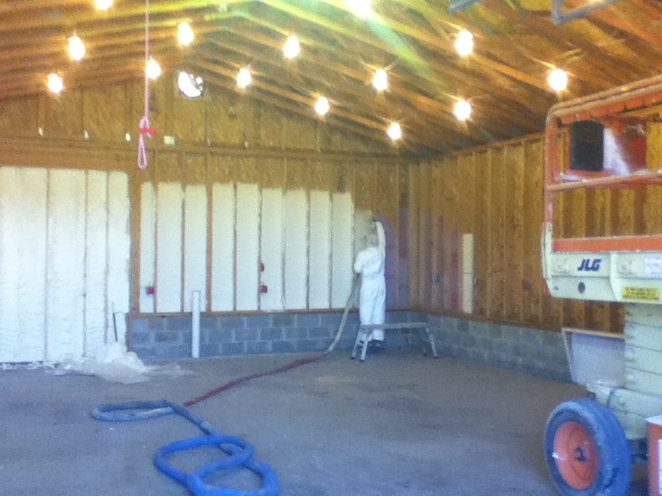

I paid $5k for the spray foam in my garage, Closed cell 4 inches in ceiling and 1 inch on walls. I have 6 inch walls, so added fiberglass bats over the foam to fill wall cavity.
The garage is 28X40

Great pics. Do you recall what R-value you got from the spray insulation??
/ spray insulation #22
I think you get 6- 6.5 R per inch for closed cell and about half that for open cell. The big benefit from the foam is not just the R value, but the air intrusion seal. So if you had the equivalent R value in foam and fiberglass, you'd still get improved performance from the foam. There's also a structural element too. The foam increases load bearing and wind load strengths.
/ spray insulation #23
gsganzer is correct 6-7 per inch. I was talked out of going thicker in the ceiling wanting to get around r-40. The foam guys said any over 4" would not be cost effective for central Illinois. Also have 2" foam board under the 5" concrete floor. The only weak link is the cement block stem wall, still work in process, any ideas how or what to apply? My current idea is to glue foam board to both inside and out and cover with another material. Used over 40 gallons of white paint and primer right after the foam was applied.
