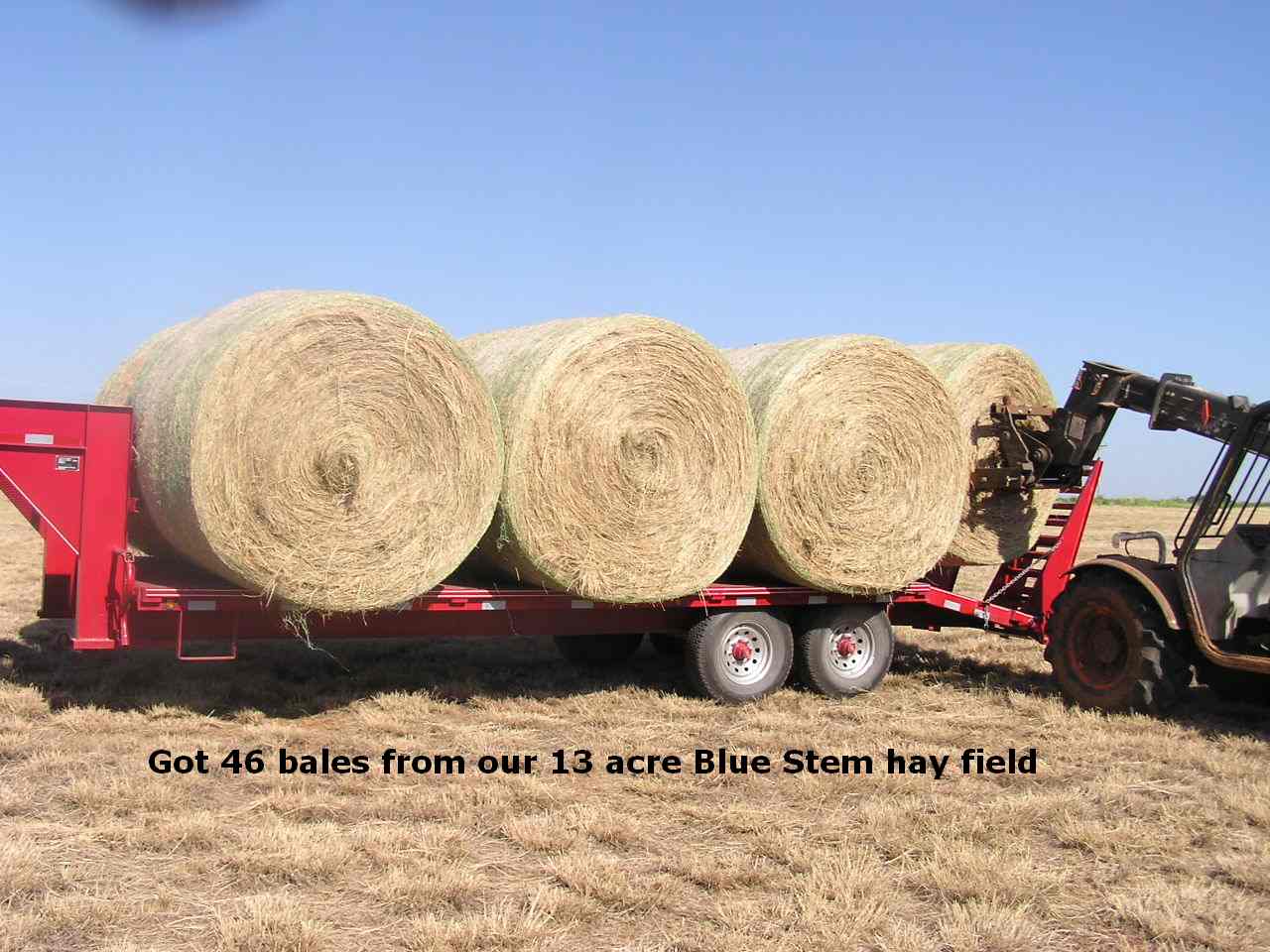

For hauling square hay bales, ramps make a back stop.
For round bales, leave the deck down and ramps hold the last one or two in place.

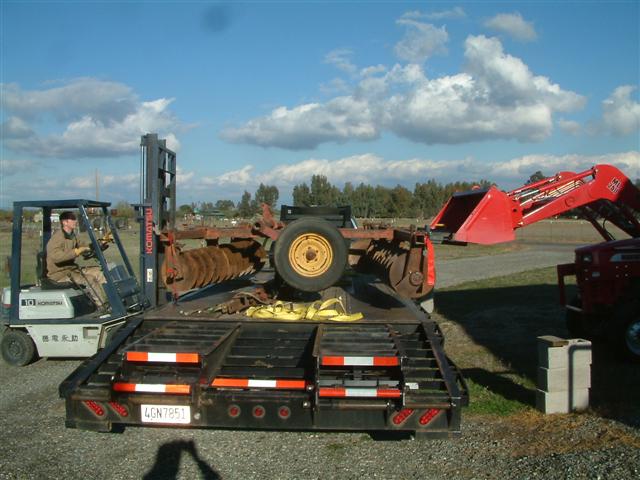

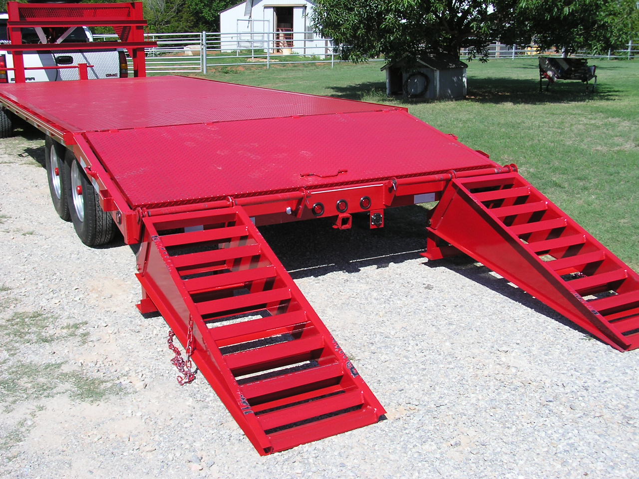

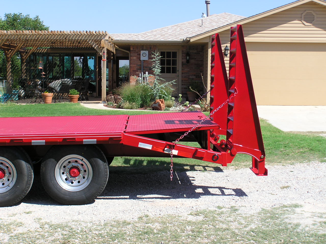

I like these ramps
