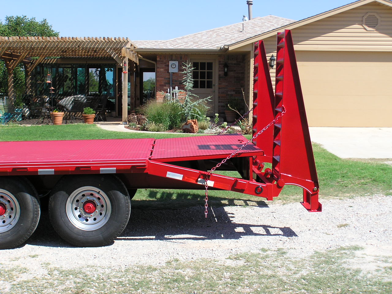

My 3 axle had slide in ramps and the 1st time I loaded my dozer it destroyed them. So I built a set of fold ups and loved them. My current 2 axle had slide in and when I have my 22' built it will have the Equipment dove #D08 no jackstand or blocks needed. Fold flat to the bed and can be stood up for room. I think this will be the best of all the options. CJ

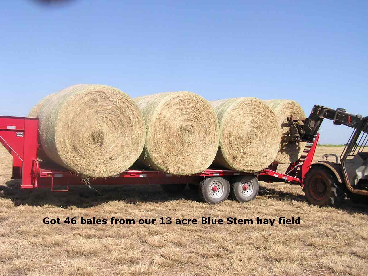

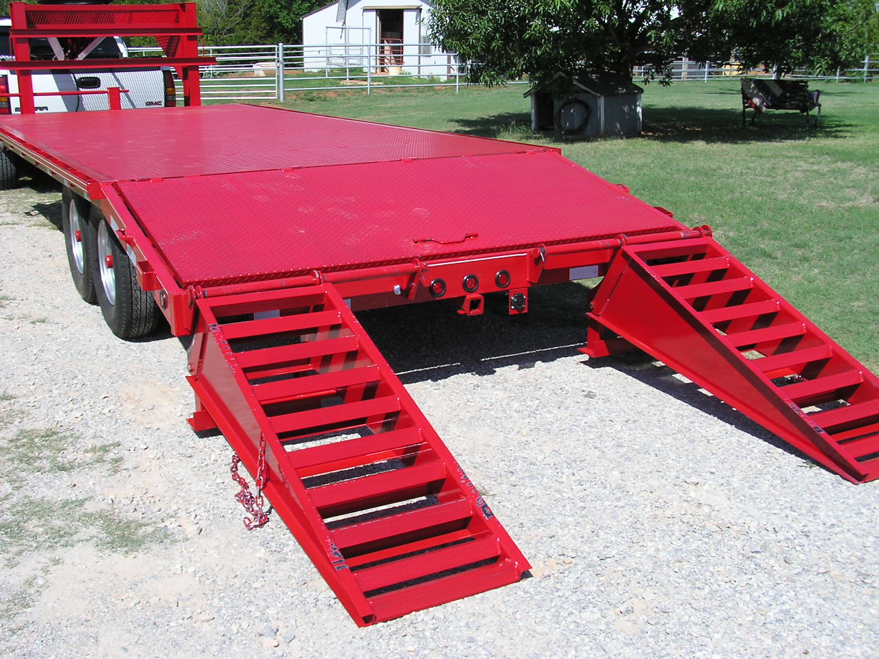

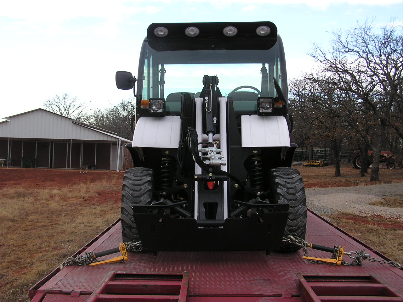

I agree with BCP: "First choice: Tilt bed
I found the perfect trailer for me, 4' pop-up dove tail.
For hauling square hay bales, ramps make a back stop.
For round bales, leave the deck down and ramps hold the last one or two in place.
For equipment, ramps slide in to match tread width, and support the rear.
View attachment 307240View attachment 307242
that looks like the perfect trailer for me too! what brand is it? standard or optional set up?
   / stand up or slide in ramps #28
It is a Delta, made in Northwest Arkansas. Equipment trailers from Delta — Single Wheel Flatbeds
I ordered it in July, 2005. Got a red one because when looking at the local dealers, on a sunny day black was too hot to touch for long, but red just felt warm. 5' Dovetails where too low at the back for my terraced hay field. It is 22' long with the Dovetail. It weighs 5000 pounds, 4000 on the axles. Should have ordered the 8K axles because of the weight of the metal deck. I went across the scales with 12,640 on the deck, 14,200 on the axles, 3440 on the ball, Just 3640 over the 14K GVWR.
Options: 18' long, with a reciever hitch, LED lights, metal deck, Dovetail OPTION 1: Four-Foot Lift-Up Dovetail, 7K Torflex axles, spare tire and wheel.
The ramps are easy to remove if not needed for a certain load.
