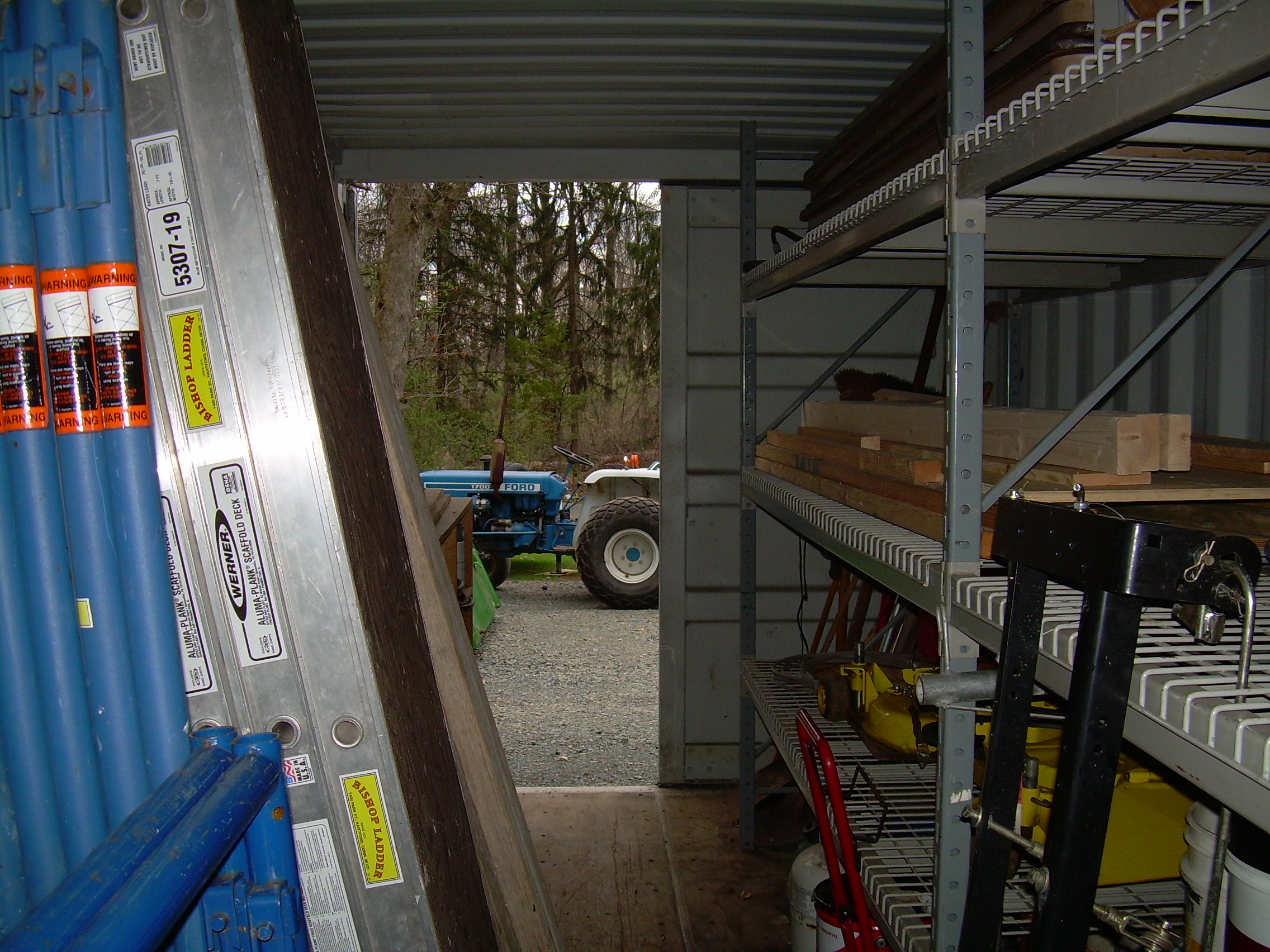

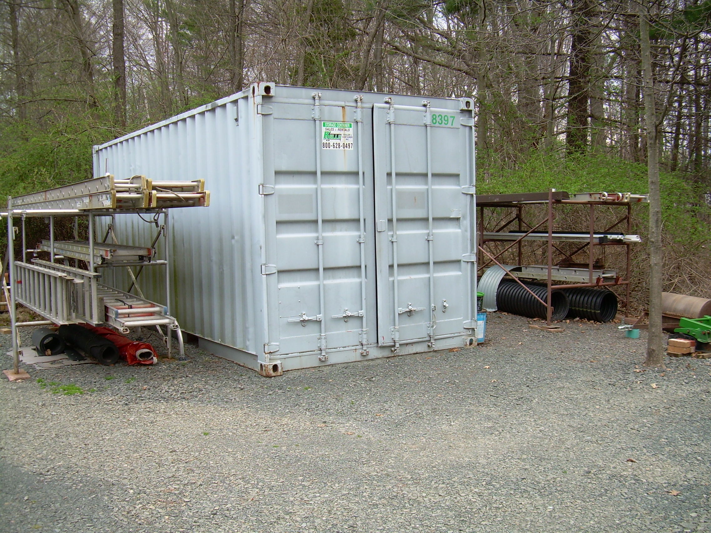

I had two 40 ft containers and my brother has one right now. I've drilled into all three of them, and cut out sections of mine and my brothers. The sides are single wall. Here is a picture of a section that I cut out of a container to make room for an entertainment center.

Sorry, WE have a 20 footer for records storage that is double, maybe our repair guys did that as the shelving is bolted to the interior and does not show on the outside. Our sister company does repairs w/ ILA labor off the pier and buys salvage units they fix up and sell. The entire repair shop support, locker room, parts even the welders & air compressor are made from containers...the guys work outside year round 'cause when we were in the port the owner wouldn't build a building as it would eventually end up in the pirt authorities hands...
I have seen one 40 that is double, it was a lease unit that my company returned for ACL from off-lease to the depot that ended up at our Motorcycle club; I ran the number in our computer after the club got it for free for storage. It was not a refer either...
I ASSumed they all were, my bad!
