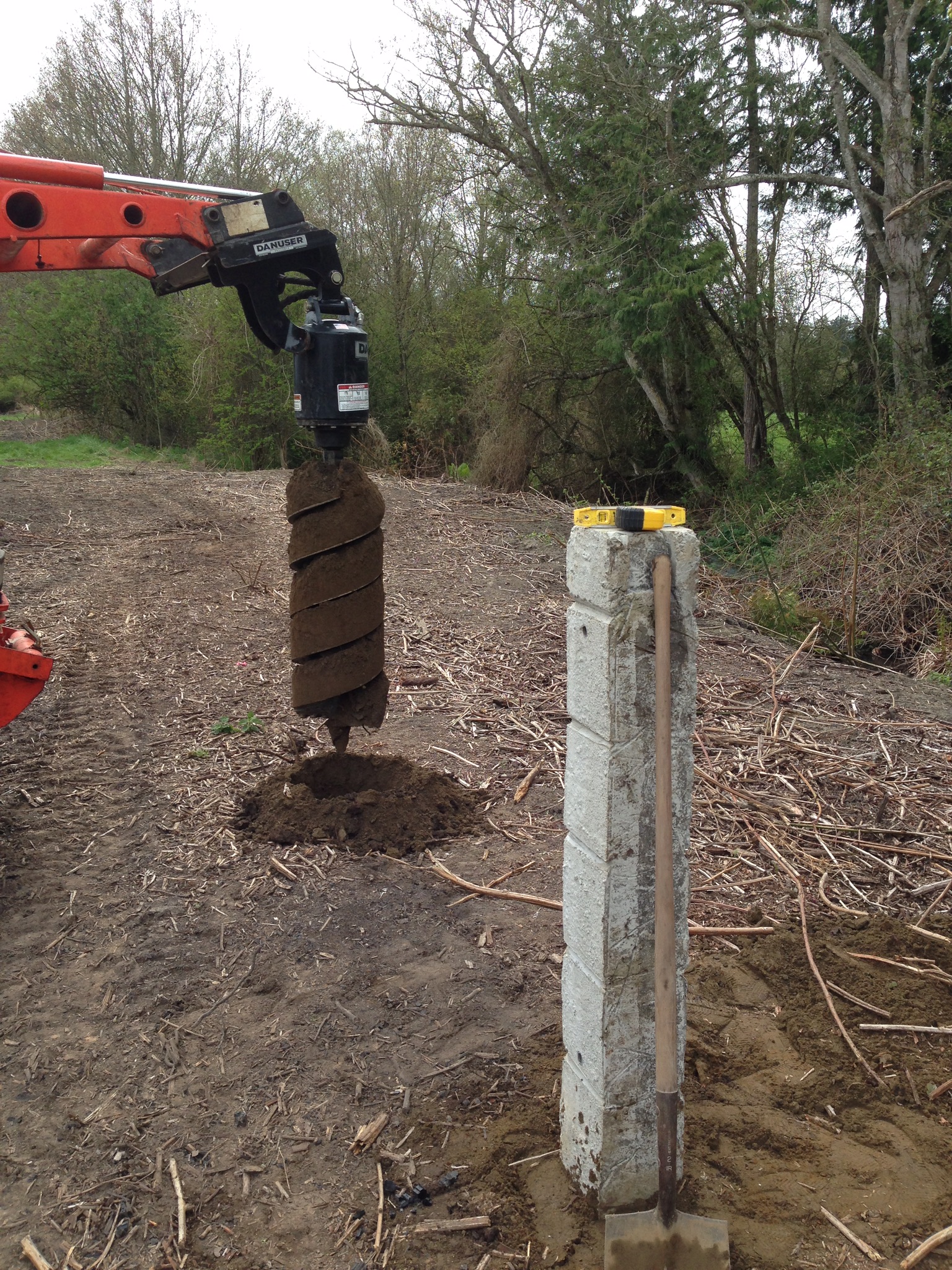

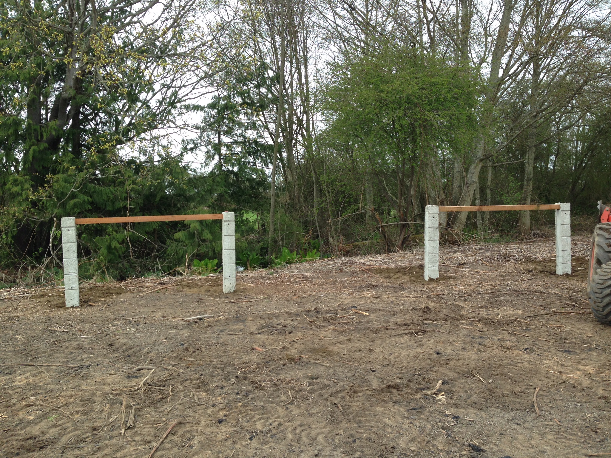

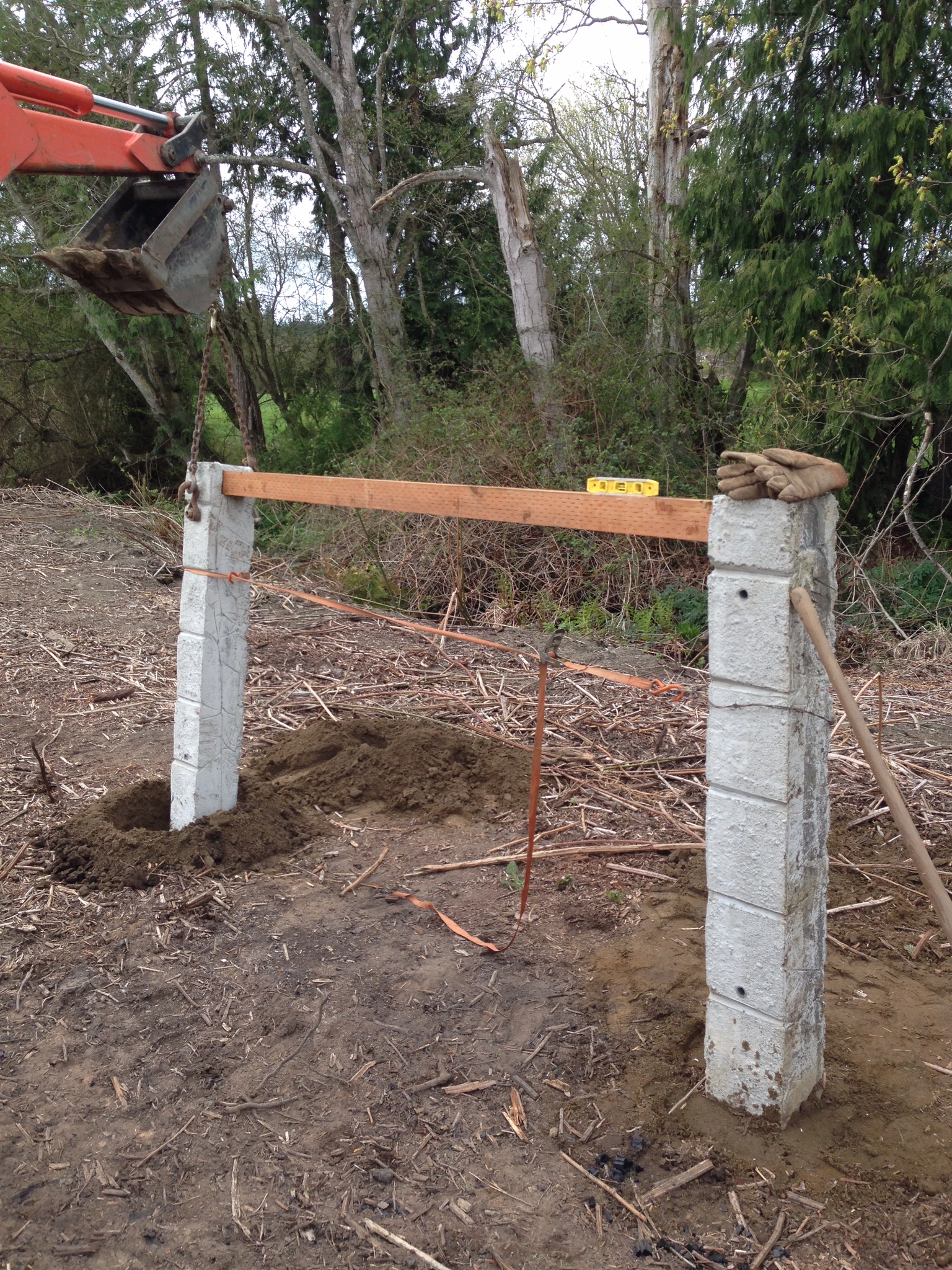

I make my end caps out of concrete and set them with a backhoe
696E1D1F-135F-4C42-960C-6A25833D5B4E.jpeg E914531E-95B6-40C2-87CA-8094A7979DF2.jpeg 76AADDFE-D3AB-45B3-A18B-32835CF16165.jpeg

I've thought about doing that. Seems like I see a lot of them still standing in perfect condition on TV shows about WW2. Makes me wonder how they where built, and why couldn't I do the same thing?
I make mine at about $30 each, including 4 sticks of rebar. I do X-brace with wire using the two tubes on each post. It is a lot of work, but it is a one and done. Got tired of replacing wood posts. Barbed wire is tightened into the grooves which holds it from sliding.
