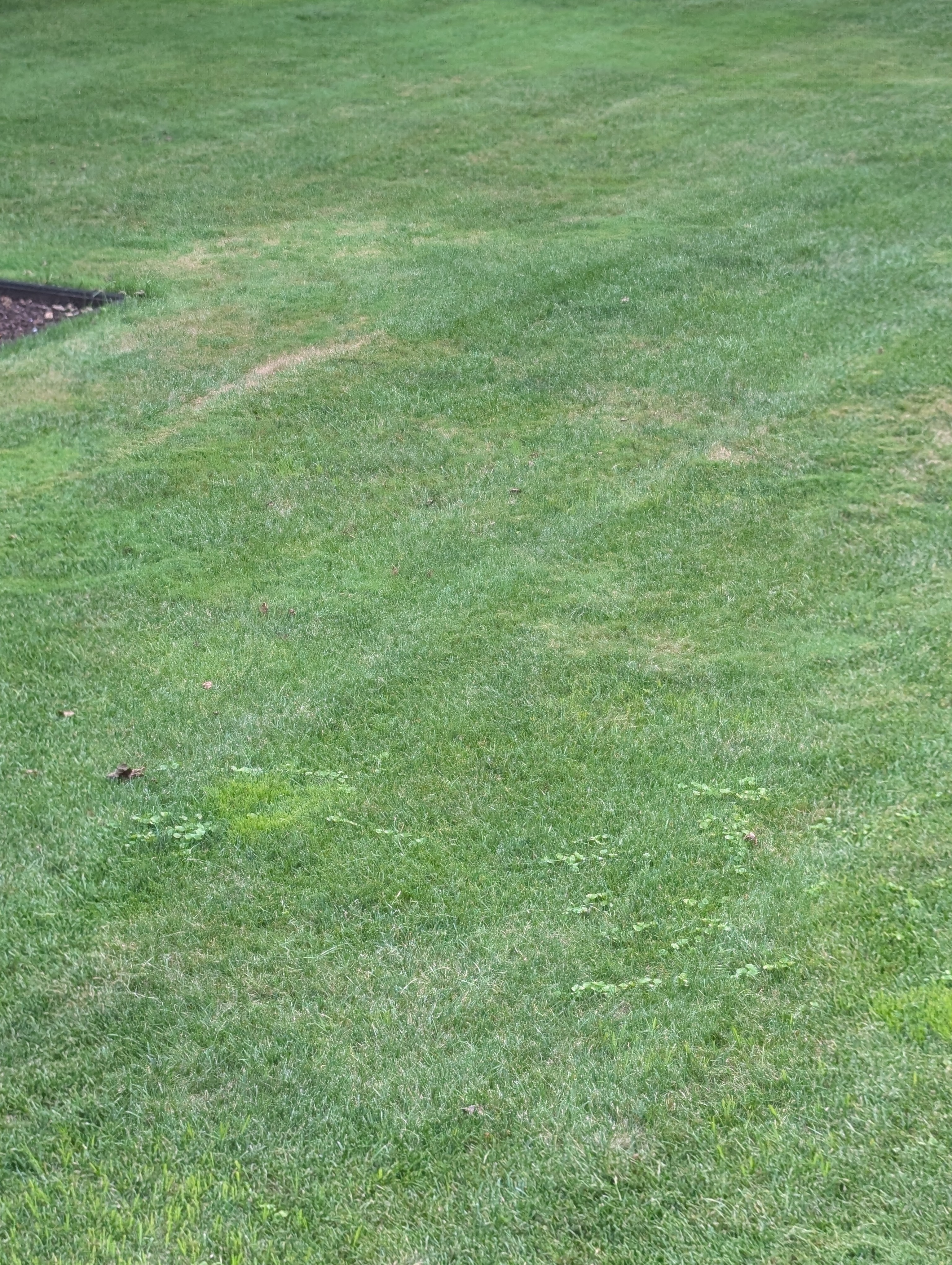

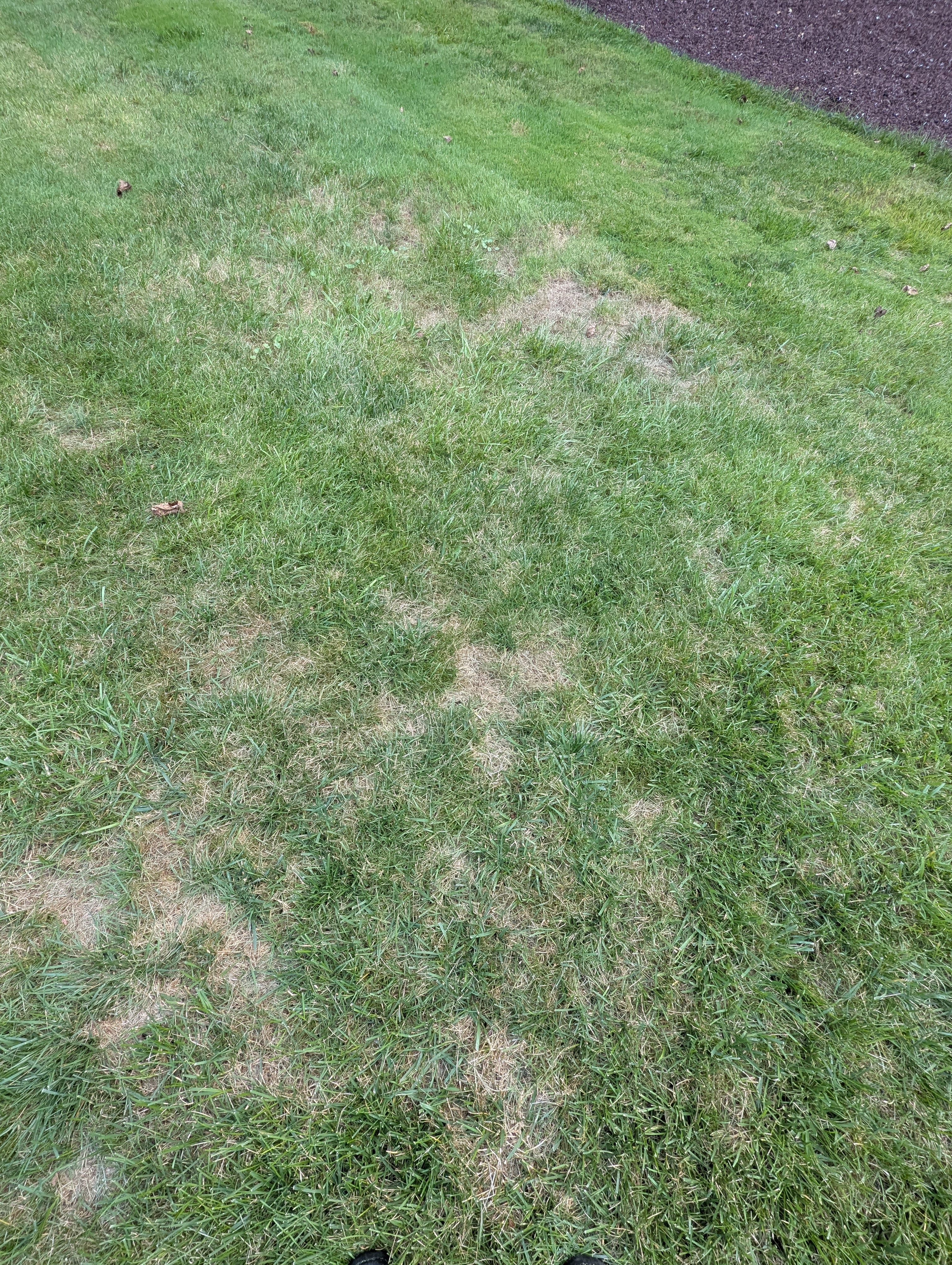

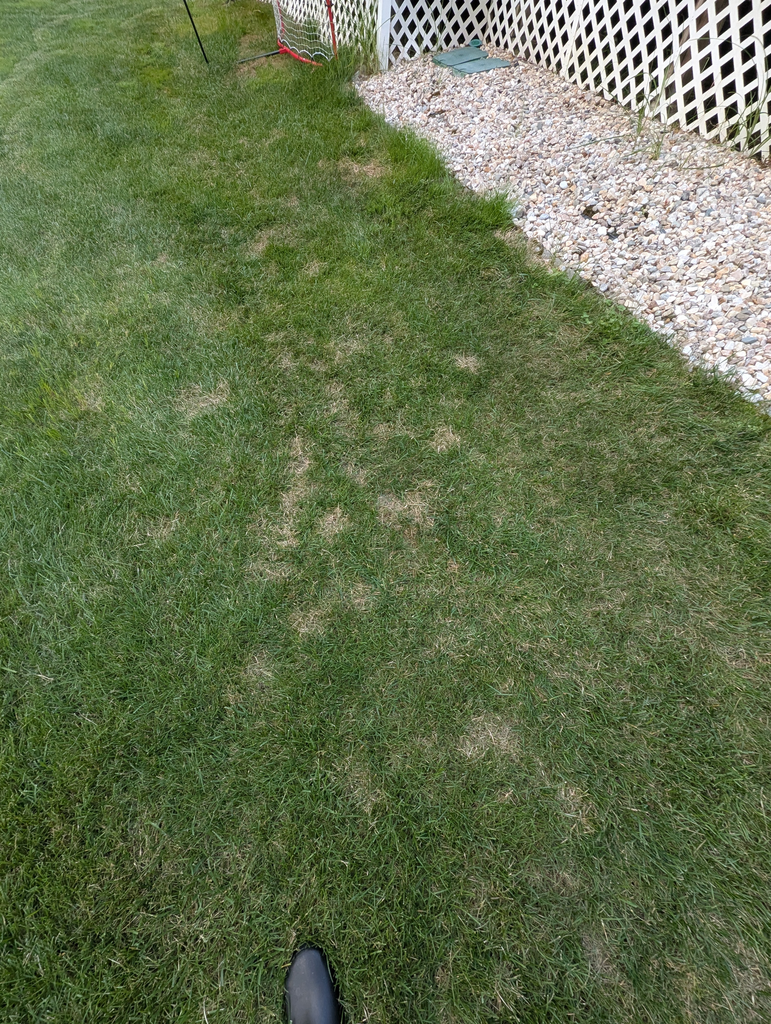

I have a lawn issue. I treat for grubs, but I am not sure if this is grub damage.
Any opinions?

Excellent comments guys. Not a dog, looks like Kentucky blue grass that just turned brown.
I will look online how to see if it is fungus, and check for grubs.
/ Stubborn Lawn Issue #7
Tough to tell from the pics, but to me, it looks like those dead spots are in low areas. If so, I concur with the fungus diagnosis.
One way to tell if it's grubs, is to pour a 5 gal bucket of water in one square foot and see if any come to the top of the soil. Or, take a shovel and dig down 4-6" to see if you have any in the same basic area. If you do have grubs, it's either time for another grub treatment, or change the chemical you're using. The best thing I've found is bifenthrin as the active ingredient. Haven't had grubs in over 10 years since I've been using it. Also good to prevent ants, army worms, and bunch of others.

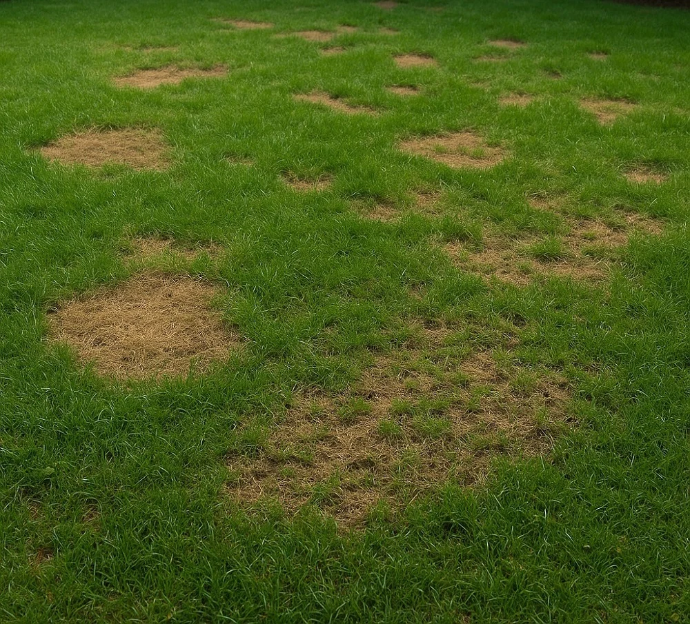

Grub damage normally appears is large patches, usually circular, like this:
One give-away is that you can often grab a tuft of grass in the damaged area, and lift it almost like a carpet, as the roots have been eaten away.
It's tough to say if that's what is happening in your photos, but we are only two or three weeks out from the ideal over-seeding window, and you can adjust your grub control application timing next year to try to knock the little bastards down. Usually, you want to aim for mid-June, just a week or two before you typically see the Japanese beetles.
Most of the better grub control products are strong enough that a twice-per year application will put you at or over the legal yearly dosage per acre. So, it's important to get the timing of the one application you're putting down right, as they only have a narrow window of vulnerability to these products.

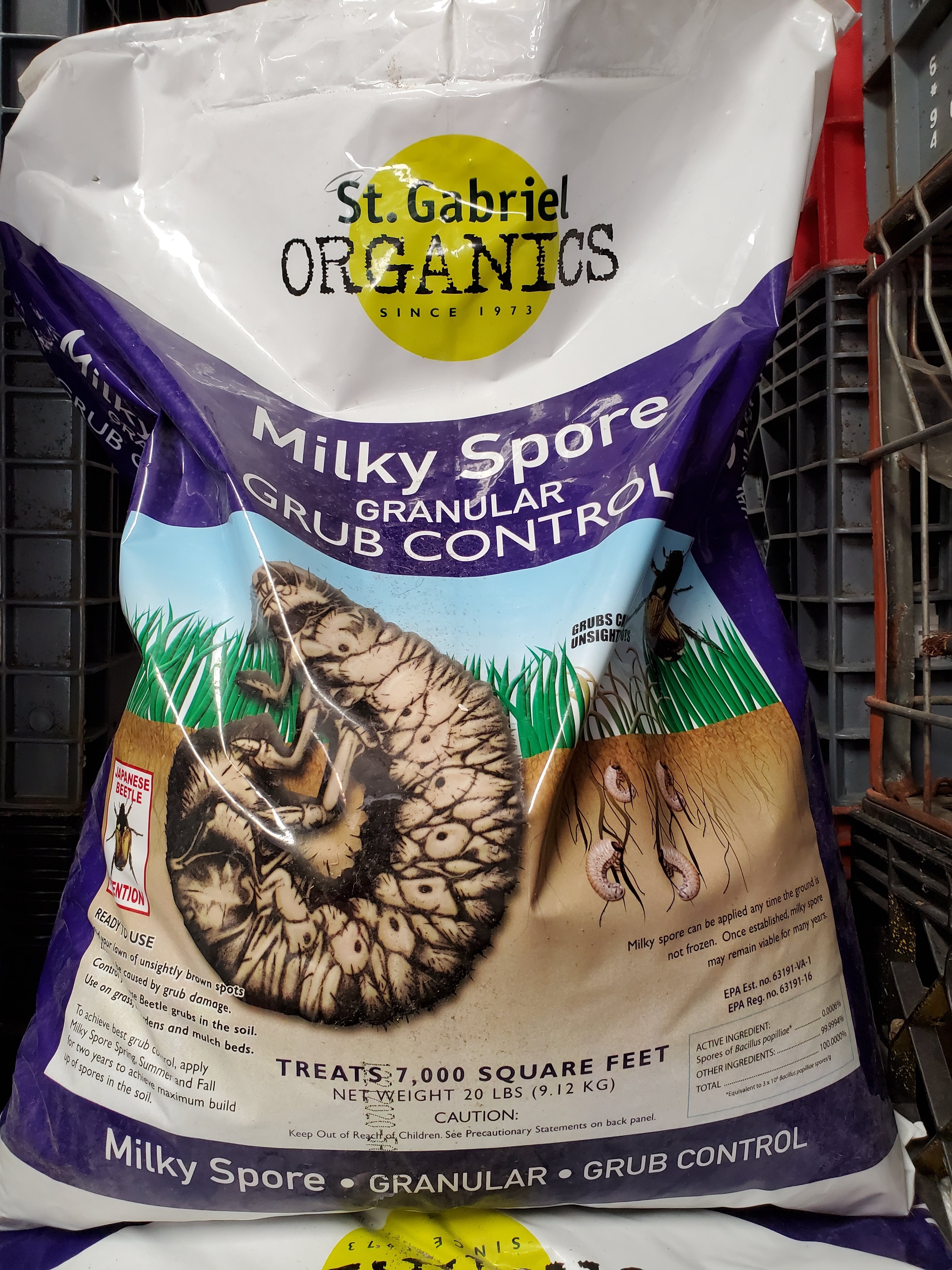

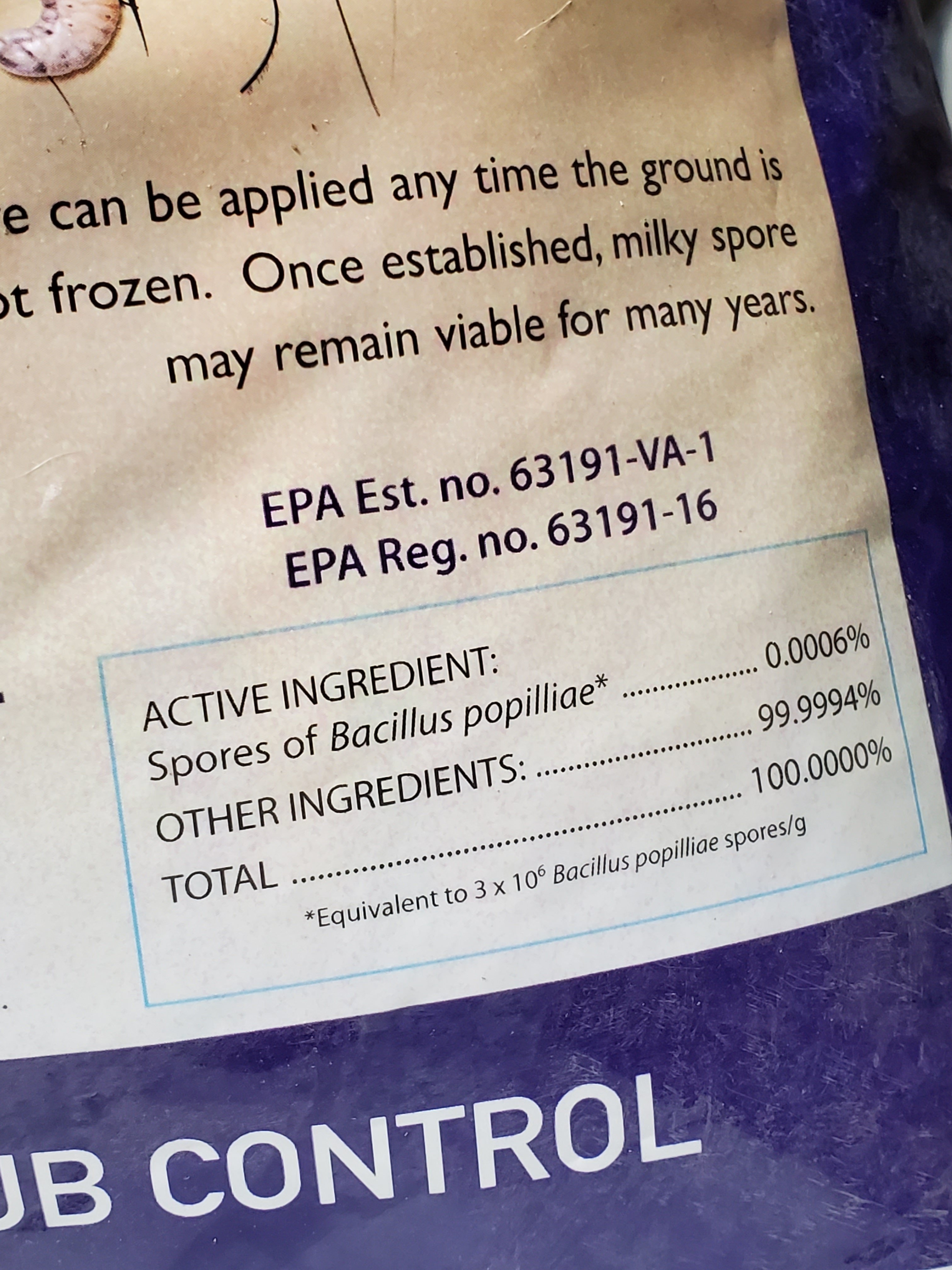

Like RjCorazza, I applied milky spore, see attached pics, to lawn and my japanese beetle population and resulting rose and turf damage went to zero after about two years. Takes some time for spore to spread itself through the ground and kill off the grubs. The spores stay active in the ground for many years and continuously repopulate themselves as new grubs find there way onto my property. The neighbors continually treat with insecticides but don't get the kind of control I do with no more effort than original treatment. My lawn consists of mix of tall fescue, perennial rye grass, and kentucky blue to prevent mono culture and associated issues.
ps. Looks like your grass is mix ( pic ... 352 ) is mix of fescue and kentucky blue
