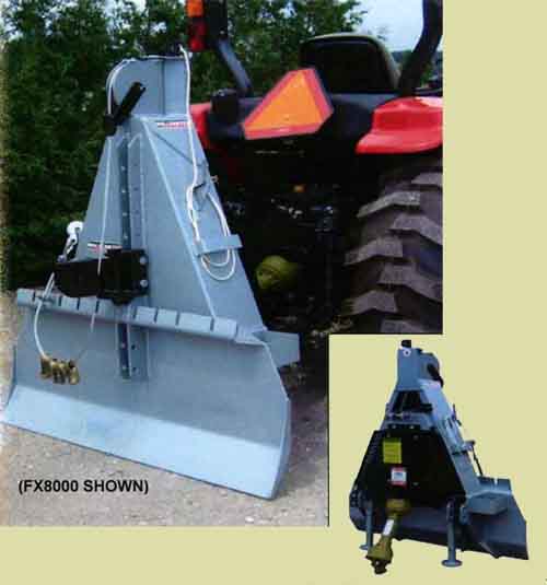

You just get your other tractor...:D ...with the...
Logging Winch
Choice of two models of log skids with winch which can be used to winch out logs that you can't get to with the grapple, and/or to drag out several logs at a time over longer distances. The skidding wenches come with 165 ft. of 3/8 inch cable and 165 ft. of 1/2 inch cable with a 8000 lb. and 12,000 lb. capacity for the models FX12000 and FX8000 respectively.

The perfect answer! Go buy another tractor, so when you get one stuck, you pull it out with the other one!
