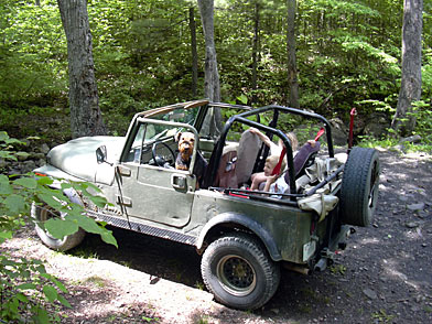

Thats one nice CJ7, here is mine:

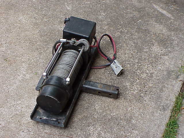

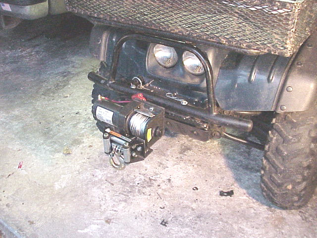

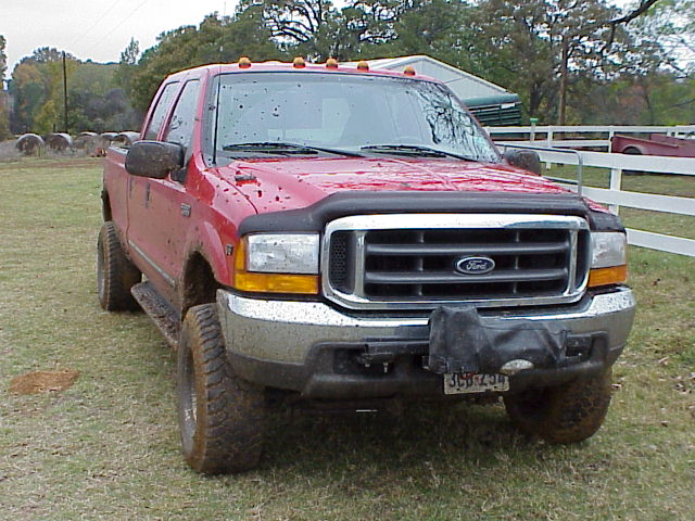

My only problem with a hydraulic winch is what do you do if the engine stalls? Or the vehicle is tilted where oil pick up could be a problem. SOL.
Since I don't like using a winch and try to avoid needing one, I use the old Ramsey series with the permanant magnets. Only about 200a draw verses the 450a draw of a series wound motor like Warn. Plus on my truck and ATV's I rigged a multi mount system so I can move the winch to the front or back. Sometimes I just don't want to go forward anymore. :D I rarely put the winch on my truck these days, I keep it out of the river bottom (3rd pic).
But yes the power winches are sweet if the motor is running.

Nice CJ czechsonofagun...

Thanks, it's an '83 CJ-7 Limited (thus the satin black windshield frame) Reagrding winch power, yes, I have an AGR high flow pump (and AGR steering box). Basically, your high pressure line runs from the pump to the winch, then from the winch to the steering box, then low pressure from the steering box back to the reservoir. It's a nice setup. The winch has 2 speeds, too.

If you are referring to a hydrauliuc winch working under water, I believe they will. But if the pictured jeep's winch is underwater, then I don't see the engine running. That seems to be more than half way up the motor and water would be in the doors(but really a jeep that nice looking is probably not going to see any serious trouble...at least it wouldn't if I owned it..:D). Not to mention the fan would be kicking up some serious splash.
