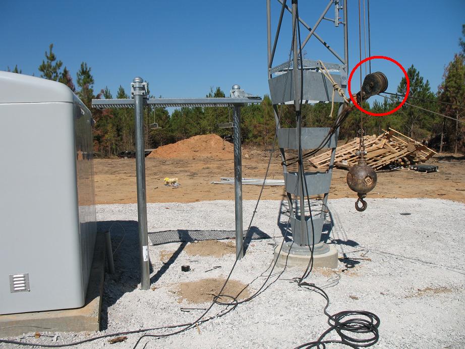

Yea, but it all becomes a question of what I can carry.. what does a 60,000 lb. pulley look like? How big of a cable?
edit: gotta love google. apparantly they use 7/8 cable for 60,000 lb. roll-off dumpsters.
I believe I read "21 TONS" on the double pulley at this tower site.

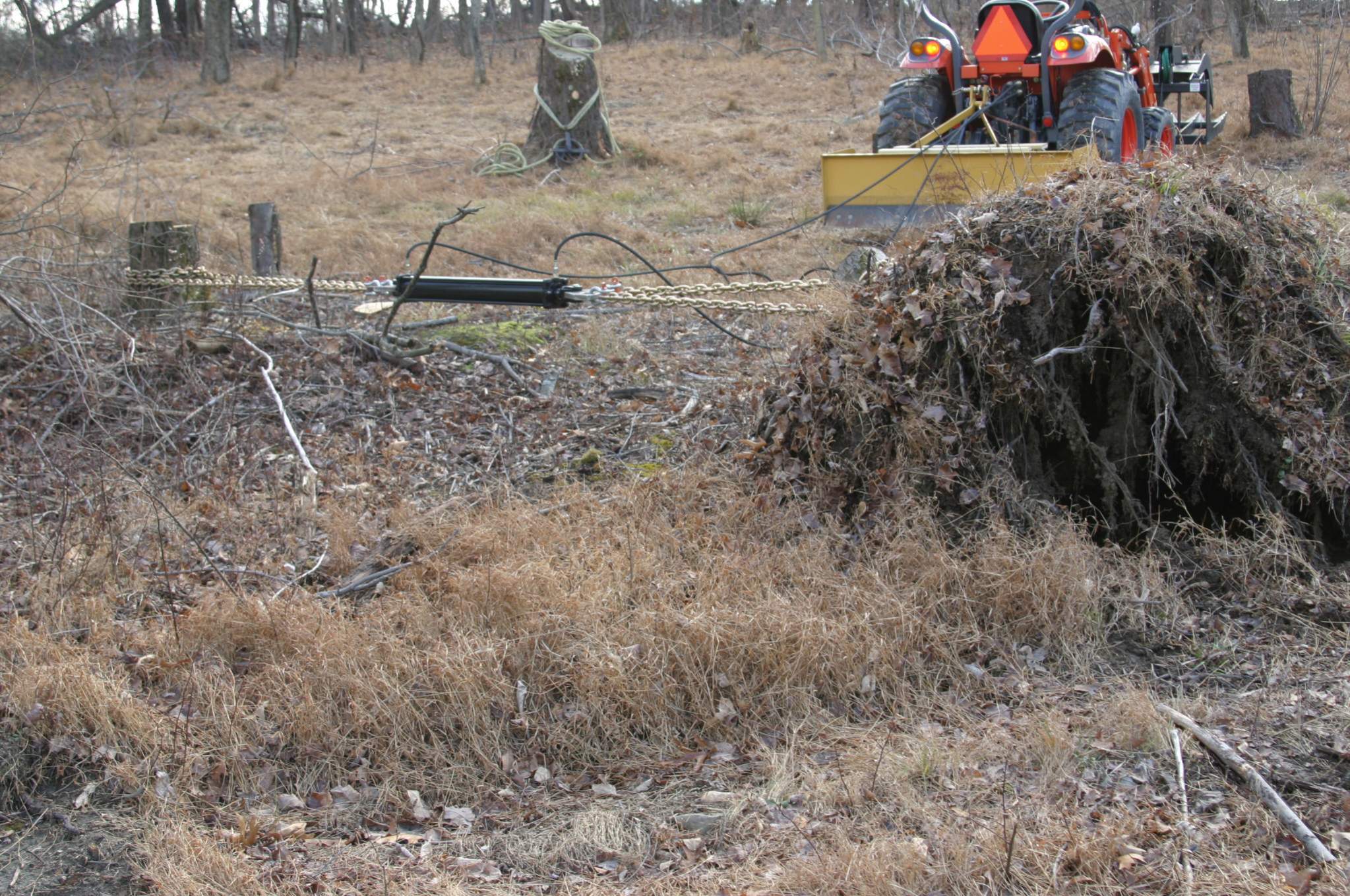

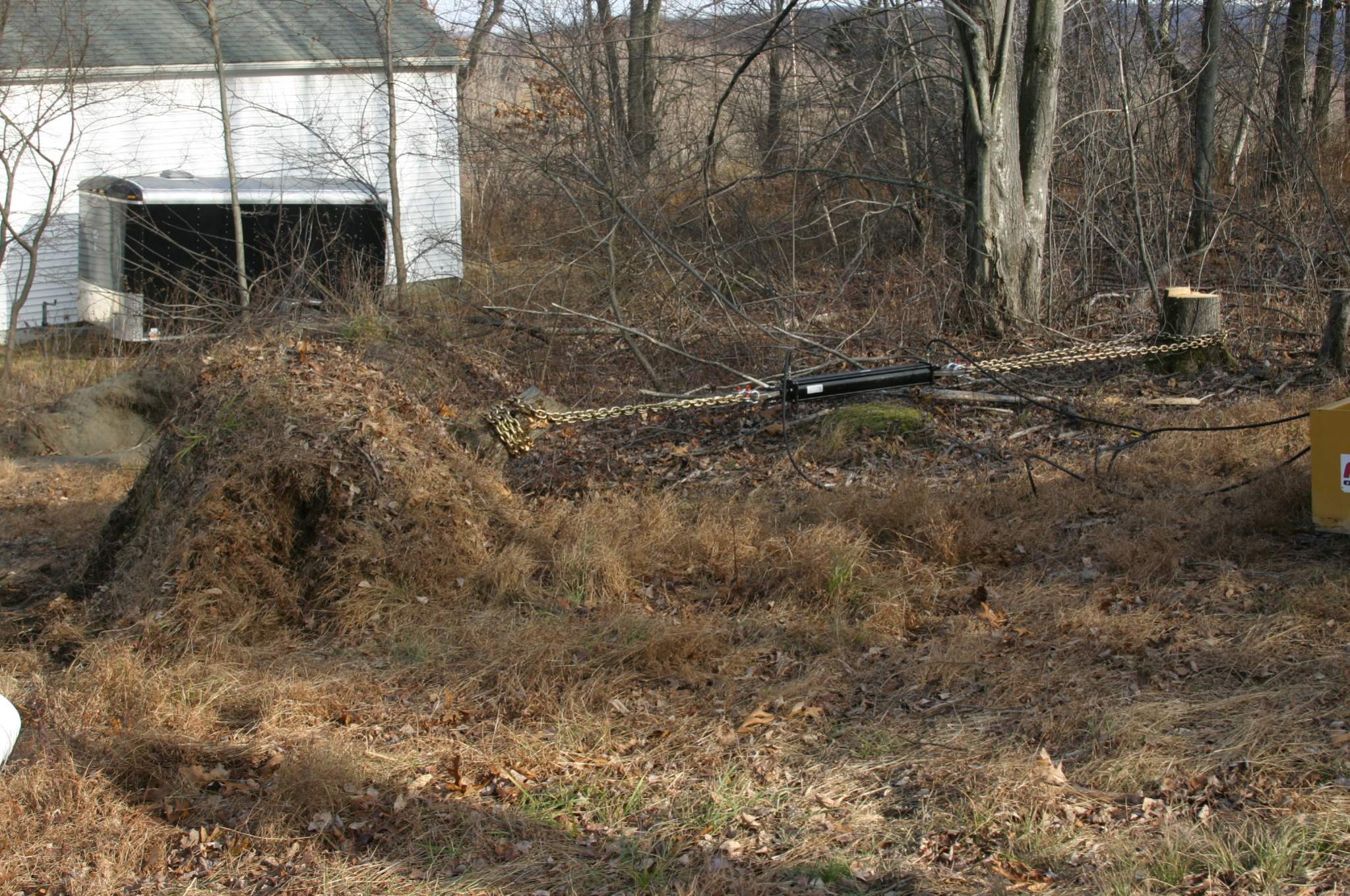

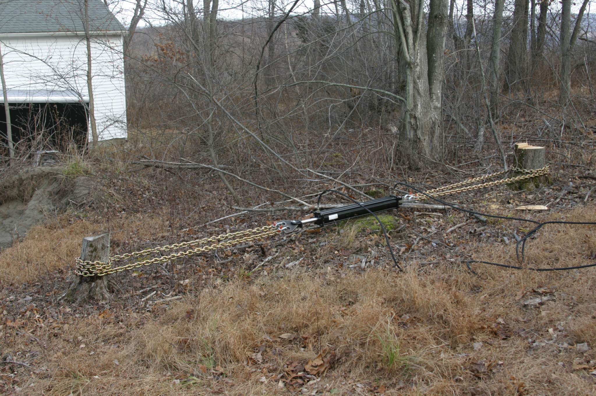

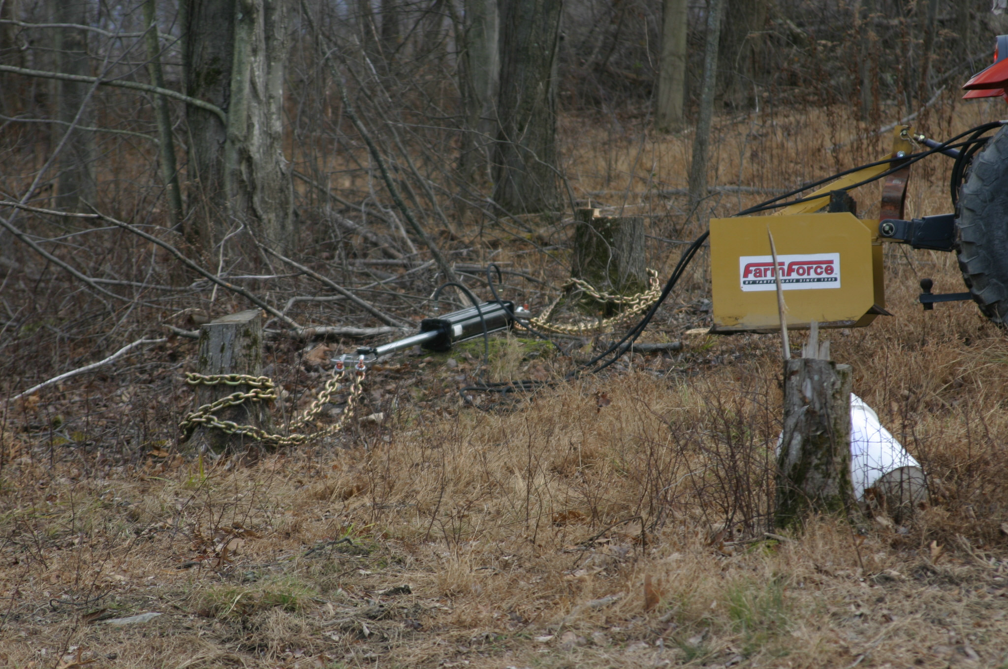

#48
numero uno. 8-10" (where do you measure?) this was cut last year.

/ stump speech #49
Nicely done!
/ stump speech #50
Wow, now we're talkin'! Comments? How did it "feel"? Was it maxed out? Was that size stump nuthin' for it?

it didn't feel it. gonna try a bigger one now. spent most of my time this morning filing/grinding one shackle hole to make it fit..
/ stump speech #52
:thumbsup:Jake, initially wasn't sure how you wanted to do it but as they say 1 pict=1000 words. Have you thought about putting hooks on the shakles to make tightening up the chains easier/quicker?
Good Job!!
Rick

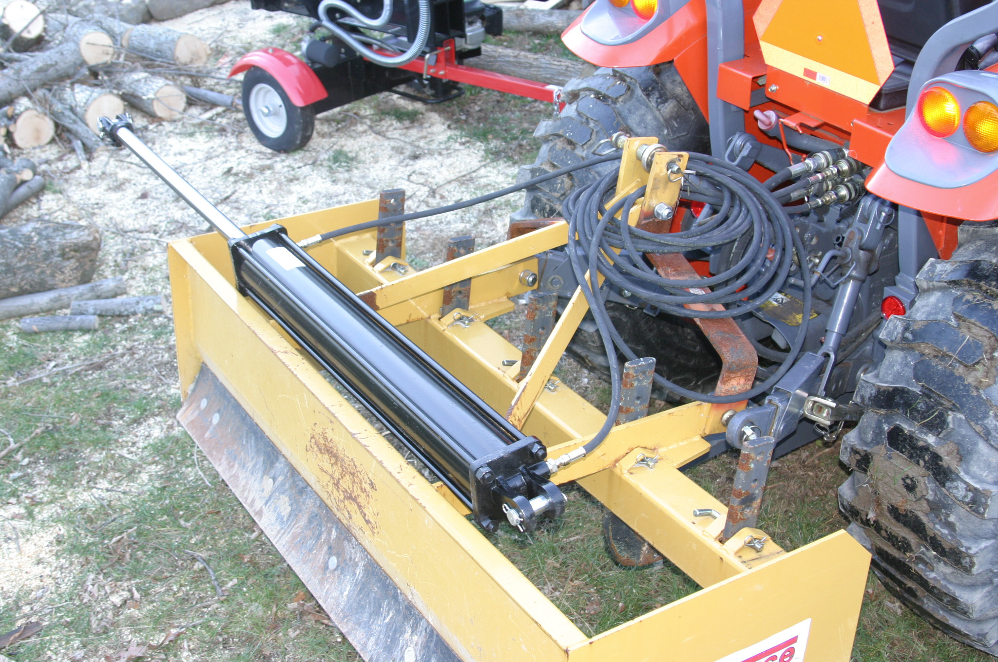

/ stump speech #53
Can you use 1/2" Grade 70 Clevis Grab Hooks instead, like these? (9,000 lb WLL)
yhst-88039420719426_2133_12290722
Edit: Went back & re-read that you have hooks on order.
/ stump speech
#55

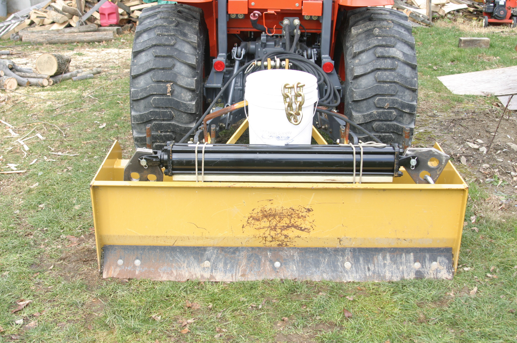

I was definately missing the hooks. Need a temporary chain too, to hold it when I'm readjusting. Seems like the double chain might be overkill for that size stump. I have a pressure gauge, I guess I should hook it up. Have to go ask the hydraulics experts if it matters where (like is it ok to have it by the tractor end of the hose), I think it all evens out somewhat.
With this wet clay ground getting them loose is only the beginning, I have to come up with a way to get some of the dirt off. I was picking at it with the little BX back-hoe. Maybe forget about that and just drag them to the low side and push them off. Anyway, I didn't get to try a big stump, tomorrow I'll see how that goes.

1 1 7 - 2 6 5 139.0000 EA 139.00
4 X 34 TR CYL 1.50 ROD
SUB TOTAL: 139.00
SHIPPING: 44.94
I got it from Baileys, their link is on TBN

Very interesting, thanks for the link to Bailey. I spent about 15 minutes trying to find it on Bailey's - a forestry supply company I frequent :)
So did you just get the hoses and fill them, purge them and then hook them into your rear hydro?
I've got a B7610 and it looks like you hooked them in about the same place I hook my backhoe. I'm a total noob with tractor hydraulics, any suggestions for what else I'll need?
thanks
/ stump speech
#60
Just hook them up, they fill/purge themselves. I don't know much about hydraulics either, just the principle. You hear some say to use teflon tape on the fittings, I've heard not to and I don't. No leaks.
So you're going to pull some stumps? It's one of the cheapest attachments I've used, and who doesn't want an excuse to buy some heavy chain?
You need to talk to the Kubota guys, I think their system is different, open vs. closed, or something like that, pressure on all the time..
