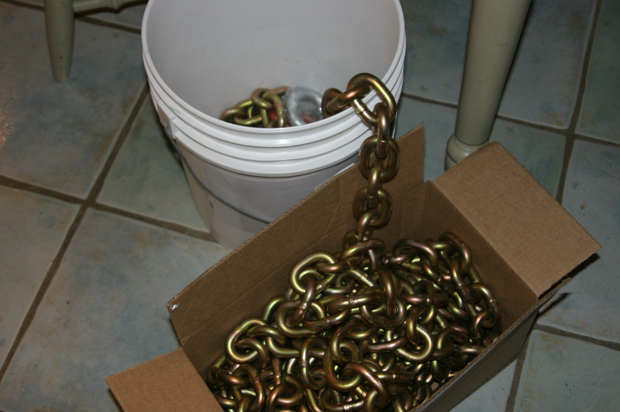

I'm wondering about the actual forces involved now. If I could do it with single chain on each end it would make it alot simpler. I need a way to set the pressure to the chain strength to avoid breaking expensive chain. I guess the gauge and the throttle will do it.
/ stump speech #65
As far as the pressure gage, you can tee it in anywhere. For a permanent mounting, I would tee it in before the first valve. Then you can use it as a reference, and to trouble shoot your hyd system.
If you did the solenoid valve thing, you could stand off to the side or close up to adjust the chain. A toggle switch would extend and retract the hyd cyl.
Your cyl has a lot more force than the chain. This is grade 100 specs
http://www.1st-chainsupply.com/chain/gr43_spec.htm

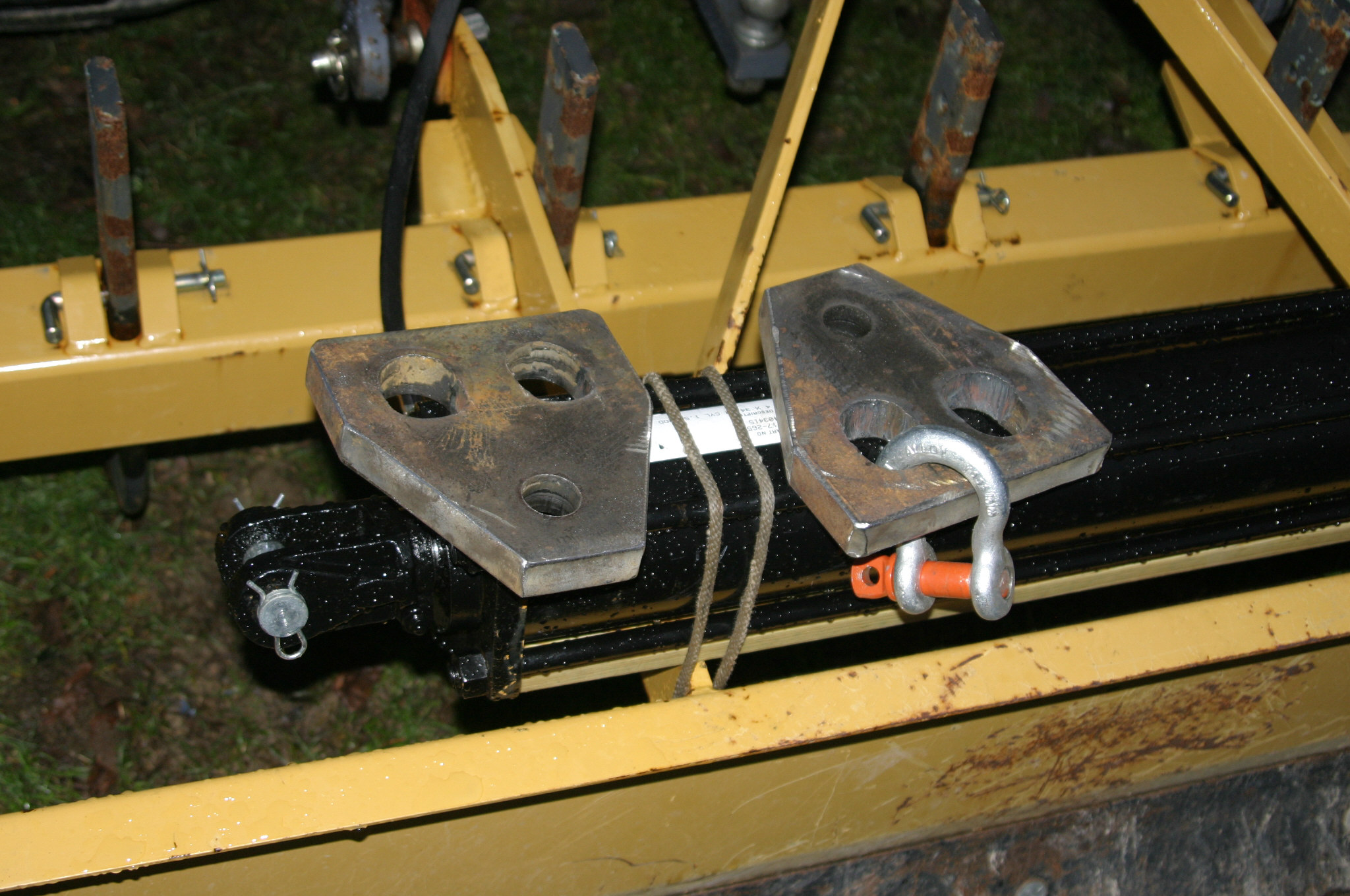

If you have 2000 psi, and your cyl, you have a pull force of 21,598 lbs, and if you have 3000 psi, you have 32,398 lbs.

How did you remove stumps like that, did you chain the tractor to another tree? I was just out there trying to drag the stump out to get rid of it and I can't even get enough traction to pull it out of the hole.
Positioning of the cylinder is looking like a hand-truck job now. It was just about what I could lift untill I put the plates and shackles on it, now it's hurt the back territory.. I guess the fluid weighs something too.
I need the hooks to arrive, had I pulled it completely out of the hole I'm sure I'd be able to drag it down the hill.

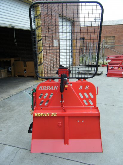

I wonder if the guy with the KRPAN forestry winch just uses his winch to pull stumps thru a couple of snatch blocks tied to another stump?

I have Farmi JL 601 which is a BIG winch and it is rated at 13,200 pounds, less than half of the pullng power of Jake's 28,000 # set up. You could use snatch blocks to get to that point, but the force on the tractor may begin moving it around.. and it is a BIG tractor.
