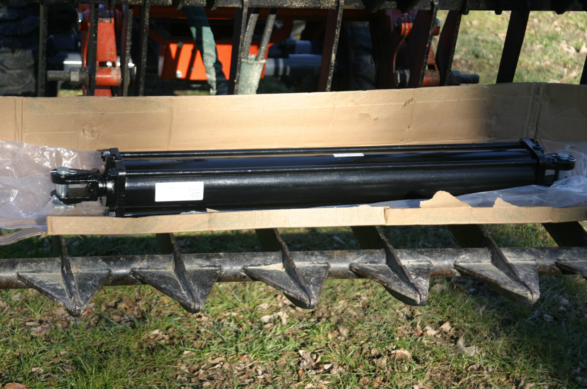

Hydraulic cylinder just arrived, waiting on the chain and shackles. I'm gonna have to get a couple yokes made for attaching them to the cylinder ends. Andy's setting me up with some long hoses and connectors. Let the games begin..

It seems to have a natural place to ride, thought I'd have to make a cradle but looks like a rope around it will do.. the weight of the cylinder plus the hundred something pounds of chains will be welcome back there. Still waiting on chain, shackles, hooks, and plates to join them all up.

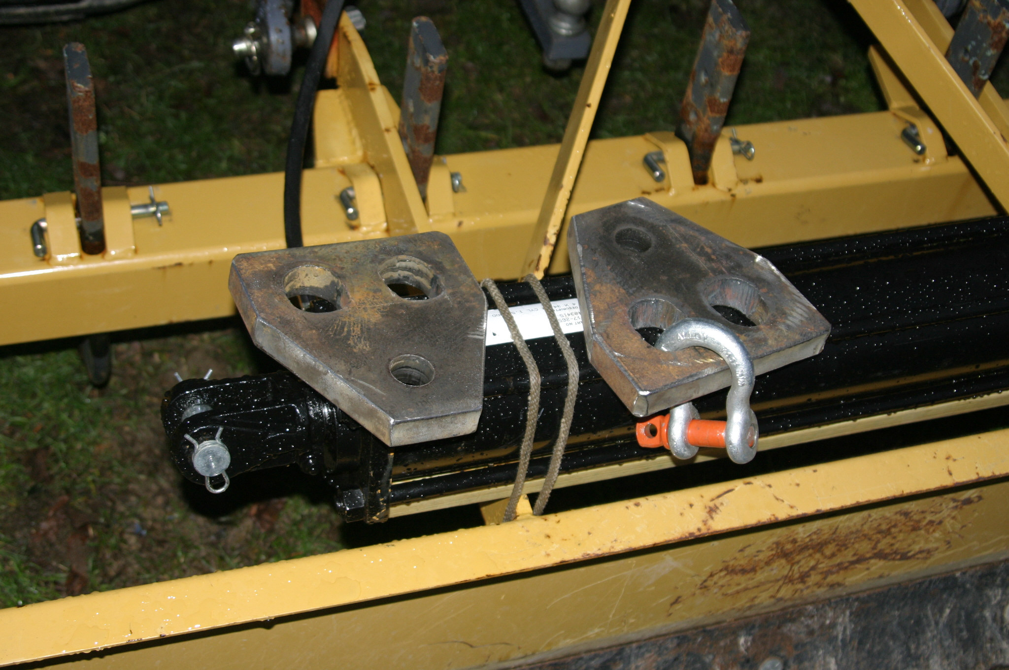

Had some plates made up today to go between the shackles and piston, the shear cuts that 1" like butter.. they punched the holes and elongated them with plasma, I guess I'll have to donate some blood. Hooks are back-ordered but the chain arrived. I'll have to use the wrap it around the stump method of adjustment for now. Anybody know the best way to cut 1/2" alloy chain?

/ stump speech #35
Comin' together!
Do I have this right: You're going to wrap a chain around the stump to be pulled, attach that chain to one end of the hydraulic cylinder, & attach the other end of the cylinder to another chain chained to another stump? & pull horizontally?
The cylinder will lay horizontally on the box blade as you showed while it's operating?
Seems like it should work ... if I have that right.
Now ... if you could modify your plan a little, by adding a snatch block: Pick 2 big "anchor" stumps close together, attach your end chains around those, & attach a snatch block to the stump-to-be-pulled (using a 3rd chain), I think that doubles (almost) your pulling power.
Either way I'm anxious to learn how well it works!

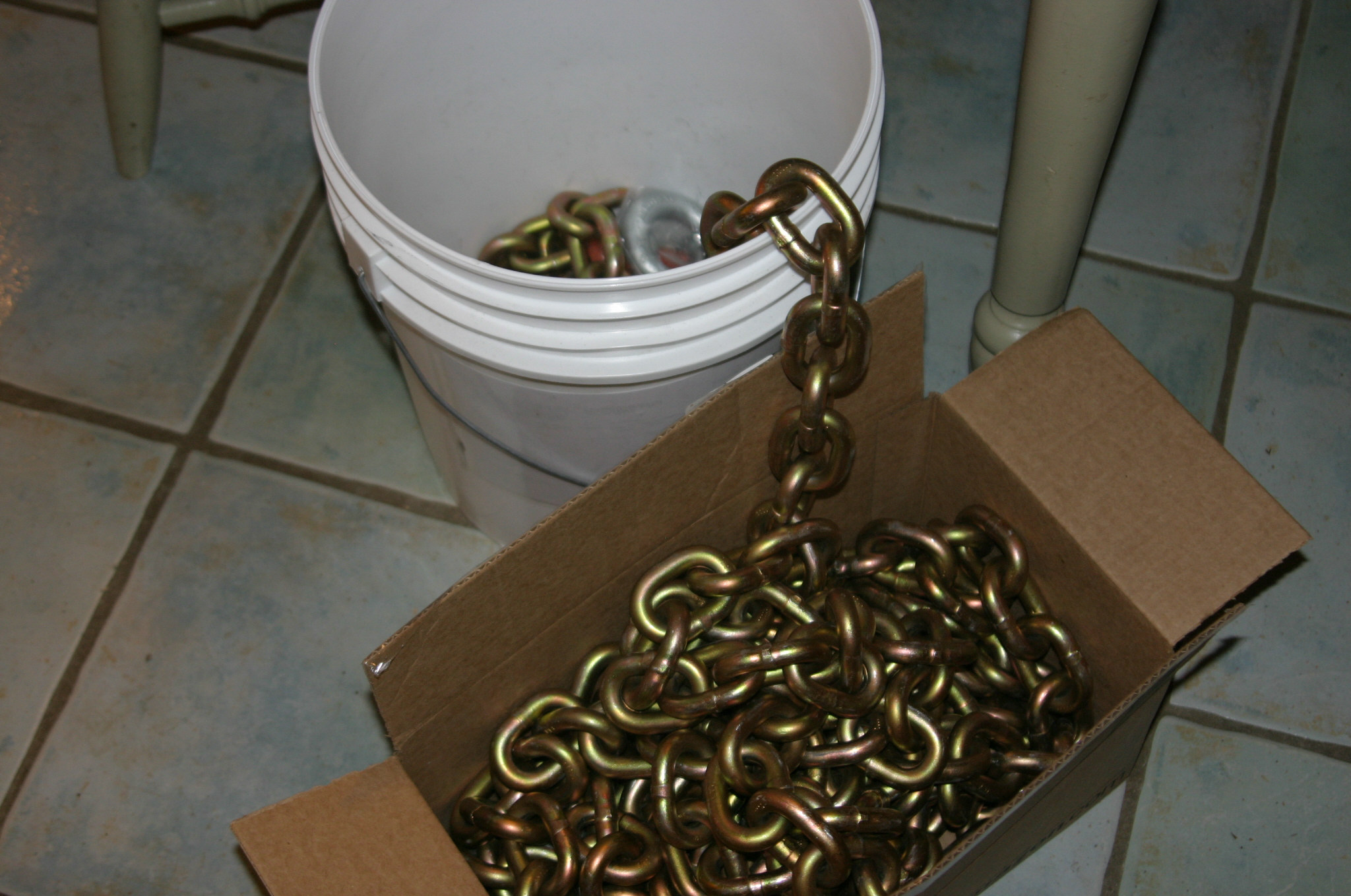

I'm just carrying it on the boxblade, I got 20' hoses so I can get out of the way..
The thing about chain is you need some big chain to take the force, so I bought 1/2" grade 70 and I'm gonna use it doubled. That almost gets me to the 28,000 lbs that the cylinder should pull, I'm counting on some safety factor built in, as funny as that may sound.
I think I have about $500. in it so far. Tomorrow I'll see if it works.

Here's the chain, it looks bigger in person..
