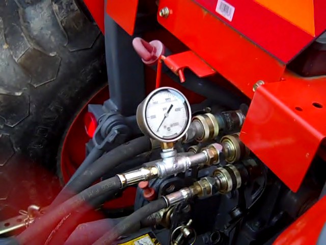

this confirmed the pressure, it was either 2400 or 2600, I have to check again, but holding 1000lbs. steady didn't seem likely, there was too much going on.

Well if nothing let go, your rigging job is prolly ok. Your tractor likely maxes out at 2,700 psi for the hyd pump, so you put everything into it you have.....

Whatever the high pressure reading was, I took it before I was pulling the stump, with the cylinder all the way out. When the stump was comming out I was juggling the valve, camera, thoughts of decapitation.., so I didn't really get to see what the gauge said, other than trying for a couple seconds to keep it at 1000. (it stayed over that when I let off the lever) There may be some more left. The chains were really tight.

I really can't see the reason to regulate the pressure. The resistance of the stump will dictate the pressure, and it may take it up to your relief pressure. If you should hear the relief kicking in, then just change your pull direction.
/ stump speech #117
Agreed, ole Jake is "over" thinking the pressure thing. Unless the cylinder is rated less than the tractor's relief valve limit, just let er rip..... Tractor will tell ya when she is giving all she has........

that was just so I could use single chain, but after feeling how tight they were I was glad there were two of them on there. Don't have much experience snapping chains but I bet 1/2" grade 70 isn't where I want to start.
