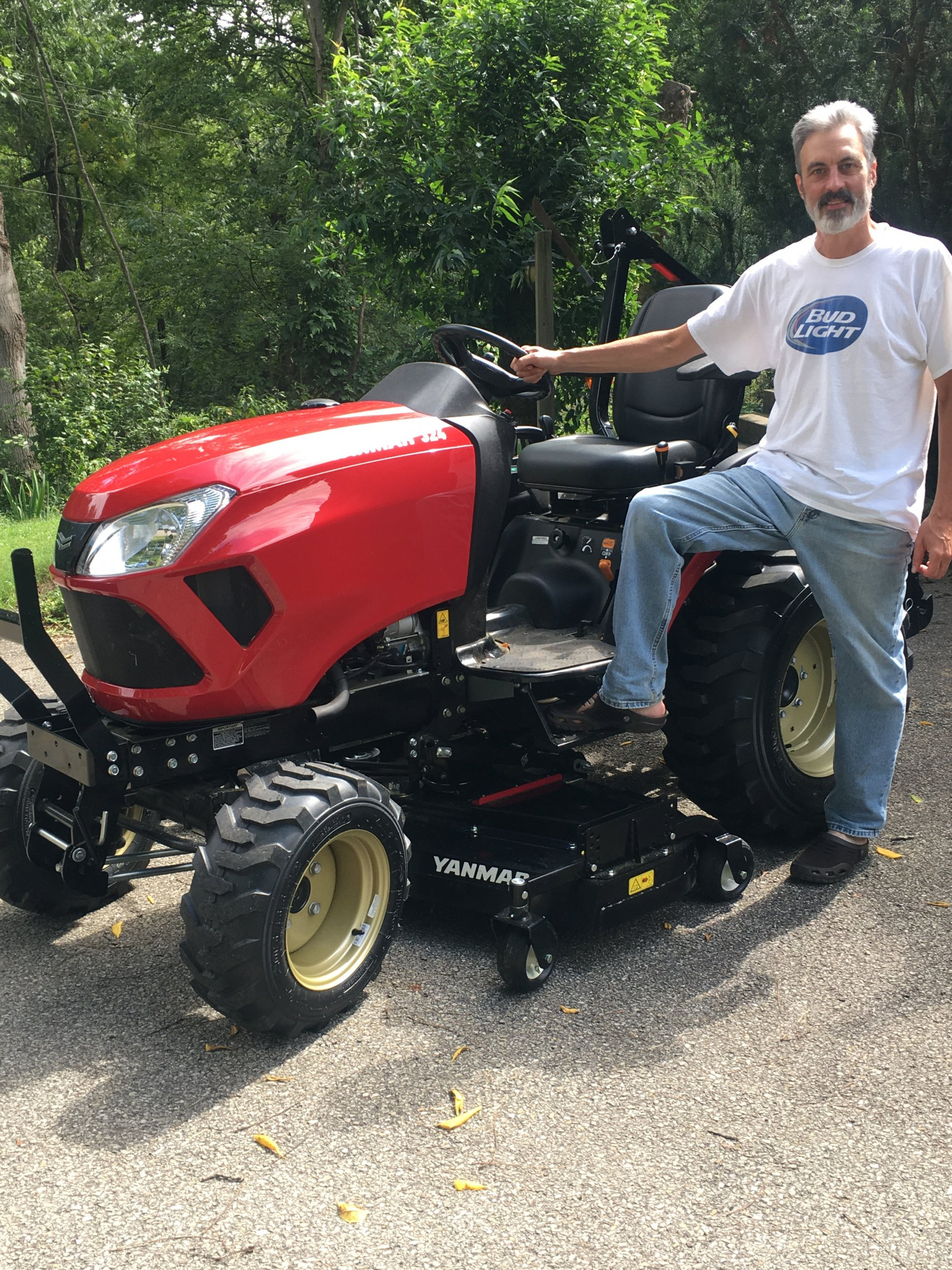

THe Yanmar 324 is a fine machine that I highly recommend.
I compared it to the B2601 / JD2025 and the Massey Ferguson 1526.
The Yanmar has a 10 Year warranty and was alot less $$. The JD is Yanmar-powered.
The others have a 3 range HST, tilt and speed control. Not enough to justify $thousands more.
My Dealer offered a "no-strings" tryout of the 324 for a week and gave a great trade in $.
