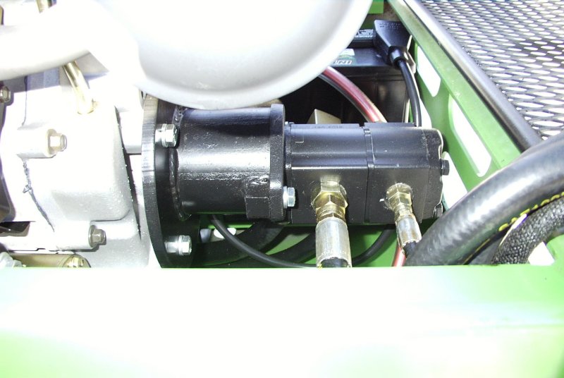

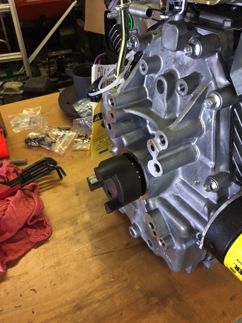

Someone will chime in about the lovejoy. If not, maybe start a separate thread with something like "how to align lovejoy connector" and someone will chime in.
Don't really see how it is possible for the pump to be misaligned, and don't see anyway you could adjust it.
The alignment between pump and engine is based upon the coupler and the bolting ring on the pump and engine. All of which are concentric. The most they can be misaligned is by the slop in the bolt holes, which should be on the order of a few 0.010".
I would put it up on blocks and solve your hydroback adjustment. Maybe that will solve the vibration.

Tim is correct from what my conversation was with the factory that makes lovejoys. There are of course ways you can get anything misalinged, but the design of lovejoys is so that they do couple correctly and any misalignement is managed by the rubber spider. If you have a new spider, and unworn couplers, everything should mesh up fine. Now if you have a soft spider (they make them) you can have things drift a bit.
But if you have a concern, a simple straigheede will tell you if your unit is aligned correctly. Spin the connection by hand, there sshould be no variance.
So here is a side story. I am sitting with my wifes cousin today on the patio having read this. He fixes Giga Yachts for a living (Boats over 150 feet). THey have tons of lovejoys. He taughe me something new which is in certain applications, ones where you continue to find wear on coupler (he equated it to an engine mated to a piston pump is one of the hardest things on a lovejoy). They have come up with a simple fix to reduce wear by offsetting the two devices by 1 degree. meaning the two shafts are not level all the way across but the pump or the engine is angled by one degree. This reduces wear. Go figure.
