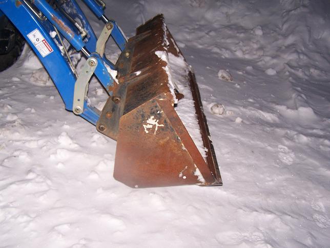

Here is a picture of my 5' bucket with the standard NH QA adapter. If you can approximate this position, it will probably be the best arrangement.
   / Switched 16LA FEL to Quick Attach #15
Your bucket looks different from mine, My back flat piece is only 14" and the top edge slopes up more at a steeper angle. Almost as if the back of your bucket is square and bigger and mine has less capacity because the top joins that back of the bucket lower. If that makes any sence
   / Switched 16LA FEL to Quick Attach #16
Maybe you have a standard duty bucket instead of the heavy duty one. I looked at my 6' bucket and it is the same shape as my 5' bucket. However, my 6' bucket is a HD pin-on bucket with a Kasco Uni-hitch adapter to make it a QA bucket. I have noticed the new 250TL loaders on the 23xx and 304x tractors have different shaped buckets, but your loader is a 16LA, isn't it?

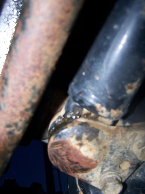

Here is a pic of the Loader bucket and a pic of the Tie rod and the last pic is where the rubbing is occuring.
The rub is directly below where the hydrualic steering assist pin is under the center of the tractor, minor damage.
As you can see it is a slight bow in the tie rod bar.
