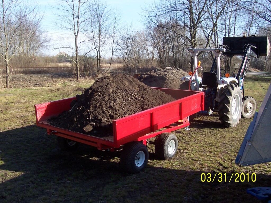

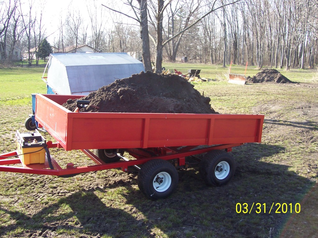

I finaly got to try it out today. The dirt was a little damp but not bad. The first time I put 2 buckets on for a test run and every thing worked as expected. The next load I put on 3 heaping buckets and that filled it pretty full. I can probably get 4 on it. When I dumped the hitch didn't raise at all but I will leave the stay chain on for safety. I am guessing I had a little over 2 ton on it. I am going to have to see if I can hang some weight on the TPH so I can dig into the pile with the FEL a little easier.

Very impressive trailer ,I like your approach ,look,think ,check etc.I'm not a CAD engineer but just at a quick look I dought if you could make the hitch lift if the end gate is open it would be difficult to get enough weight behind the rear axle to make it over balance.Correct me if I'm wrong.
   / Tandem axle wagon build #69
I use my Tacoma for pulling the little dump trailer when hauling dirt, I can see where you would have difficulty diggin into a pile with no weight on the back of the tractor. I'm guessing since since you have a tandem axle trailer then that is the reason your not getting a negative tounge weight when dumping...just a guess though.
