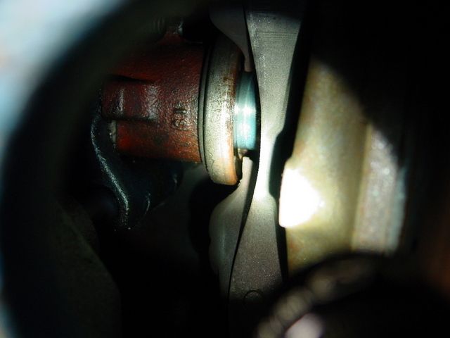

OK, here's an update. I finally got my new hydro coupler. removed front end loader. Heres whats boggles my mind. Now everything seems to be working normally.other than a more than normal pedal movement. I mean I can let the clutch pedal out and when it catches it will almost pull the front end off the ground. Crazy. I removed the inspection plug. about 1 1/4 size hole, from what I can see nothing appears to be broke. This tractor has 2 PTO outputs. one for the rear, and one for a belly mower, that isn't attached. Can having either one of these engaged cause the tractor to feel like its got a bad clutch. In my mind it shouldn't. I'm going to play around with the adjustment some now that its easier to get to with loader off. I check back in on how that whats out for me.

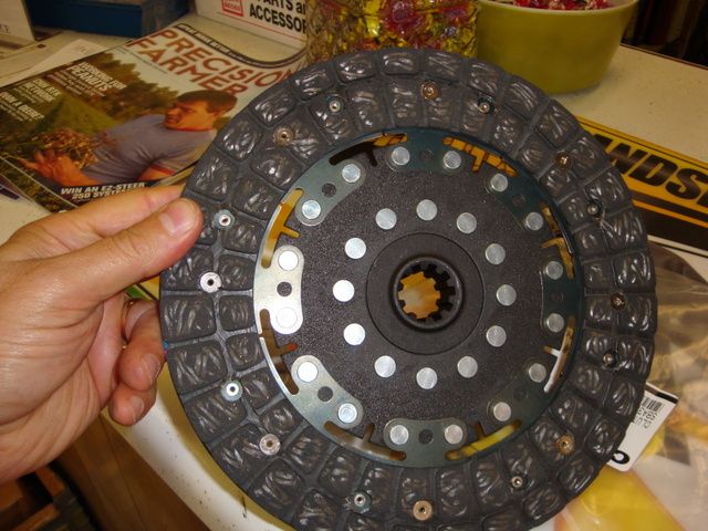

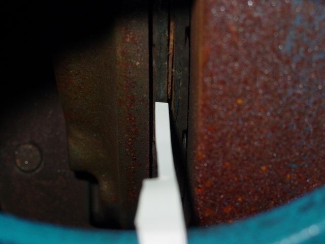

Can you do without using a loader? if so I'd be using it to see if the problems comes back and persist. when You inspected inside of bell housing could you verify single or dual clutch?. All might look good with clutch plate thinning out and potentiality slipping under certain loading. were able to verify visually distance between fingers on pressure plate and the release bearing? as clutch plate gets used up the fingers on the pressure plate rotate outward making them closer to the real ease bearing. On single clutch by rotating the flywheel slightly you can figure out clutch disk thickness by using a paper gauge and comparin git to oem disk.
JC,

From what I was able to see its a dual clutch. And to answer your question yes and no I can use it with or without the loader. I have a few things needing done, some I can use my 3 point implements, and the others I need lifting ability of the loader. I'll have to be more cautious of the clutch though.
Again, I am far from new to the wrenches, but am a rookie when it comes to diagnosing a tractor. I'll see If I cant get a pic of what I see looking thru the hole. Not much at all, It looks like the clutch pressure plate an,d such are about 4-5 inches thick combined. SO In my mind that would say to me higher possibilty to a dual clutch setup over a single.

Barry ,
Take a pic to see if we can decipher. Again, let's just say you are in second gear , pto on and you are slowly moving forward and then you press the clutch 1/2 way, in that fix ,does the tractor comes to a stop while the pto continues running? in a dual clutch jobby you will not see disk thickness like what I pictured on my 1700 above.
JC,

I'm 100% sure its a dual clutch. I tried getting a pic but the inspection hole is really to small to get the light and camera angle Just right. I saw 2 disc in there though. its really hard to see the actual thickness of the disc themselves.
