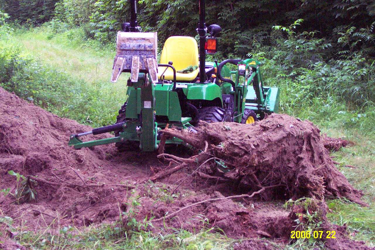

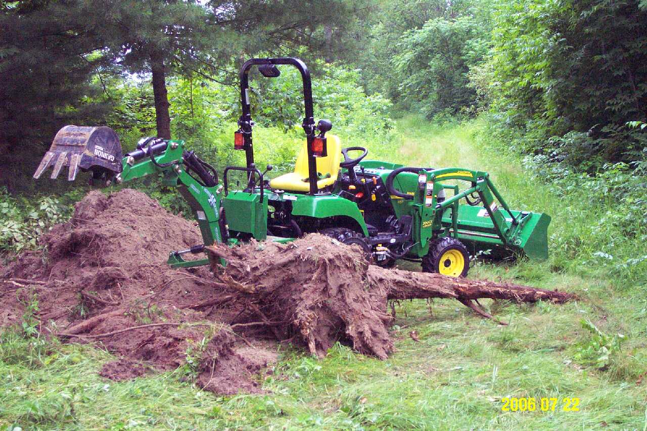

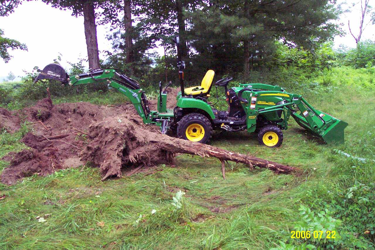

I have a 2305 with a woods BH6000 (Deere didn't make the 260 when I bought it) a FEL, 62D MMM, 47" front blower, chipper and lots of attachments. I also have a 3720 cab, FEL, 59" blower, etc.
You'll be plenty pleased with the 2305. Do consider the bigger 2320 and 2520 if you think you need it but the 2305 is a little workhorse. It'll mow up a storm and handles great and the high range is usable for mowing (It's not on the 2320 and 2520). The Deck is easy to take on and off, etc. The machine constantly amazes me with what it will do.
Also, the BH will do plenty of work. I've attached pictures of when I first got the BH. It just takes time to break all the roots, etc.
About the only thing I think would be a show stopper for the 2305 is if you need lots of ground clearance or more FEL lift capacity. If so go with the 2320, 2502, or 2720. The 2520+ have faster hydraulics but it's all a balance. The 2305 will feel the most stable mowing and you'll zip around like you wouldn't believe.
Also, that's not the tree sticking out on the Fel, it's one of the roots of the stump. I've also taken out much bigger ones with that BH. Maybe up to 24-28" in diameter (Took forever). Now I don't use it much for that since I have a stump grinder I put on the 3720 (Does a quick clean job without leaving a huge 'crater').
The BH is great for trenching, etc. I even dug through frozen ground in the winter once on the 2305 to uncap my septic (which needed to be pumped [frozen pump]).
