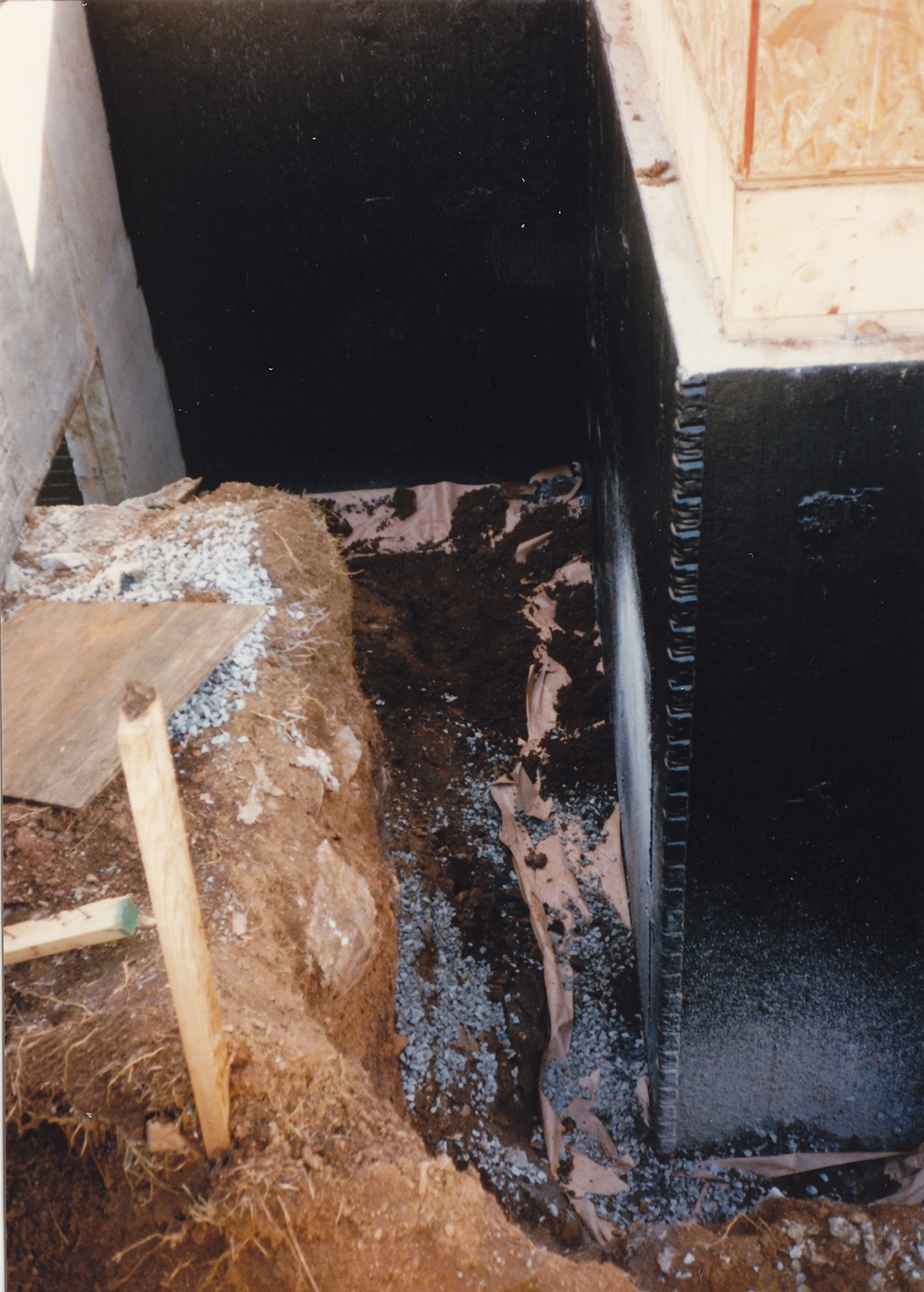

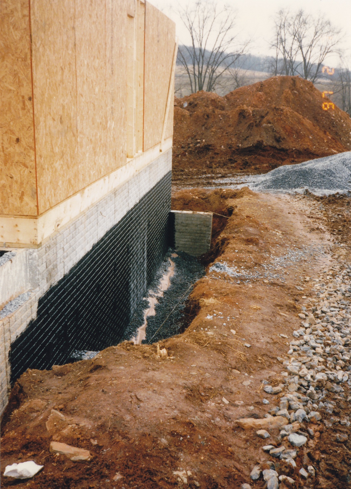

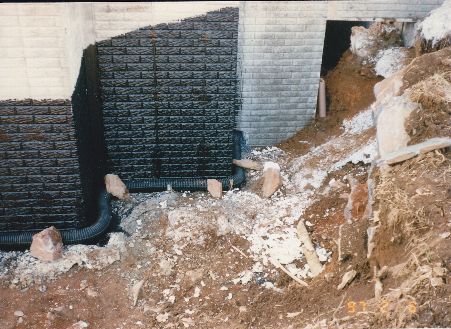

19970206 - Thursday - foundation drain
Took off from work. Dug dirt out from along front wall with shovel and installed corrugated pipe with slits for foundation drain. Used rocks temporary to hold pipe in place, then added gravel over pipe, then covered with Rosin paper.
East side of house
Under east porch
West side of house.
Foundation guys had foam in wall forms to provide hole in porch wall for the drain pipe.

I clearly remember that process with my first house in 1979. I used perforated rigid sewer pipe. My gutter troughs also dumped into mine. I also dug mine down until the top of the pipe was at the elevation of the seam between the footing and the poured wall.

Now they have socks that go over the drain pipe to filter. I guess they still cover in gravel. All the gravel under the porch I used a wheel barrow and dumped it over the edge. I didn’t own a tractor and FEL yet. Didn’t have the money. Still got a little of this drain pipe sitting behind my shed.
I doubt this drain has seen any water. Most is under the porch slab, and the garage.
I put underground drains to carry most of the downspouts away from the house.
One thing I didn’t do that I should have, is put a floor drain in my utility room.

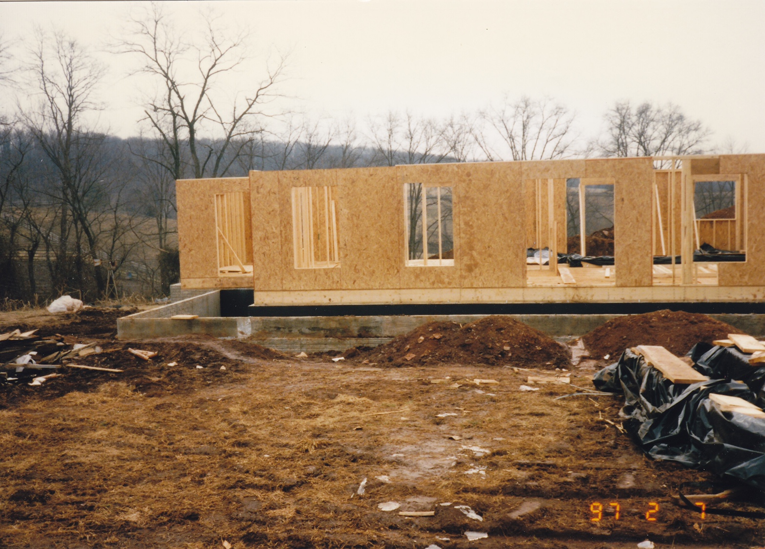

19970207 Friday
Passed Backfill inspection in AM, then excavation co back filled around foundation. They dumped more gravel over foundation drain first. I had work meetings to attend.
