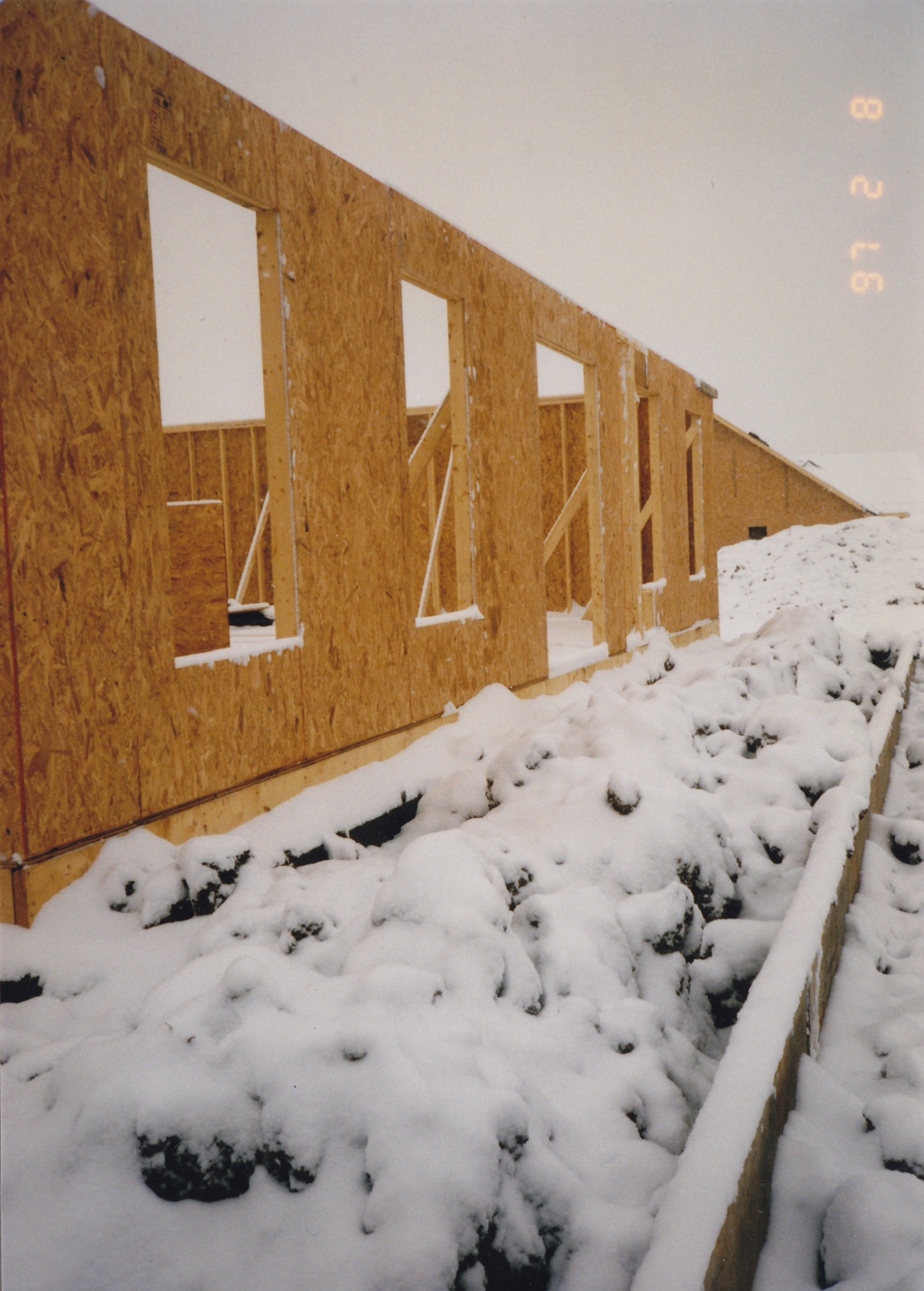

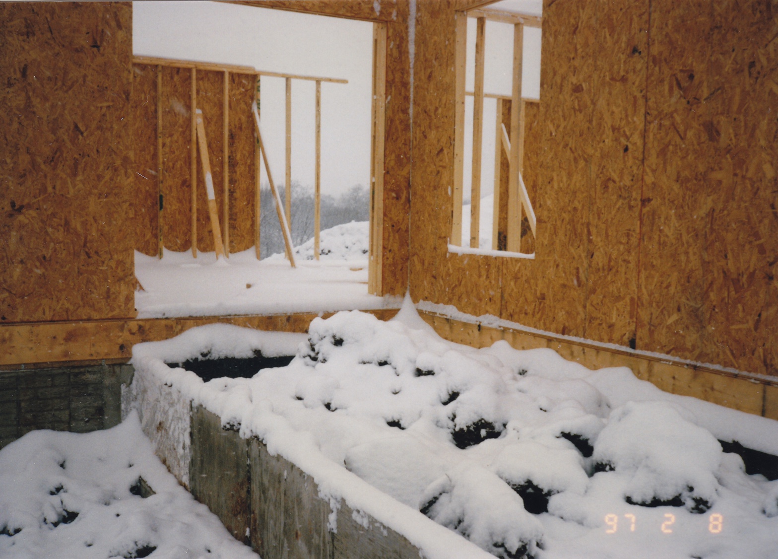

19970208 Saturday 6” of snow
Worked in basement under the deck.
Installed joist hangers.
Used transit to level the basement columns.
Shoveled snow off house deck.

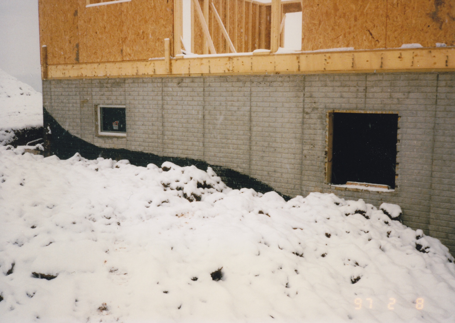

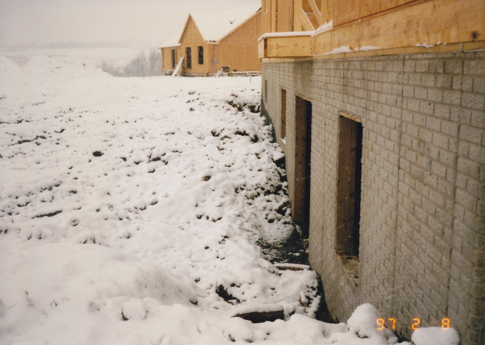

Discovered a crack in the back foundation after the backfill yesterday.
No more walking the bridge across the moat.

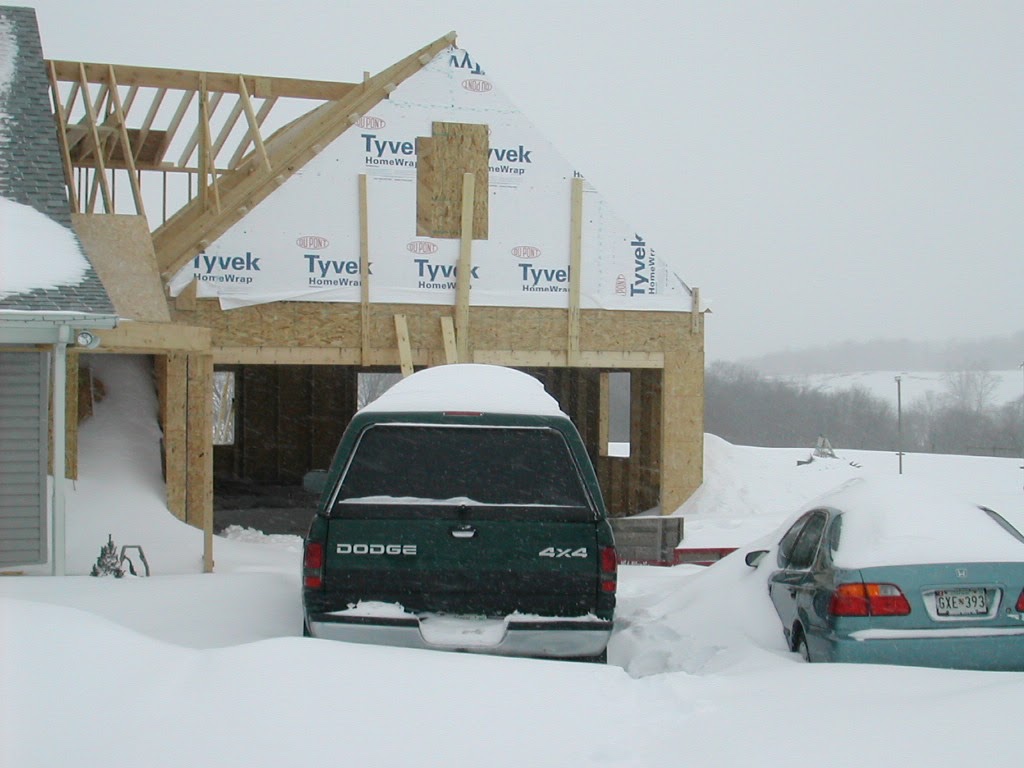

   / This day in 1997, of my house build #122

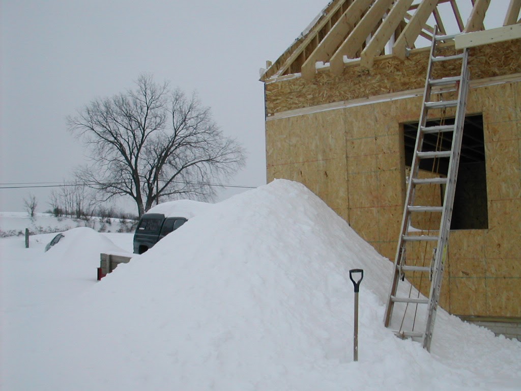

Had to scoop mine twice. Didn't worry me much being on a slab. But it was a pain to do. Both times I got lucky and had warm sunshine to finish cleaning the concrete.

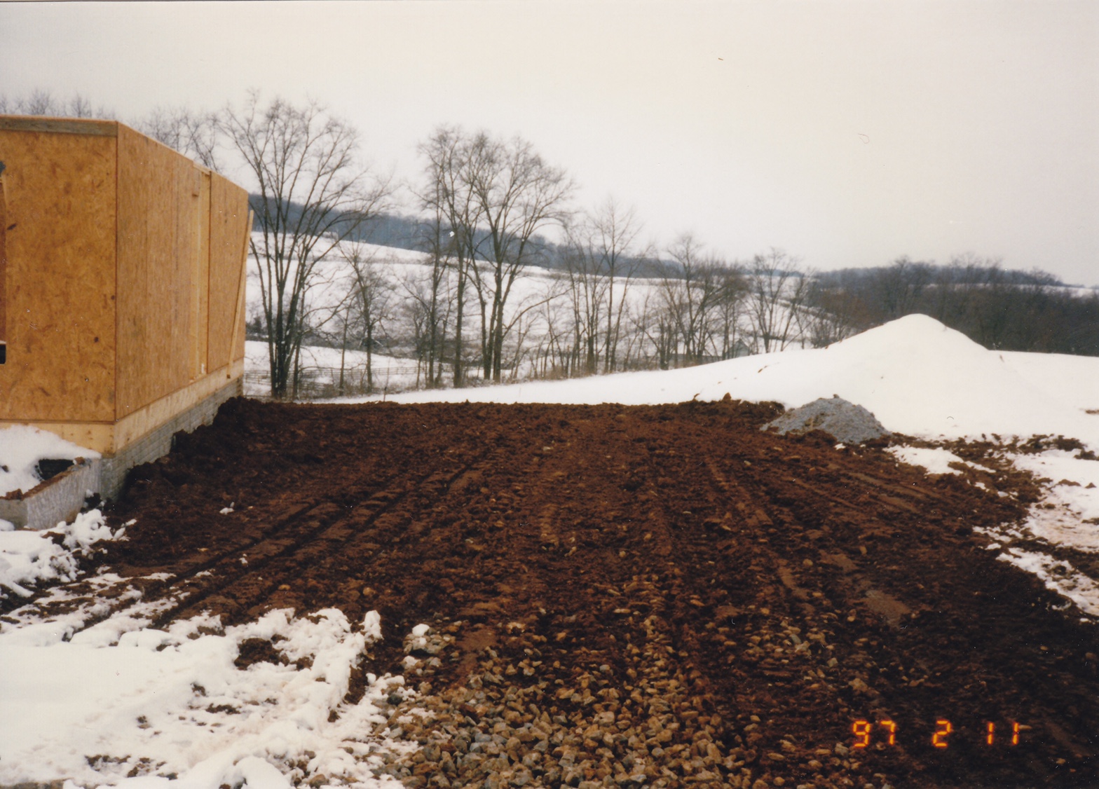

19970210 Monday

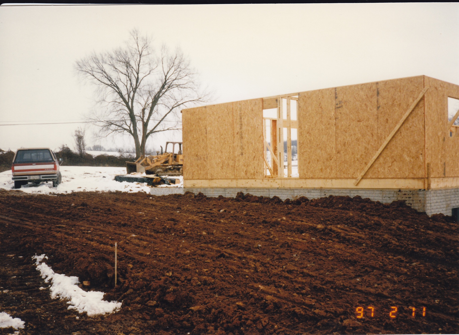

Excavation co back filled on west side of house. Pic from next day

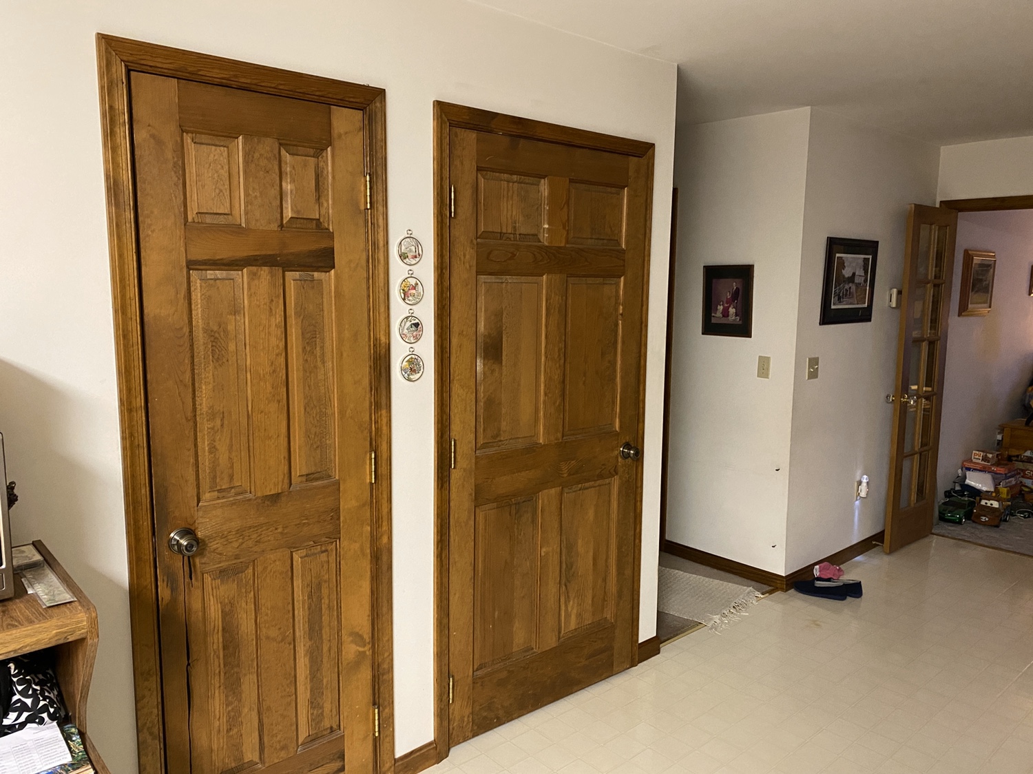

19970211 Tuesday
Took off work.
Finished framing center wall and stood it.
Built headers for doors and openings. The garage foyer and front hall openings have headers above the wall, and joists are on hangers from the headers.
Start frame the upstairs opening.
Opening with osb standing is front hall. To left is basement door. To left of that is pantry.
