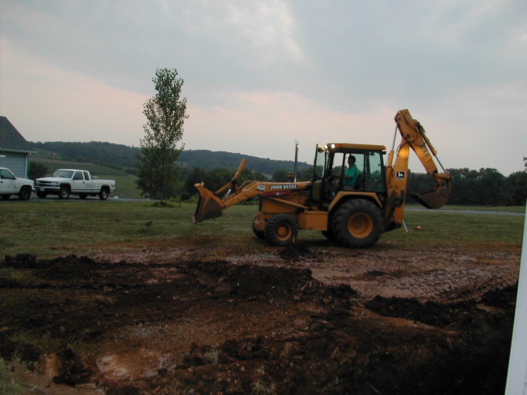

20020630
My neighbor borrowed a backhoe and dug my footers for me. Here I am moving the dirt out of the way.

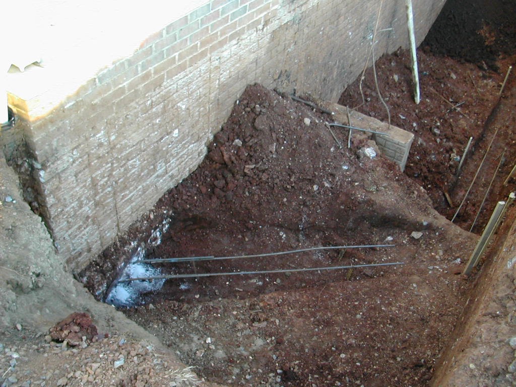

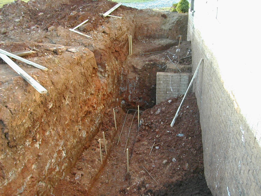

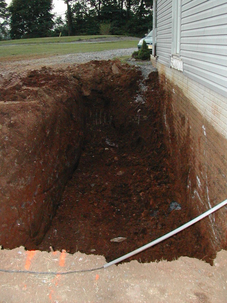

20020711 garage foundation
Dug down 8 ft for house side garage footer to get to solid ground, creating a basement addition.
   / This day in 1997, of my house build
#604

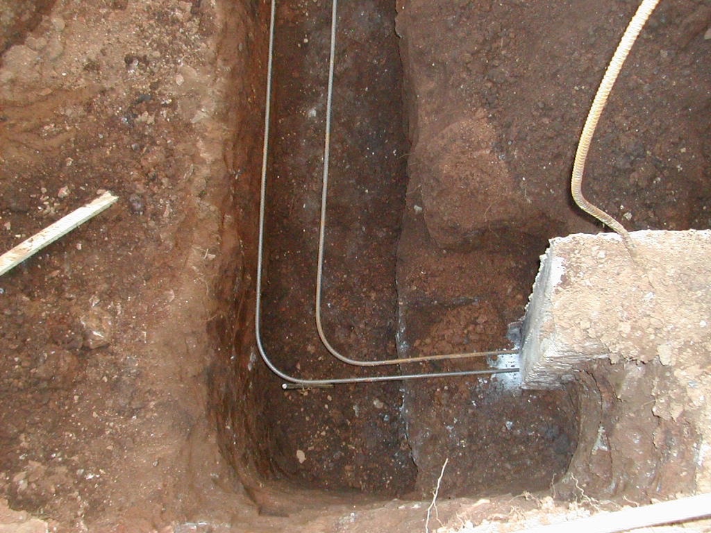

20020711 Garage footers
Original basement had stub outs to tie into garage.
Tie into porch footers
Tie into back wall
