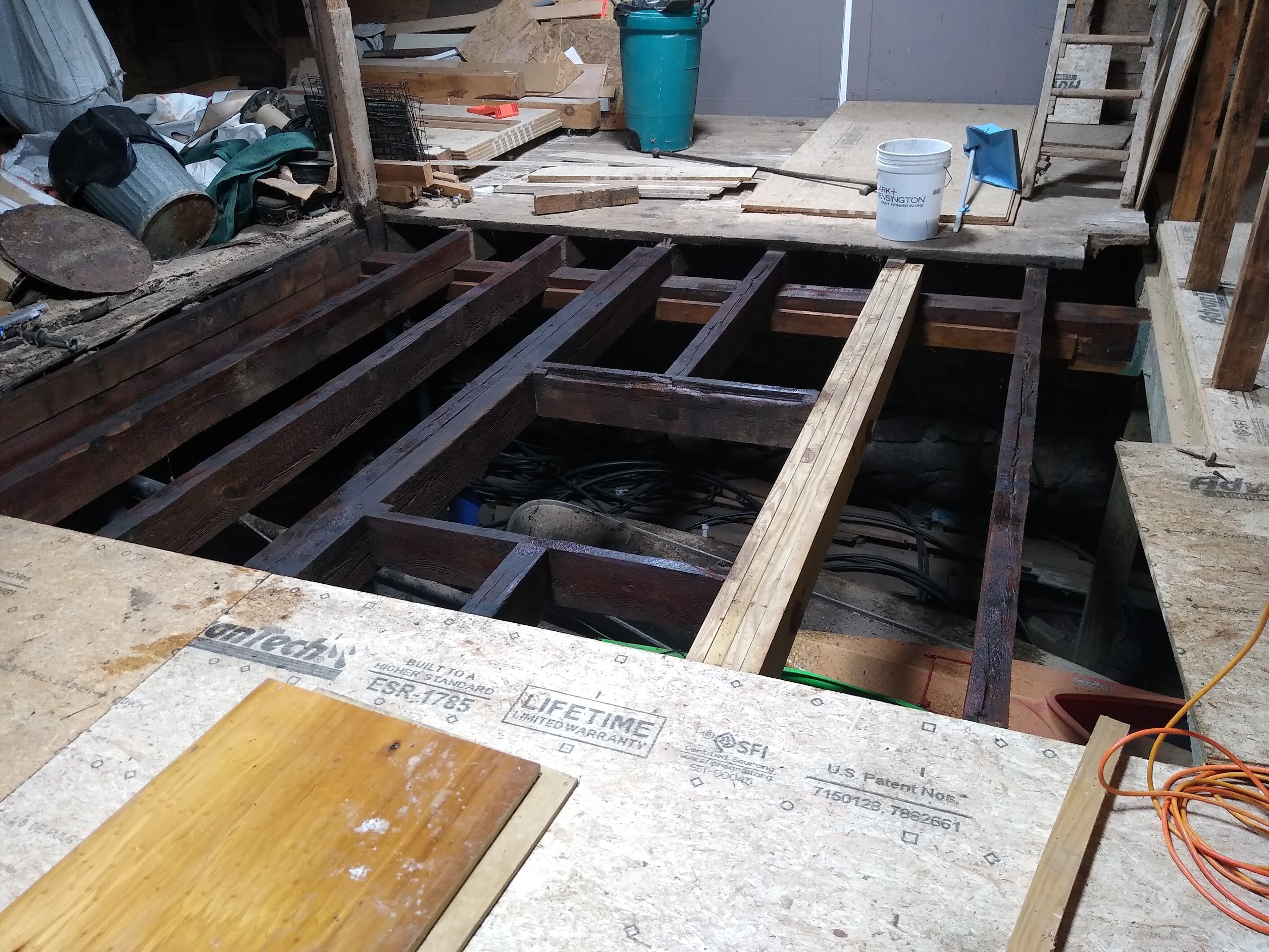

I got a little more time today to work on the floor. I'm working on the section that has the trap door, which I talked about way back in post #30. I had done all the repairs to the framing with the floorboards on because otherwise I would have had no place to stand. This is what it looks like with the flooring off.
667587d1598492867-old-barn-barnfloor7-jpg
Since the cellar is just fieldstone it can be a bit damp at certain times of year, so I'm treating all of the old framing with a borate solution to inhibit rot and insects. But the inside of the barn is so dirty I can't get it to stick unless I wash the wood first. This picture was after I had washed the beams and applied the borate solution which is why everything is so shiny.

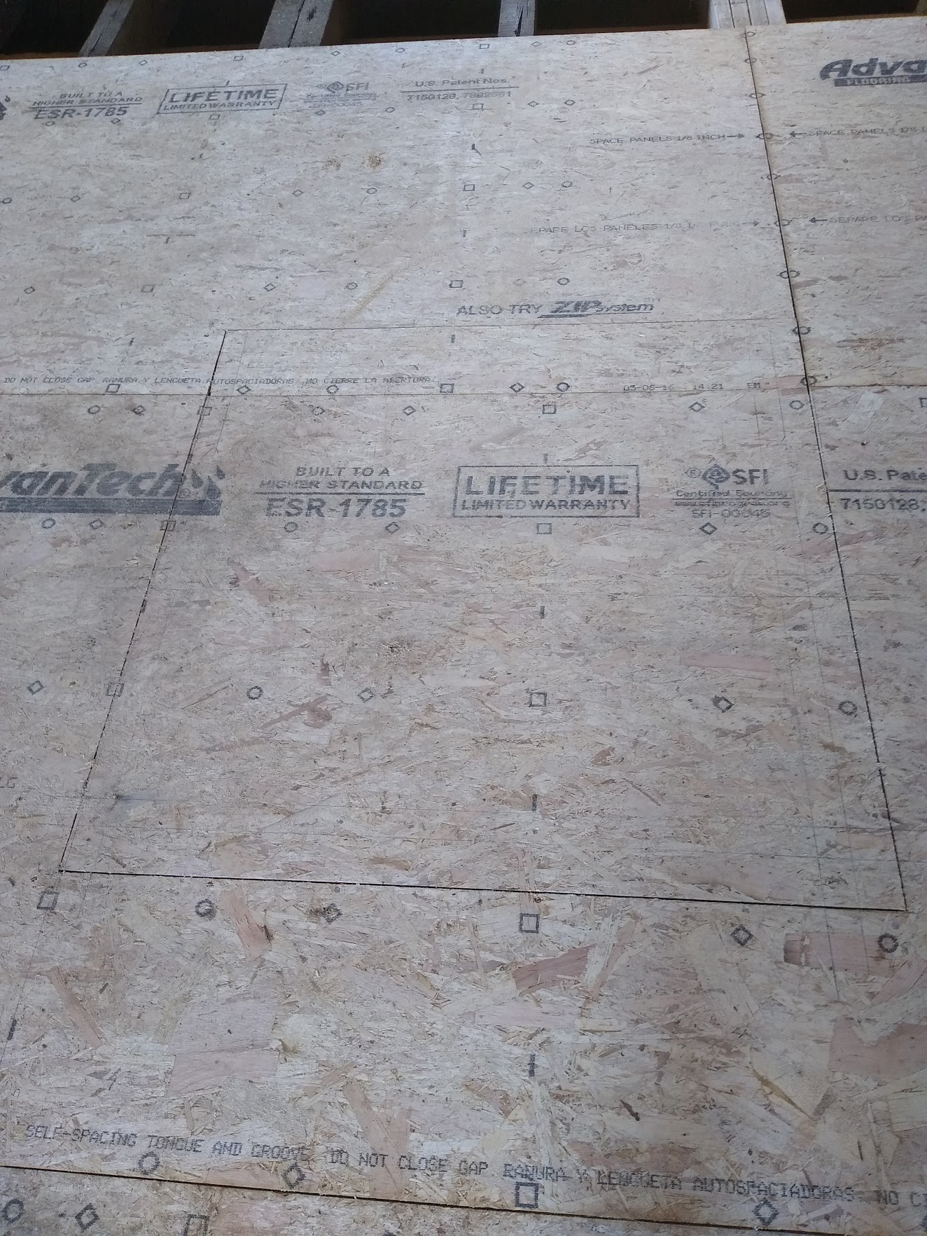

I decided to keep the trap door operable, so I made a frame out of 2x4's and cut a hole in the Advantech. I doubt I will ever open it but I do feel an obligation to preserve as many historic details as I can. Using the Advantech was a big compromise for me. I actually looked into getting rough cut 2x lumber, and at the time it was only slighly more than the Advantech, about $1.30 per square foot compared to a dollar. But rough lumber just doesn't make a very good floor, cracks will open up with time, it's hard to sweep and it's not going to be level. Advantech is really good stuff, with the tongue and groove edges it joins together into a solid sheet that is a nice solid floor. I believe that the best way to preserve historic buildings is to make them useful, and I intend to use this building.
The trap door isn't much to look at from the top, it's just a square cut out of the flooring. If you look carefully you can see the pencil marks I made where the 2x4 frame goes under it to guide my nailing. It's a conversation piece, I guess.

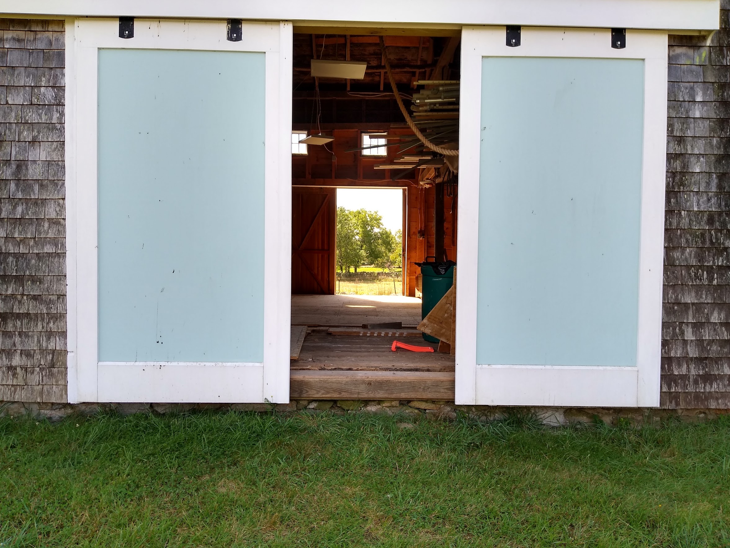

This barn is of a style known as a "bank barn." It has a cellar, and the floor of the cellar is at the original grade. When the foundation was built a stone wall was built and then dirt was piled around it to make a ramp to the first floor. The first floor has a door on each side, my understanding is that hay would be brought into the barn in wagons, unloaded into the lofts and then driven out through the opposite door. Here's a picture:
668455d1599096830-old-barn-barndoors-jpg
When I got the barn the sills were even with the ground, the previous owner used to drive tractors in. On the south side the sill was quite rotten. One of the things I did, years ago, was to use the tractor and box blade to take almost a foot of soil off of the ramp on each side so that the sills are now up off the ground.
The picture above is of the north door, looking south. I built these doors five years ago. They look just like the doors that were there which were badly rotten. The doors on the south side are vertical cedar tongue and groove, which is probably more historically accurate. When I built these doors I wanted them to last so the bodies are made of a sheet of MDO and the trim is Azek.
Each door is 8'8" high and 4'8" wide -- bigger than a sheet of MDO. To make up the extra space I added 4" strips along each side and an 8" strip along the bottom. Across the top is a 1x8 piece of Azek, along the sides are 1x6 pieces and the bottom is 1x12. A piece of 1x4 is attached to the left door to cover the gap where they meet.

On the back the joints are covered with a layer of 1/4" plywood. The whole sandwich is 1-1/2" thick and held together with glue and 1-1/4" deck screws from the back. The Azek is glued together with Azek glue. Along the outside edges and the top there is a piece of 1x2 Azek to cover the seam.
There is a wooden box that covers the track. I have replaced both the north and south sides. On the north side I used Azek and on the south side I used pressure-treated trim boards, an experiment in which is more durable. We'll see.

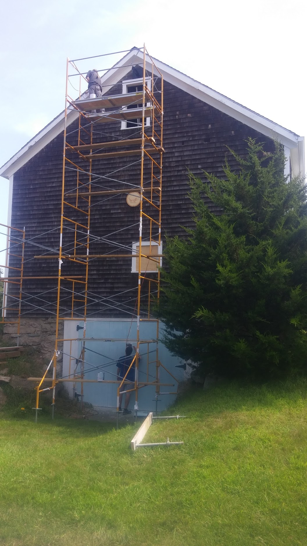

Once the joists were gone, the next issue I had to deal with was the sill along the west wall of the barn. If you remember the picture I posted in the very first post in this thread, there is a drive-in door to the basement in that wall. There are also two windows in the wall. At one point one of those windows had leaked, and water dripping down had caused the sill to rot where it went over the door.
In this picture, the sill is the piece with the notches in it, that's where I took out the joists. A previous owner had put a 6x6 Douglas fir beam under the sill and set the ends onto the stone foundation. That beam had sagged about an inch in the middle, so I put the jack post in that you see to try and take some of the sag out. Unsuccessfully, it turned out. But there was no way that old sill was going to hold new joists.
