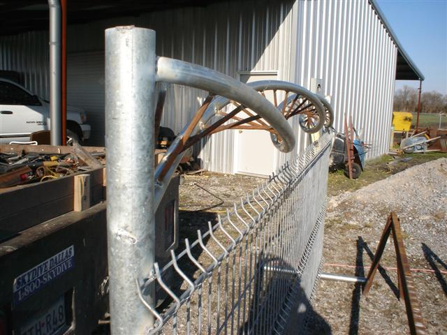

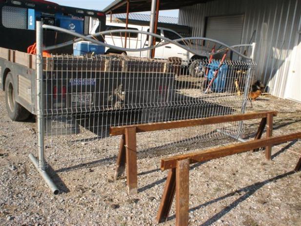

Then it was a simple matter of putting it all together so the scientists and their buds could see and touch a sample of what I had in mind.

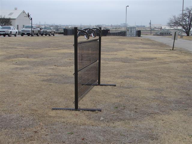

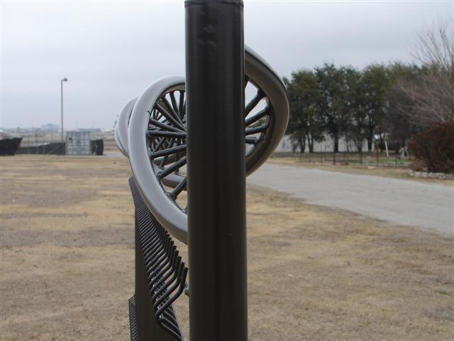

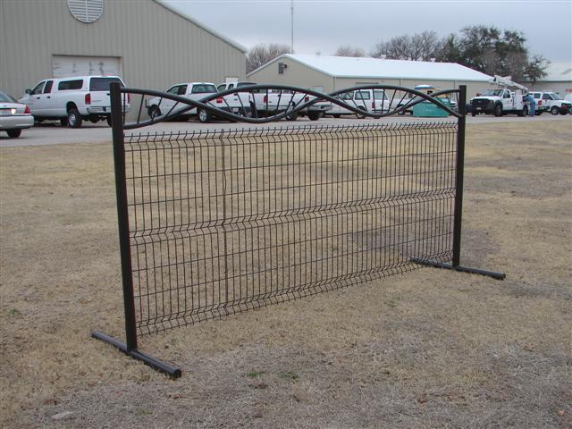

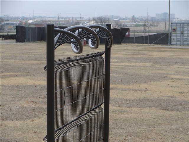

The hiccup in the get up of course is I'm not interested in fabricating and installing thousands of feet of fence. I don't have the resources to contract with government entities. I don't want to become a fence company capable of doing that. And I'm sure as heck not interested in building and installing it by myself.
So I've went to a major fence company and they agreed to work with A & M and I'd get a designer fee and maybe a consulting kind of thing.
We had the sample powdercoated and delivered it to the facility.

No good deed goes unpunished.
A & M loves it and wants numbers to see if they can afford it.
Fence company calls me with a hiccup. Everywhere they send pictures of the sample they get the same reply. "It's pretty. We can't do it."
Today there's supposed to be a meeting with the people at A & M and the fence company, yeah, me too. If they go for it it looks like I'll be supplying the double helix pieces for the installation.
It could be worse. I could be having to become a fence company.

It's always amazing to see what you come up with. Until I saw the sample pics of it powder coated, I didn't have a clue how it was going to look.

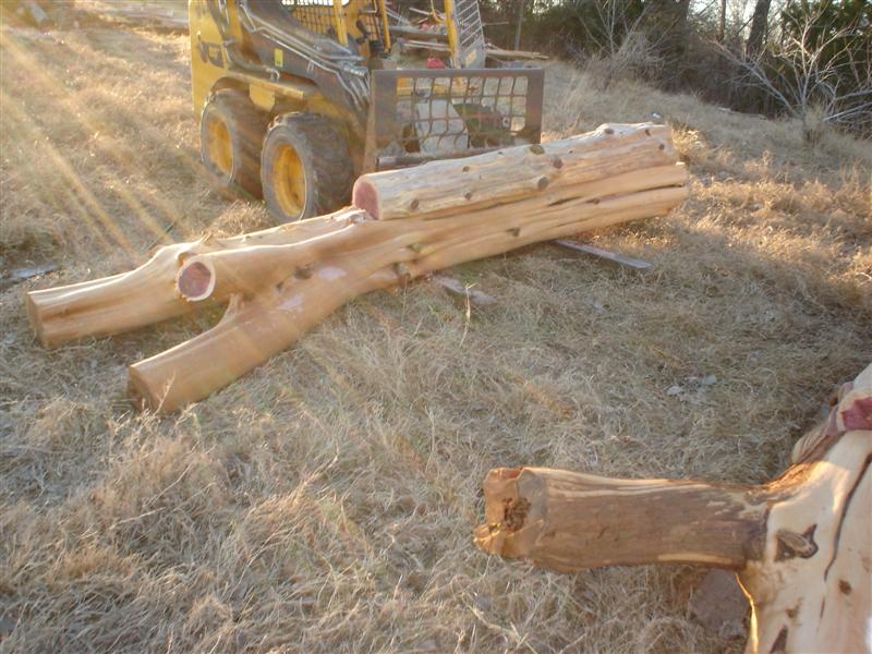

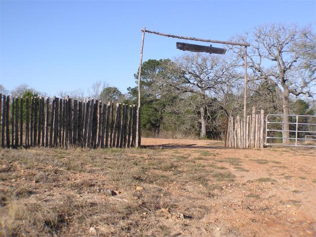

Did you finish the cedar post entrances? I'm dying to see how the second one turned out with the rock base and forked posts holding up the cross beam.

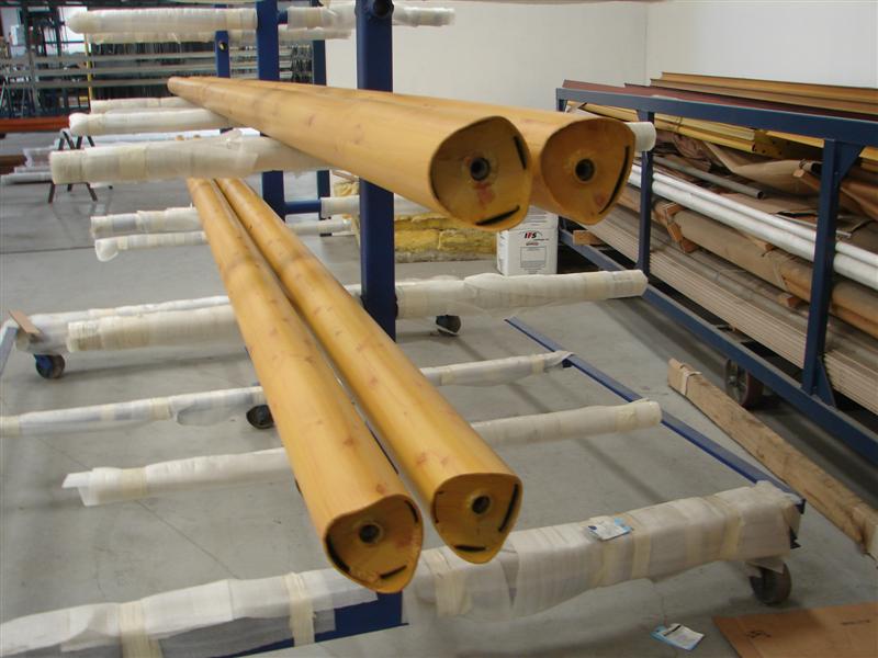

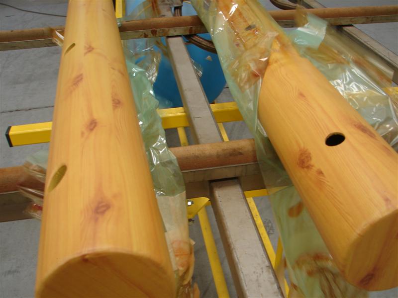

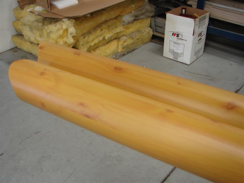

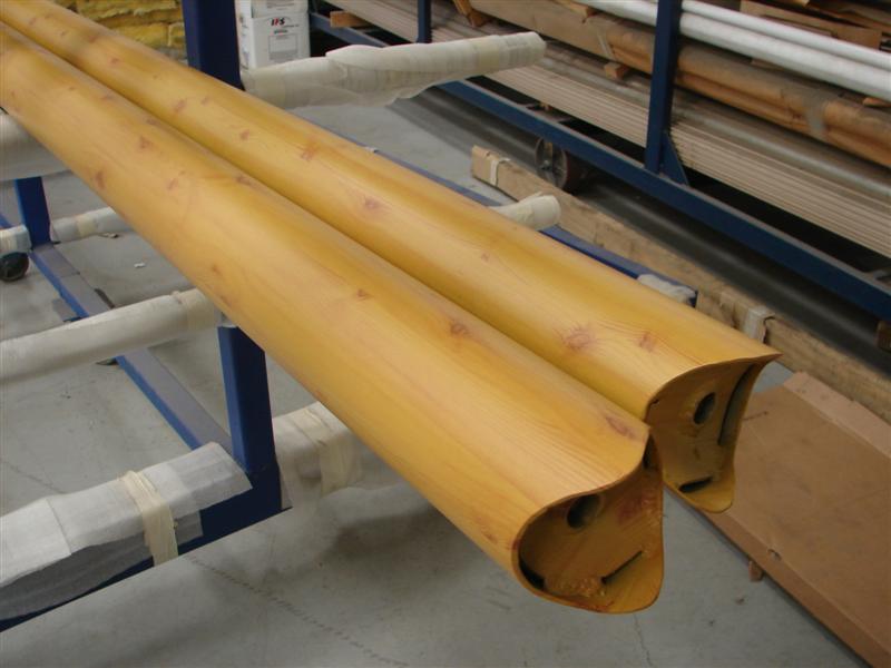

Eddie, I've been going seven different directions and all of them without a map. However, I've got the powdercoated gate assembled and I'll try to get some pictures of it tomorrow.
Here's some photos of the pieces at the powder coaters.

I really thought the first pic of the gate was wood. How do they do that? You could actually make a steel building look like a log cabin with no maintenance.:rolleyes:

I think we got ourselves a sell. They loved it. As I understand it's nothing but a matter of getting it through the channels and into installation mode.
Thanks for all the compliments. Once again we got lucky. And as we all know, I'd rather be lucky than good. Anyone can be good, that only takes effort.
Now before you pooh pooh my lucky statement consider a couple of things. The idea of a DNA strand luckily came to mind when I was thinking about a theme for the center. I was even more fortunate to have a roller that had a character flaw. All I had to do was adjust the flaw into an attribute. We went from resisting spiral to encouraging it.
Let's not forget that the spiral we got happened to be exactly the spiral we needed, three hundred and sixty degrees in ten feet. That was pure luck and I'm proud for it.
The way it will work if it goes as planned is the fence company will ship the pipe to me along with the three eighths inch rod. I'll cut, twist, and fabricate the DNA strand in ten foot sections. The fence company will pick up the completed pieces and then ship them to the powder coater and then install the fence.

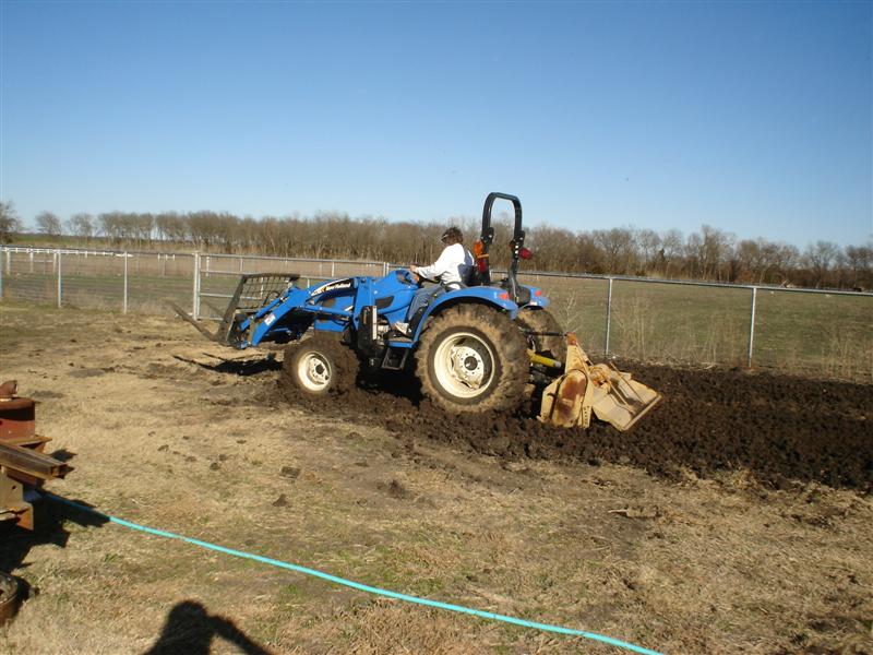

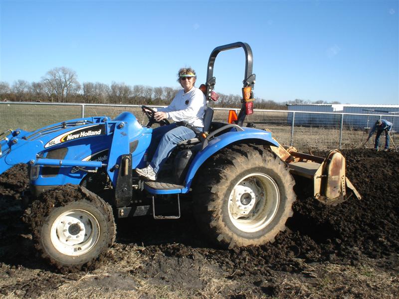

Jim, here's a photo or two for you. I thought you and Don might recognise the tractor and operator if you looked real close.

I've got a bunch of pictures of the process of the wood grain powder coating. However, since it's a new process they allowed me take pictures but asked that I not explain the whole thing, especially with photos.
The way it works is the pattern is on a paper more or less. The material, this instance, pipe, is powdercoated twice, once with a silver base followed with another color that's the real base coat. The paper pattern is attached via vacuum to the material and then it's baked on. The paper is removed and voila, wood grain.
What was extremely interesting to me was Roland (the owner and bud of Red Rocker) explained that if I made the gate out or aluminum instead of steel they could guarantee the color for twenty five years due to the cleaning process they use for aluminum.
That got my wheels a turning let me tell you. I could make gates that could be shipped across the country and installed by professionals or handy individuals that wanted the look of wood with the strength and longevity of aluminum.
