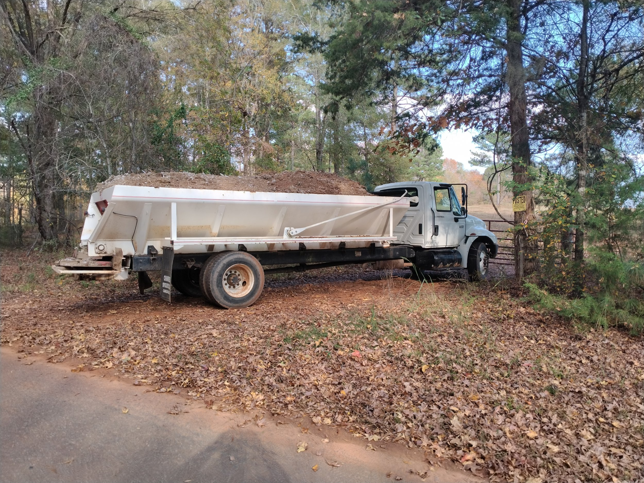

I wanted to put a bed on a road tractor that typically has way more power. I decided I could live with a 245 hp for what it would cost to put a bed on a truck.
   / Thoughts on 02 F450 dump #136
I can NOT find a used 12’ dump bed for my IH truck restoration project.
New dump beds start at $12,500 then you need a PTO pump and all the other crap.
I may punt, shorten the wheelbase a settle for a 10’ bed. There’s some used ones around.
