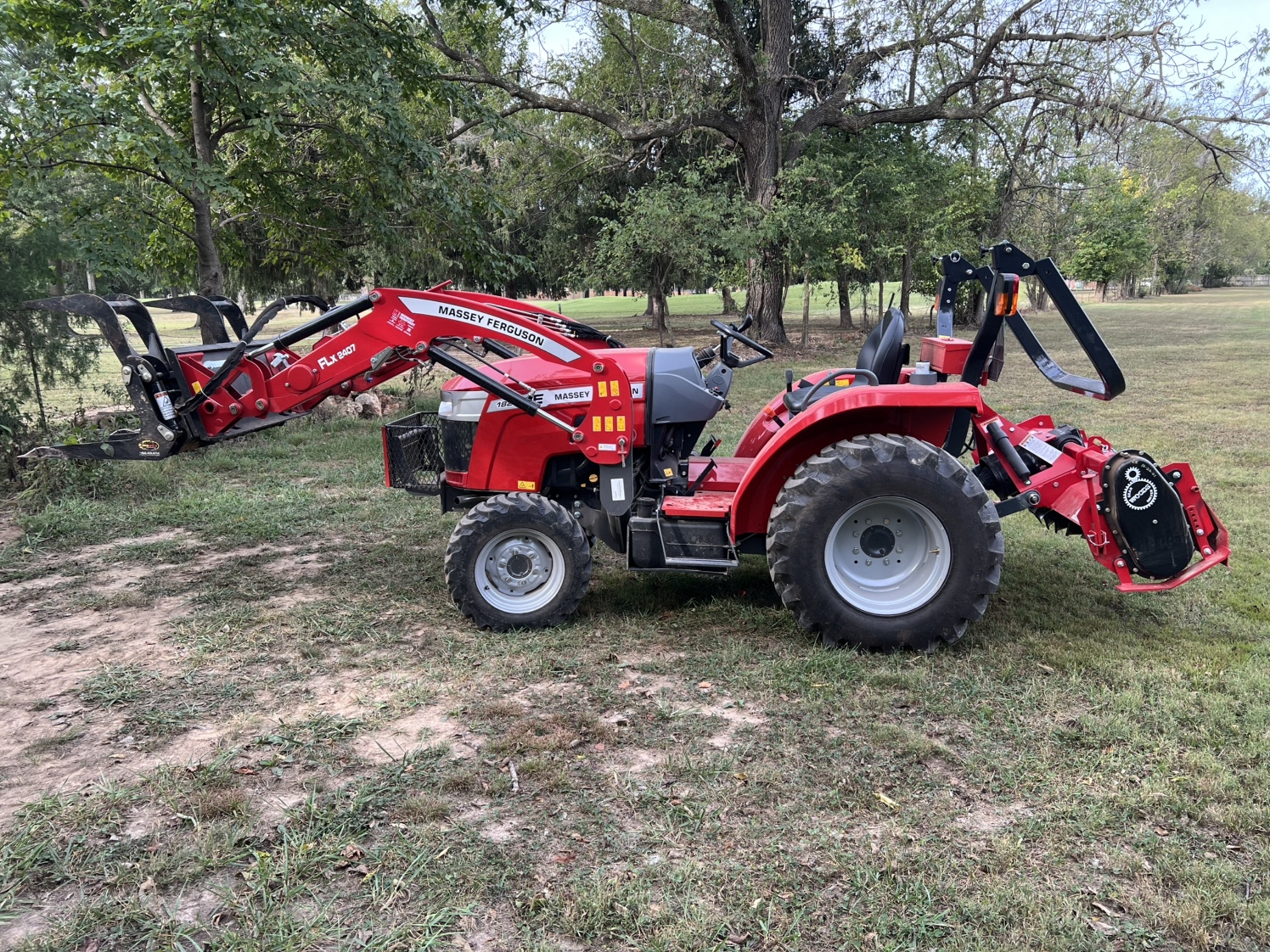

I have the same tractor as you and I have a Woods [emoji6][emoji[emoji6][emoji6]]” tiller. It’s a great combo, I don’t till much or have much to compare it to besides my John Deere with a tiller.
Yes very nice. Woods tillers are good implements, the problem that I have is the price, for a 48" inch tiller they were asking me $3,000.00+taxes. I understand they're high quality but you can find other implements just as good at half the price. For example I looked into the Caroni brand, it has everything the Woods has, except Caroni is chain driven tiller. Caroni is a good company, located in Italy. The price for the 48" in. is $1,750.00. Also I forgot to mention that I only have 3 acres of land, that my wife and I cultivate for our self and it only requires 15 to 40 hp at the PTO.
