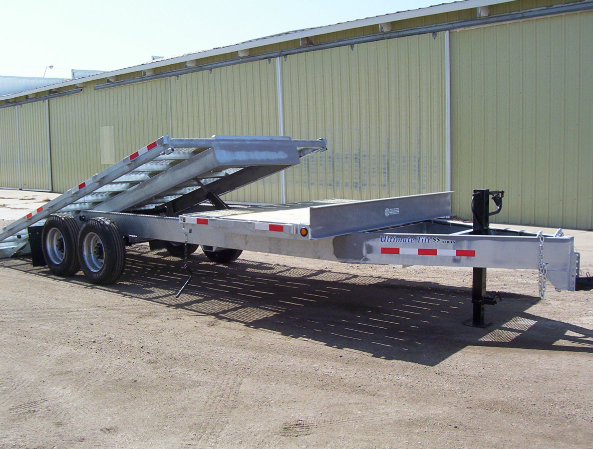

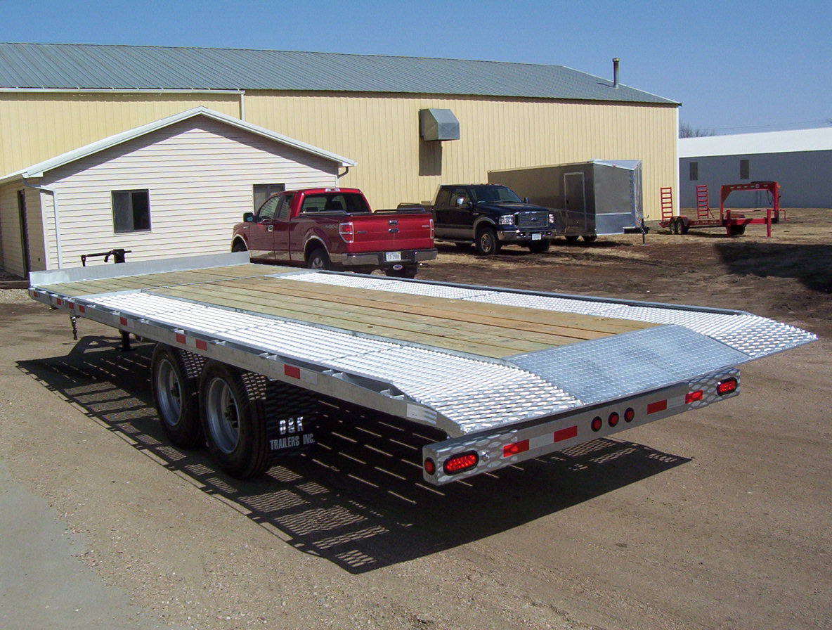

The only thing I have noticed about tilt deck's, at least in deck over's, is that the axle's seem to be pushed up towards the front for a lower tilt angle. If I'm hauling extra bucket's or attachments, they need to go on first, putting the tractor or SS towards the back. I don't like to worry about weight dist. on the trailer and with a long wb, that's not a concern. I do hate ramps though:D
/ Time for a new trailer #12
:thumbsup: me too. I've seen some galv. dumpers around here, never got close enough to see if they are from the north east or any "stickers" to ID it.

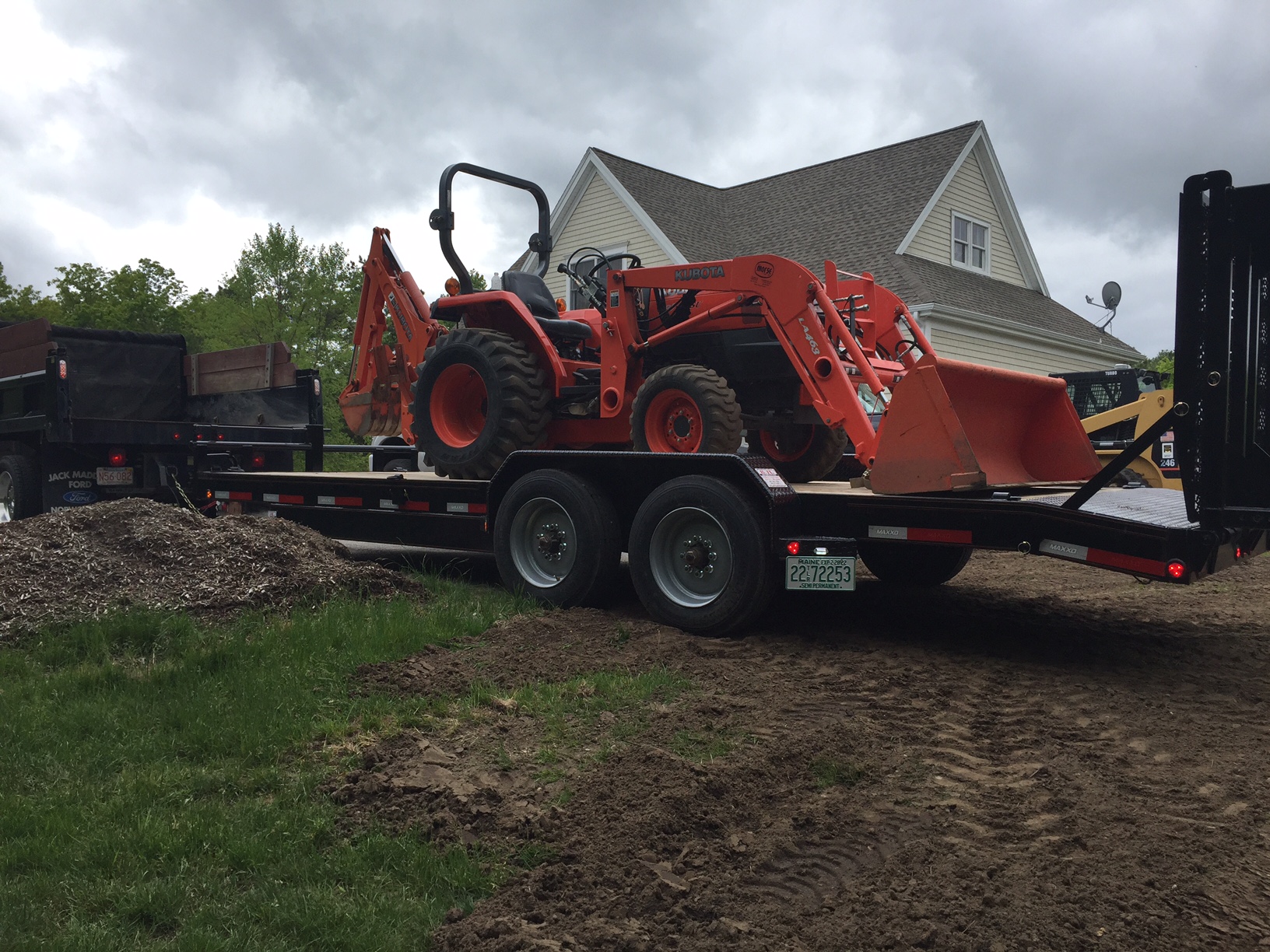

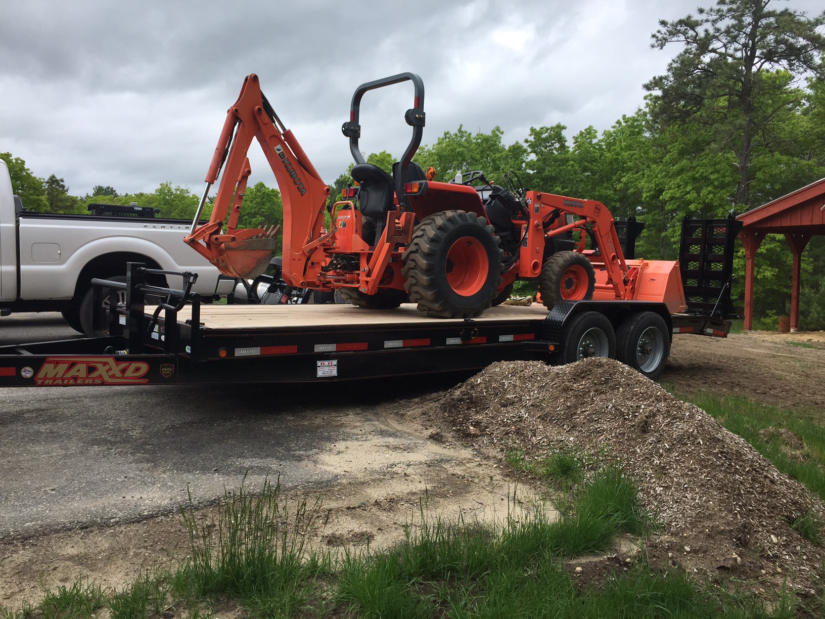

Got the new trailer today. Looked and looked within 150 miles for a 14k galvanized or aluminum split tilt. Could not really find anything that fit my needs. Ended up with this one. It's 22' and 16,500 GVW. The axles, tires and rims, as well as the trailer itself are very stout. I don't imagine I will out grow it anytime in the near future. The finish is powder coat and it is the first time I have had that. Hope it holds up well.

Looks rugged!:thumbsup:
It appears to be.. the ramps are 2 piece so they are about 7' long. They are spring assist when they go up and down. But the 2nd 1/2 is not spring assist. They are a bit heavy, but not as bad as I first thought they would be.
/ Time for a new trailer #18
Good luck with it. My experience with powder coat is not so good.
/ Time for a new trailer #20
Once it chips and starts to peel. It peels in sheets, unlike paint. But if it is a quality powder coat there should be no problem.
