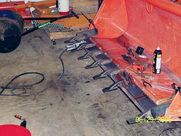

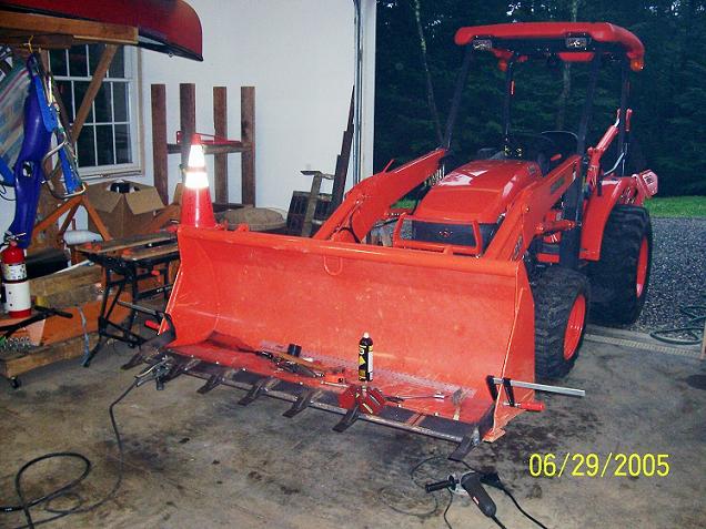

Put my new Markham toothbar on today!
/ Tooth bar cost #29
1 hour to install, had to grind a little to make room because of the corner bucket welds.
/ Tooth bar cost #30
Would a been nice and faster if the bit would a been sharper...... /forums/images/graemlins/tongue.gif

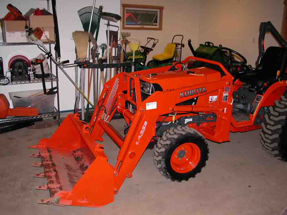

I'm glad to see your toothbar was painted orange. My friends think I have way too much time on my hands because I painted mine orange.
