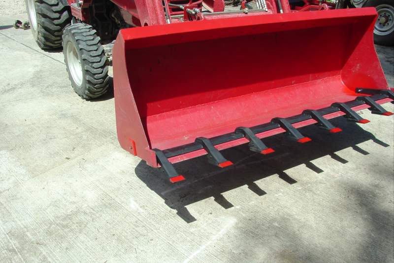

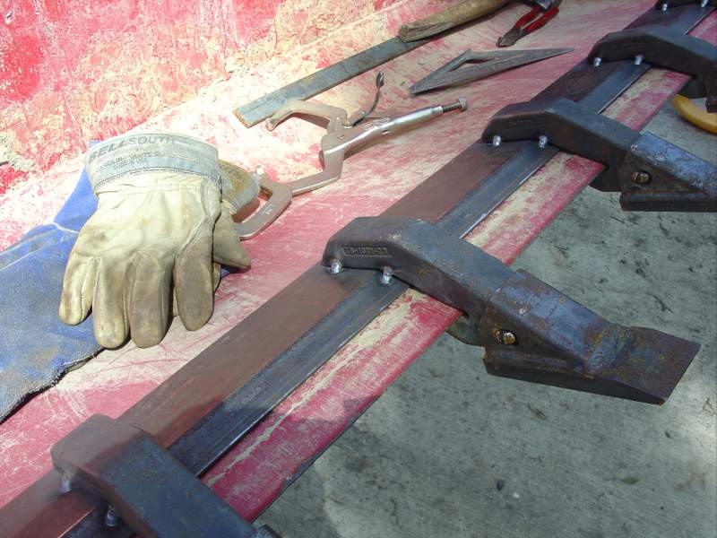

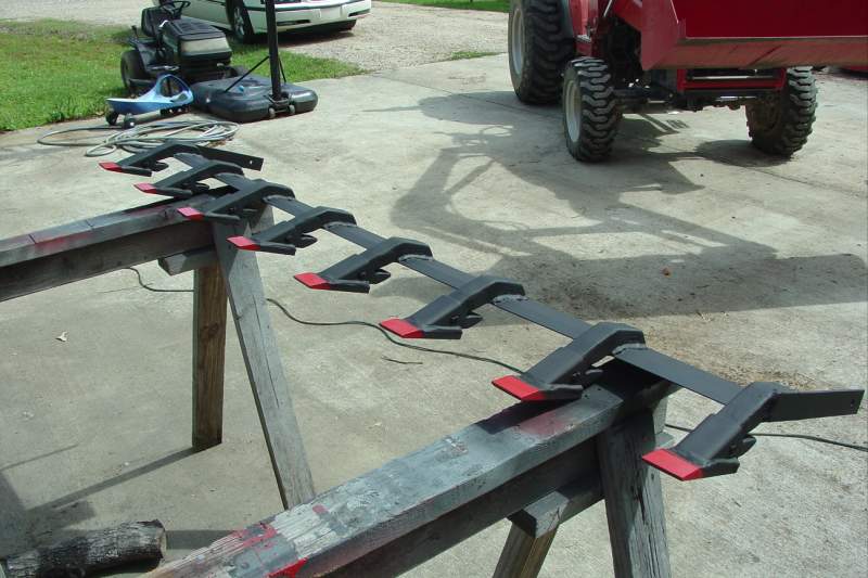

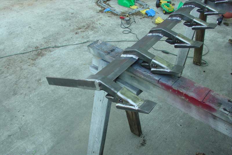

Here is a tooth bar I built this past weekend. 4"x1/2"x72" cutting edge with eight Fabco teeth.
Joe

Nice work Joe!
If you don't mind me asking, how much are those Fabco teeth?

Zick,
I paid $240 including shipping. I didn't have any dealers in my area, so they were shipped directly from Fabco. They are the TB-1001-23 shanks.

/ TOOTH BAR #5
Yeah, super nice work indeed.
Have you had a chance to try it out yet? Adding one to my bucket sure made a big difference in how it digs, but also in picking up rocks, logs and brush. I have never had it off since I installed it.

/ TOOTH BAR
Hey Guys,
Thanks for the feed back.
3RRL,
No, I haven't had a chance to use it yet. I raked up a bunch of tree limbs and leaves and have my grapple attached at the moment trying to get that mess cleaned up.
Oh yeah, I don't want to scratch the paint off of it just yet.:rolleyes:
RADE0041,
If I understand what you're asking, the original cutting edge is 1/2" thick and welded onto the bucket which is 3/16" thick and the cutting edge the shanks are welded to is another 1/2" thick for a total of 1 -3/16" thick. They are the TB-1001-23 shanks.
Joe

#11
vic4news said:
Nice job on the tooth bar. Did you use a stick welder? If so what rod did you use?
Vic
Thanks,
No, I didn't use a stick welder. I used my Millermatic 210 mig welder with .035 ER70s-6 wire and C25 gas.

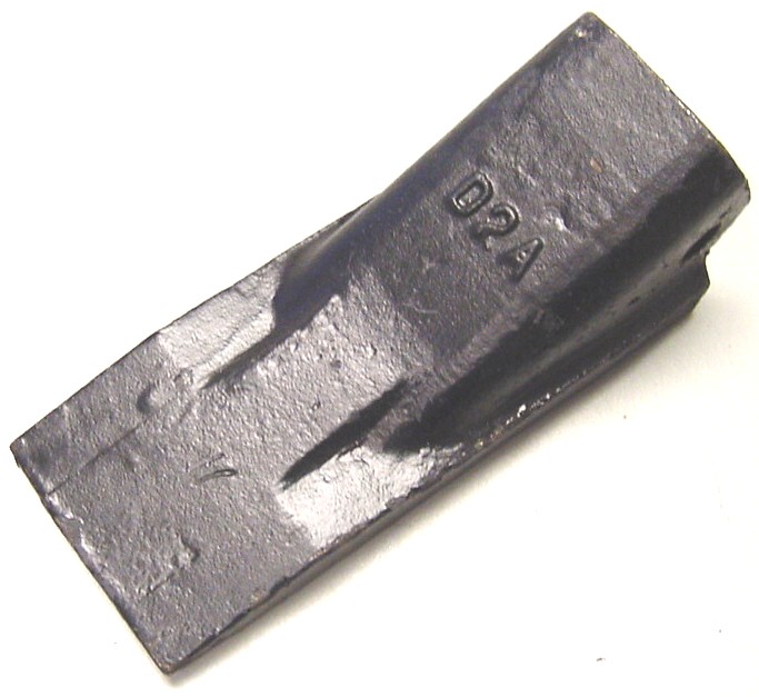

/ TOOTH BAR #15
Nice Bar!
well I don't want to start a new tooth bar thread so I though that I could share the source of where I purchased my teeth and shanks.
This was this best price that I could find. I ordered 6 shanks and 8 teeth with shipping to maine it was $88.00 Now to find time to put it together
RippermTeeth
20ATooth1 1/16"
$3.25​
20WOShank Flush Mount 1 1/16"
$9.00​
/ TOOTH BAR #16
GIJOE,
I just when back and looked at the pictures again and noticed that you welded the tooth to the shank in the crimp hole. Why? will they fall off if I just crimp?
Thanks
Phil
/ TOOTH BAR
#17
philbuilt said:
GIJOE,
Thanks
Phil
The tooth is not welded to the shank. These are not crimp on teeth. What you are looking at is the end of the pin that is driven through the hole to hold the tooth on the shank.
