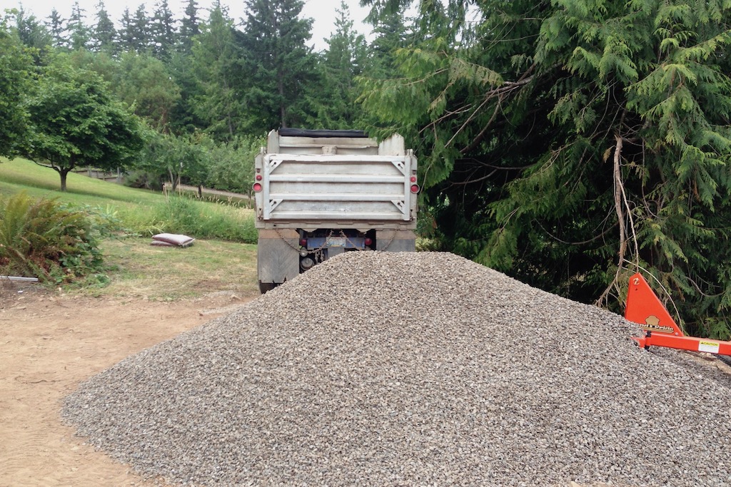

After a year's use of the Piranha tooth bar it has been more versatile then imagined.
For moving yards of dirt, cleaning fence line, removing vines overgrowth on trees, ripping hedge rose by skimming the surface.
The tooth design is very effective. I also used it to move 50 yards of gravel for our road base. Slices into the pile easily.
Do not think a plane jane flat bucket extender or other tooth designs would as versatile.
Save the 400 bucks and install it yourself. The tooth bar can be installed in about an hour. If you order from BXpanded ask for the step drill bit. Once you make the pilot hole it cuts like butter!

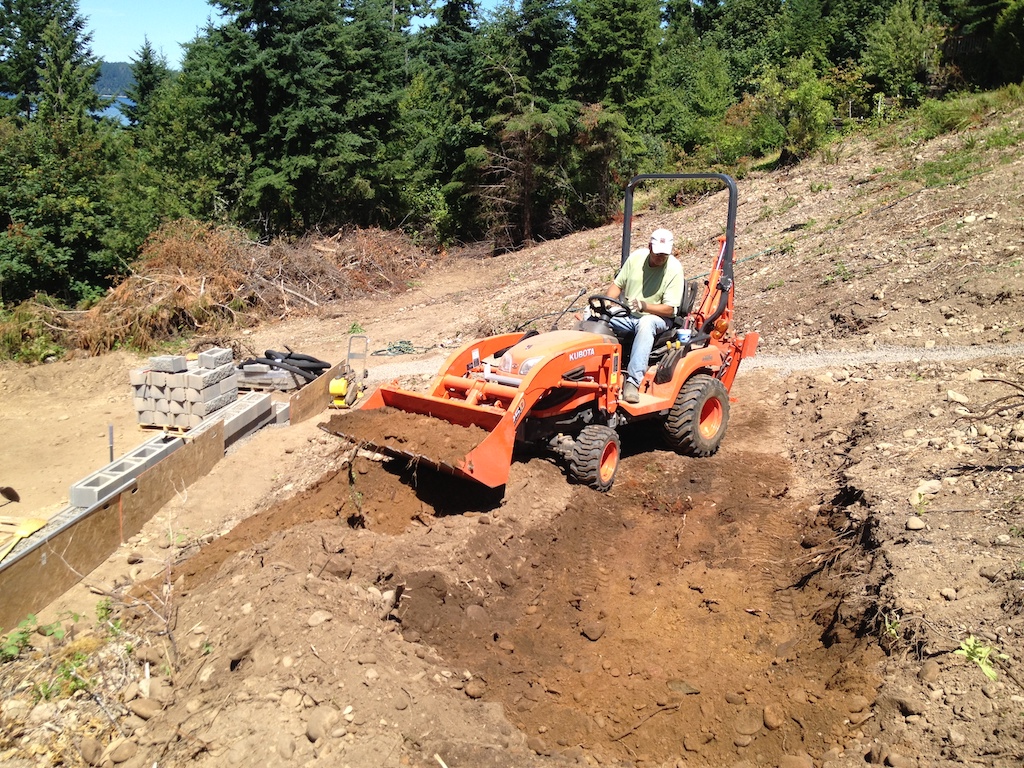

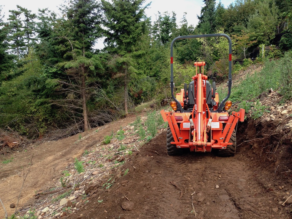

CMV:
Just my .02 cents. Maybe this will help. I have two Kubotas, but let's talk about the BX25D. 23HP with a 48" bucket. I installed this (Titan 48" Bucket 23TF Tooth Bar Universal Size Skid Steer Tractor USA Made) tooth bar last spring when I had to level out a hillside to put a 20x40 shed down. I thought about doing the whole thing with the backhoe but by dumb luck I gave it a go early spring when the ground was still a bit wet.
Buy letting the 4FT bucket slam those teeth perpendicular into the ground (which was mostly sod), I was able to drag the bucket, in that perpendicular position backwards and loosen about 4" deep, 10' long each time. I went easy and made a few passes before I turned the bucket up to scoop up the loose soil. I had to go from 10" to zero and then in 20 feet deep, 40 feet across. It took me about an hour-and-a-half to finish. I have a bit of shale here in Pennsylvania to contend with but the tooth bar made short work of it. Also, if you ever have to move buckets of gravel about the size of a quarter, the tooth bar allow you to scoop it better than just the raw edge, which has a tendency to push it around. PLUS (and finally) the tooth bar helps keep the lip of your loader bucket from bowing. Hope this helps. Good luck and Godspeed!.......... BotaTrac Out!
