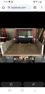

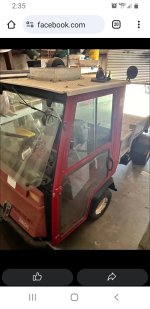

Just pulled an Industrial Toro workman in the yard, carb issues. Got surprised with several nice options.
   / Toro Workman 3200 project...anyone have one of these? #51
Bed hydraulics were expected till I bought an Industrial Toro in KY..., todays Industrial Toro has them, as well as the high/low range tranny, rear aux hydraulics and for the first time, I have ever seen a rear PTO in real life! The KY Toro Workman Industrial out of KY has none of these options, but it does have a cab and is a running unit. I think not having carb issues may be related to it being a propane unit. Todays Toro Workman Industrial is a gasoline powered unit.
