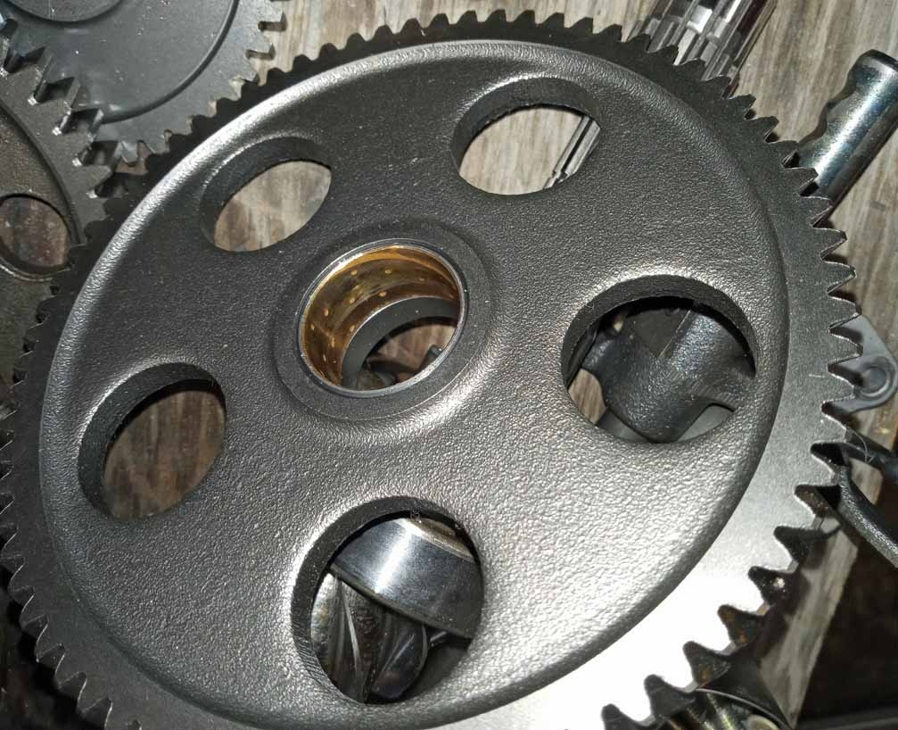

After a year of not running, my Workman started right up. Runs smoothly and quietly.
I get the trans noise in 3rd gear only, in my testing, tho I am only using low range. I assume it will manifest in 6th, too. Anyway, I put the rear on jackstands and ran it at multiple speeds in 3rd. Very noisy. Loudest right under the TORO logo on the tranny. Super-loud when I rev the engine.
I posted 2 videos:

Yeah, that doesn't sound quite right!
What are your plans as far as tearing into it, or just replacing it?

#45
I suspect this is the problem, and I will replace the plain bearing, if so. A sloppy bearing on this big gear, which transfers load to the jack shaft, will wobble a LOT.
This gear is from my spare tranny.
