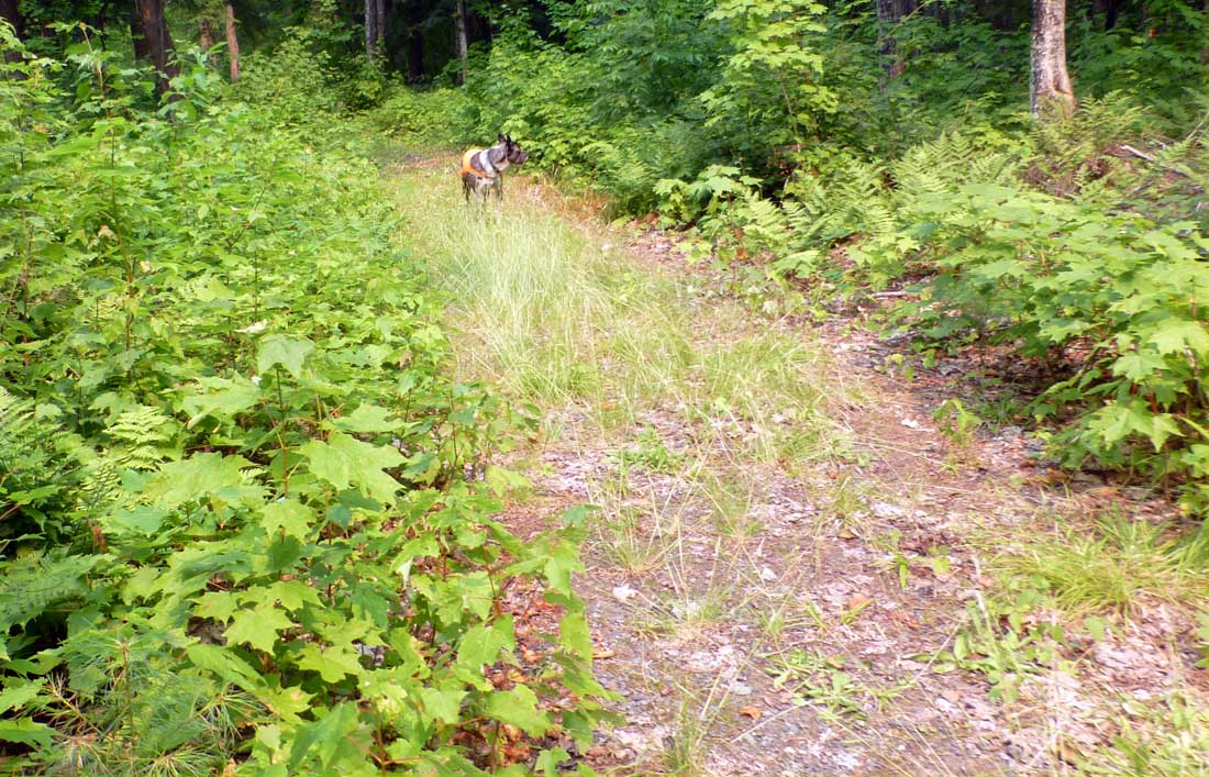

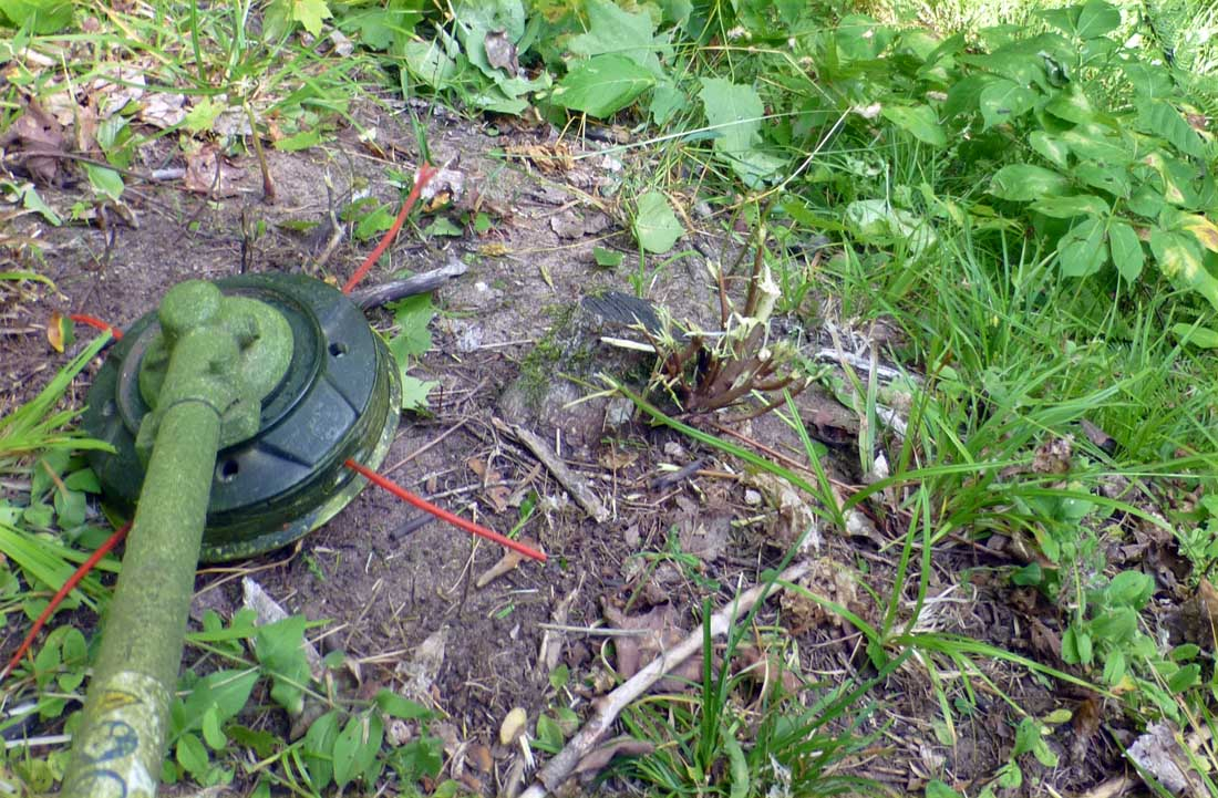

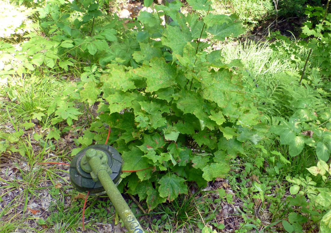

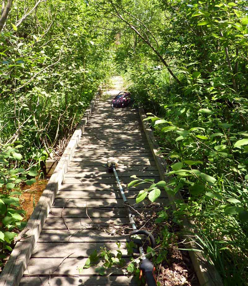

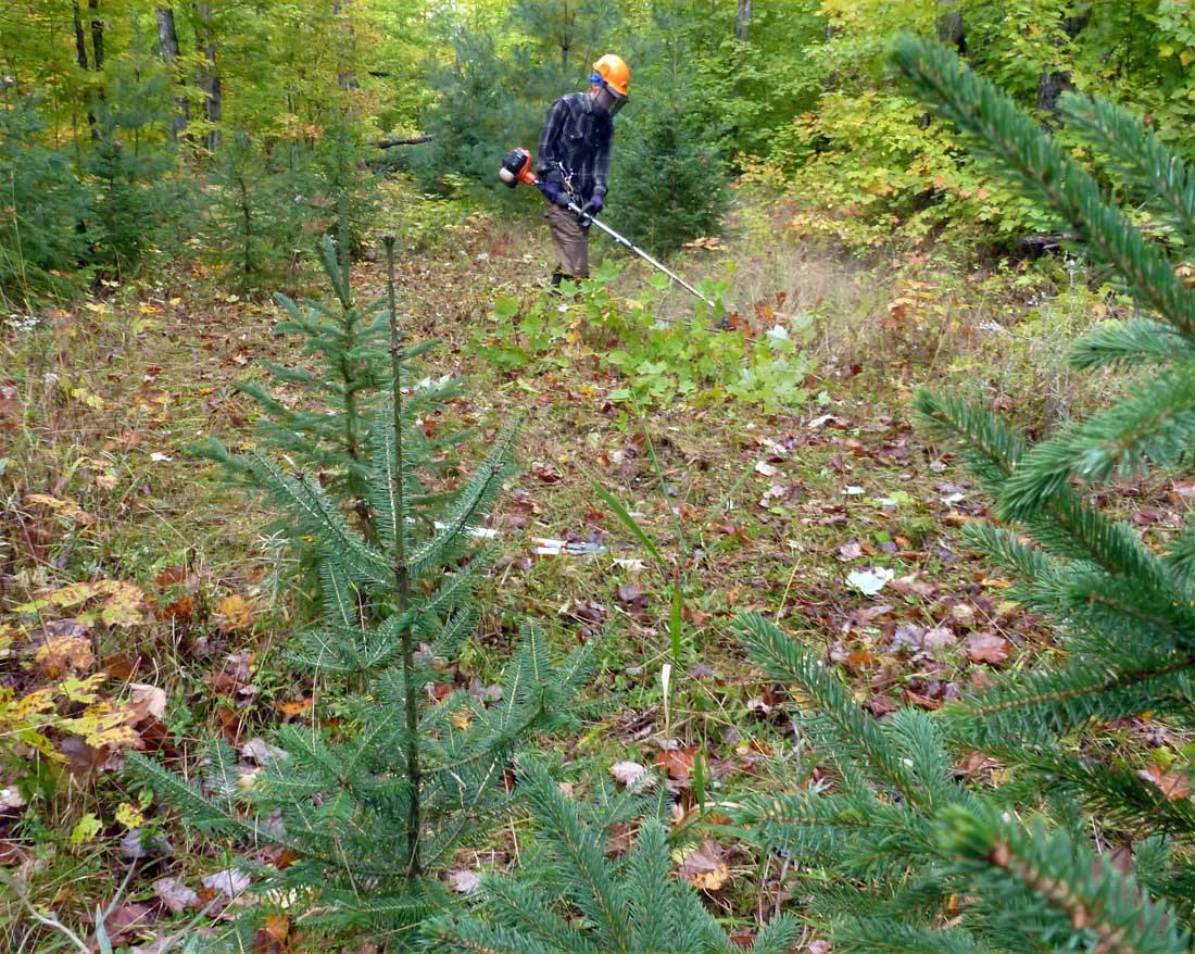

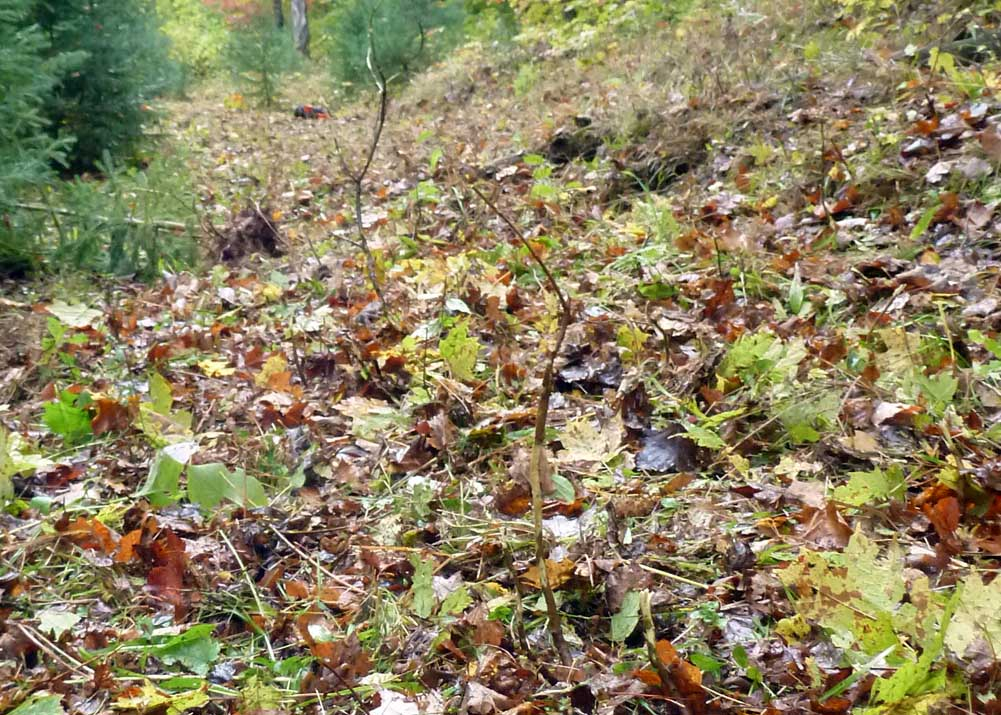

Here is shoots and weeds that will be whacked with .155 string.
and afterwards.

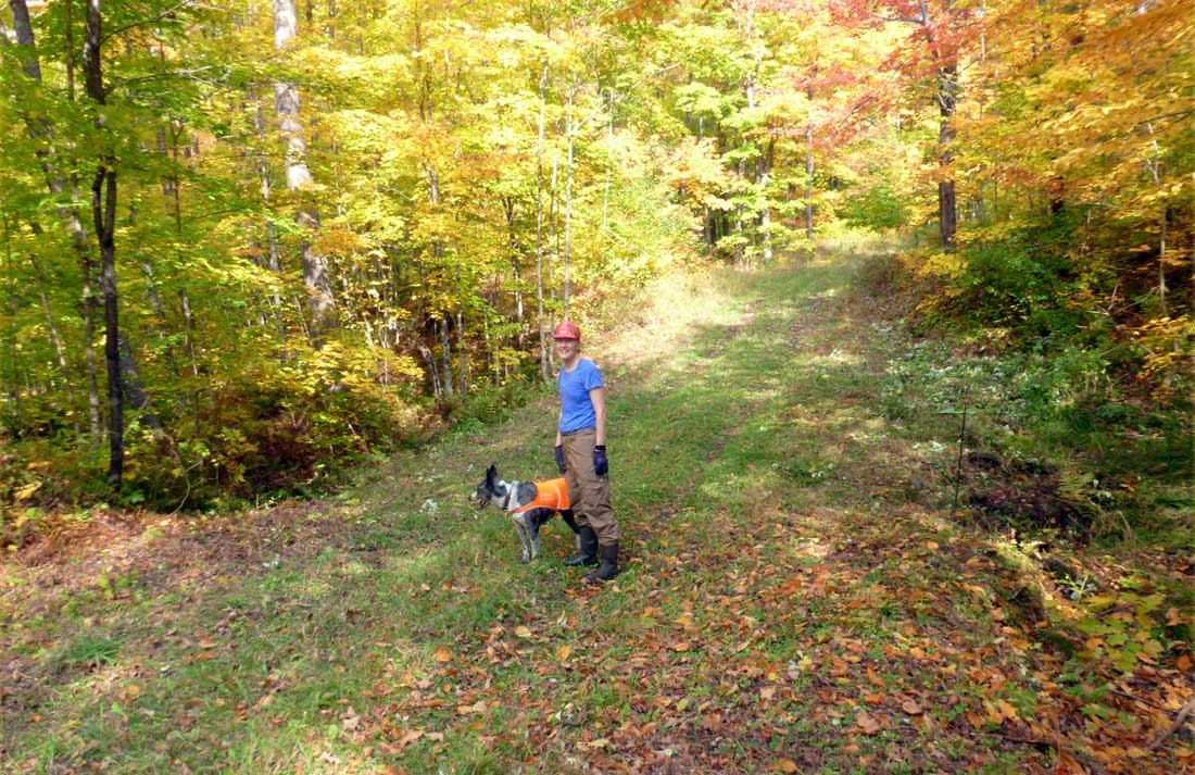

We spent just a few hours out there today and cleared a turn-around spot on the logging road. Man-o-man colors are at there max here. First photo shows the area that needs to be made a bit wider.
After clearing, it gets tested. I went around it going both directions.. Its margianly wide enought since snow and pods makes machine turning radius much larger.
We cleared on more spot before our short work day came to an end.

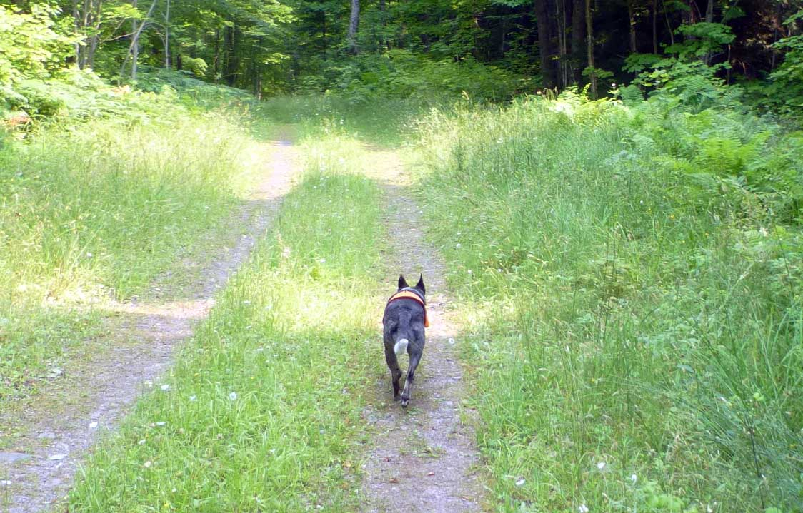

I read a good way to smooth trails was to drag a tree. So happens in the last 2 years i have cut down hundreds if not thousands of weedy trees, nasty undergrowth stuff that varies from, 1-4 inches, 4-5 different species. I leave the big ones!
i've dragged these tree bundles over the same trails and those trails are smooth as a babies butt!

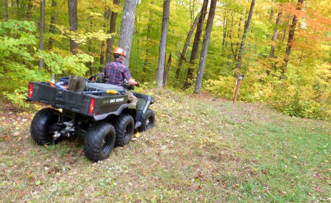

#228

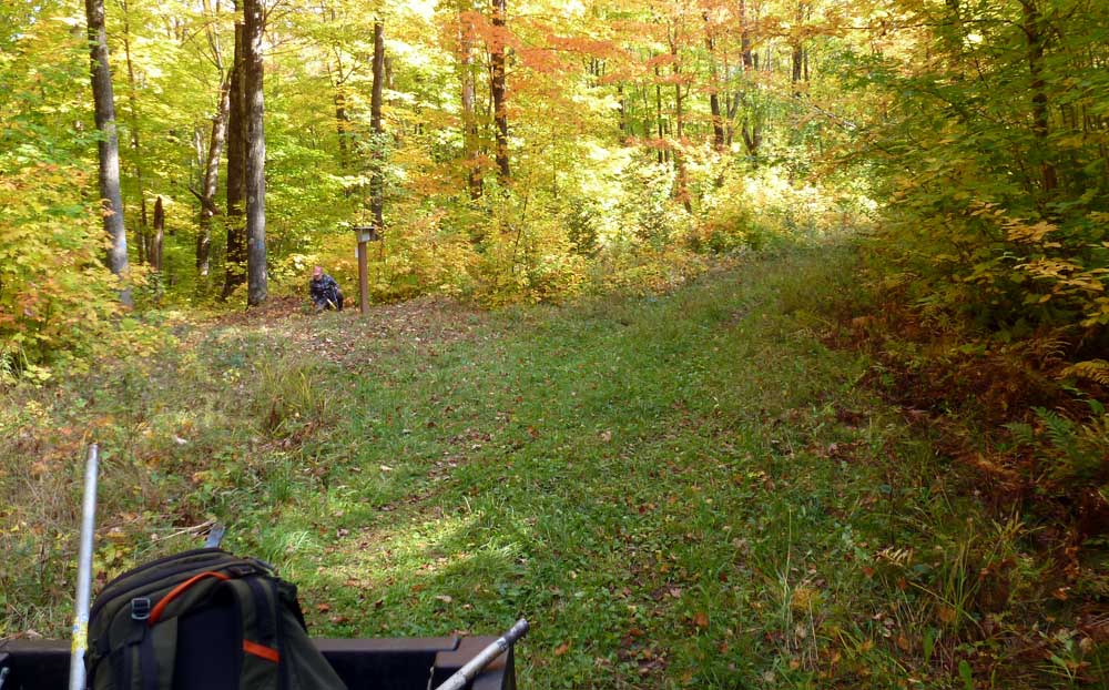

We worked on a different section today on the same system and got something done to it. We worked off the end of a logging road seen in earlier pics and cut a turn around trail. This would be a "lollypop" like portion.
Behind Wally is what we will be clearing.
What a day to be in the woods!
Here you can see what we did, after it was cleared.

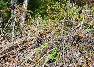

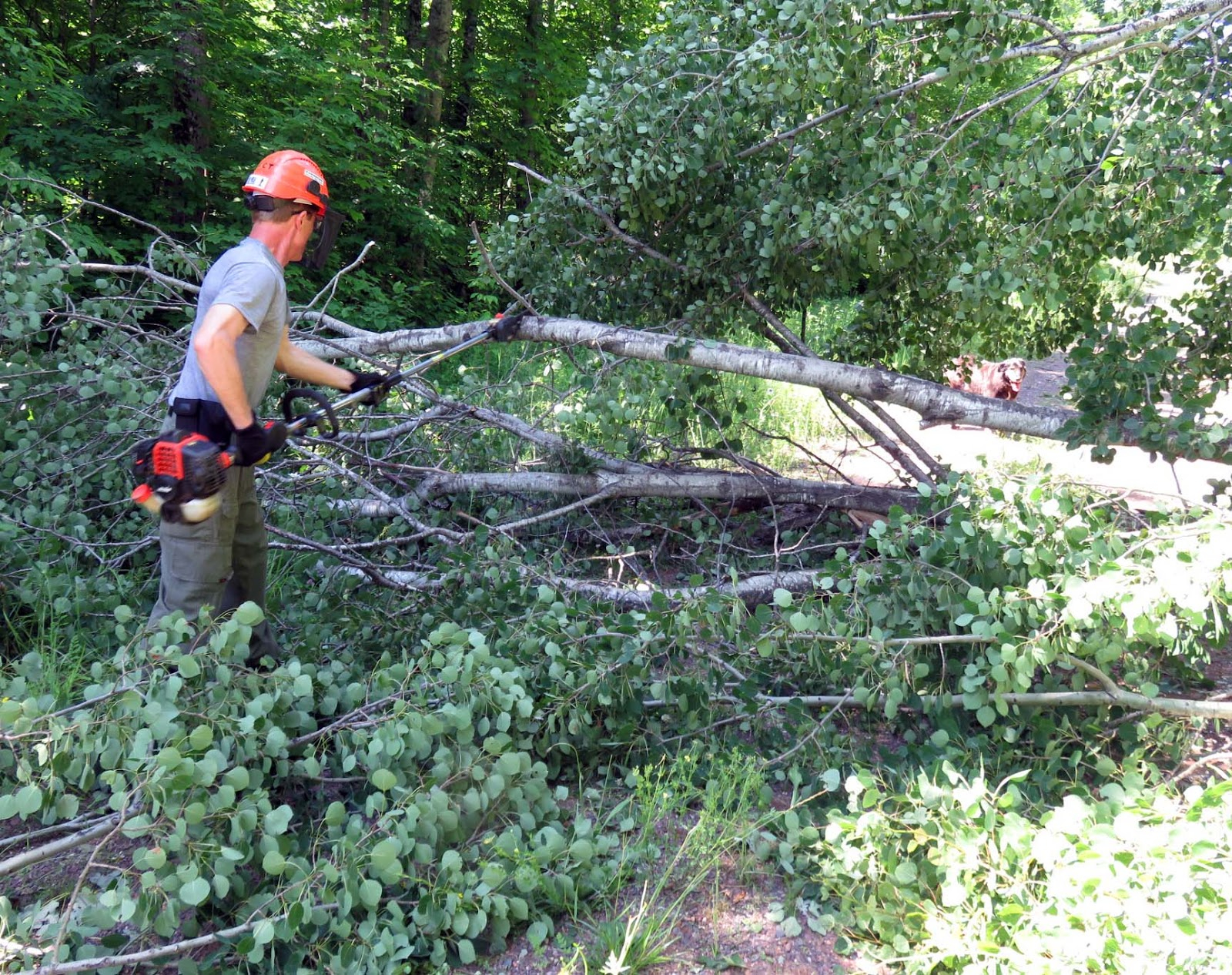

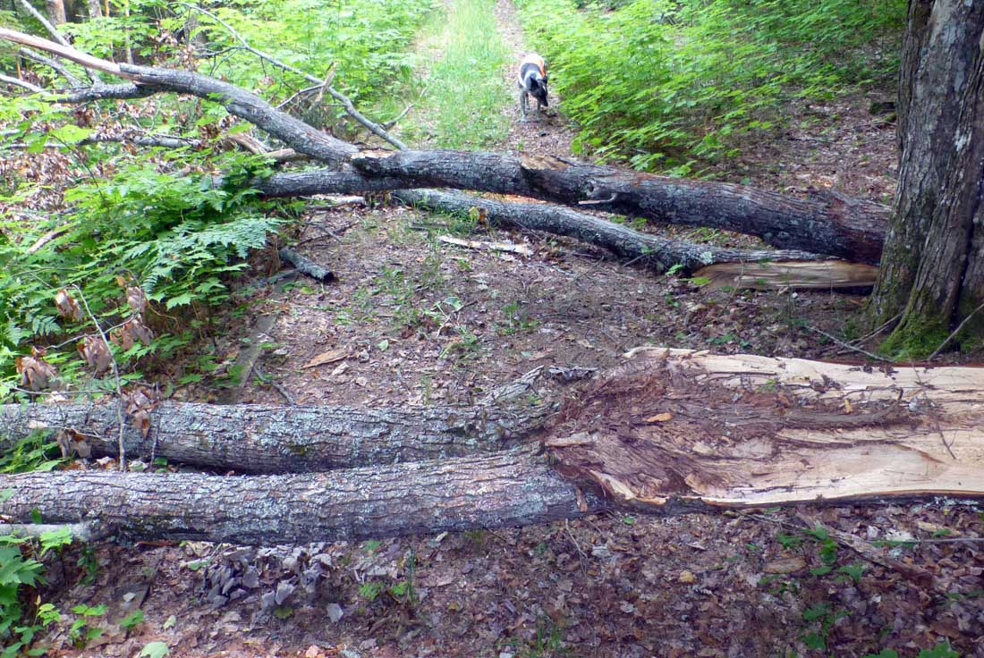

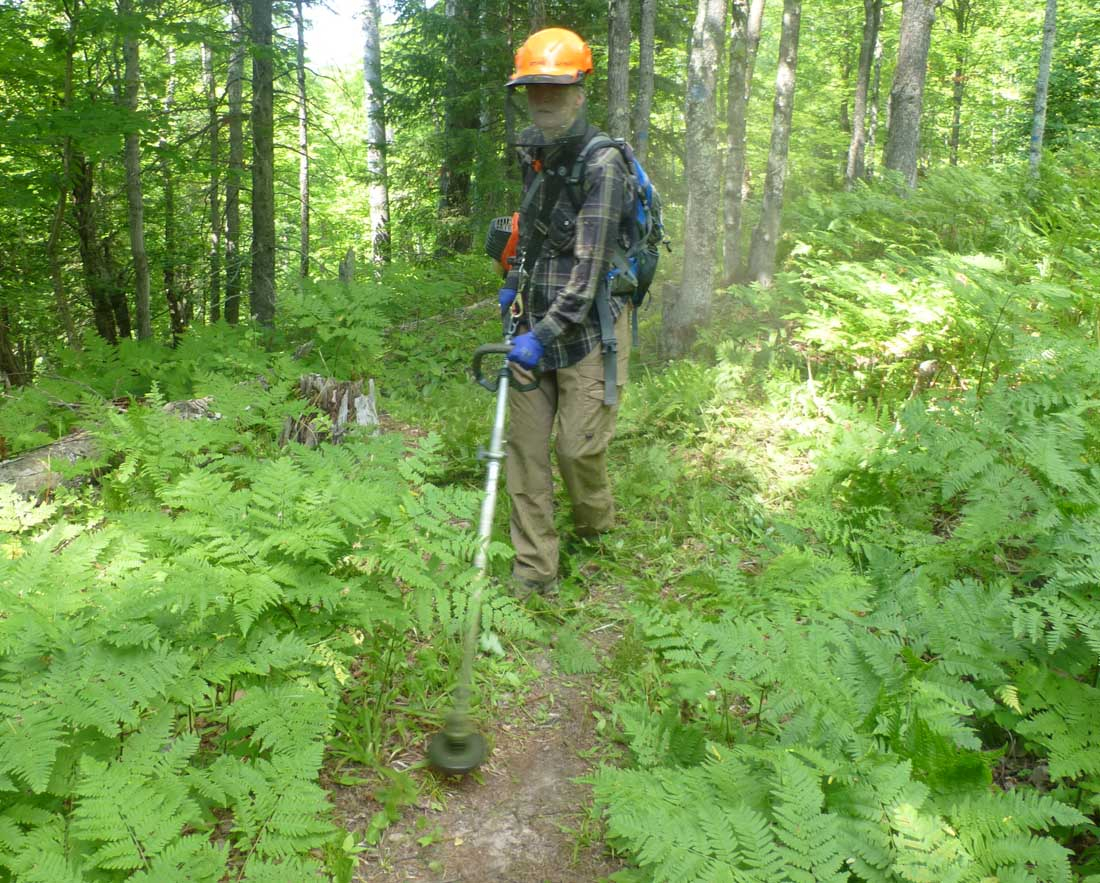

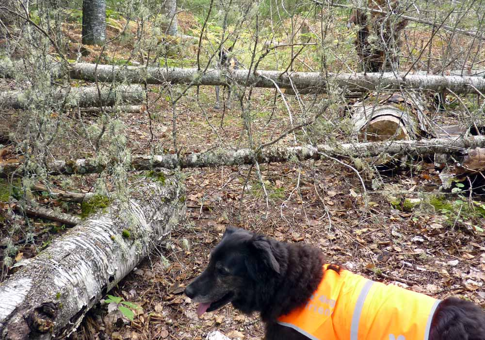

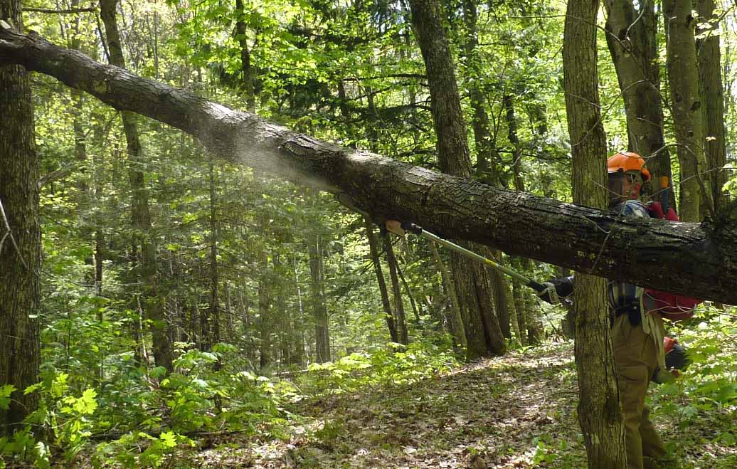

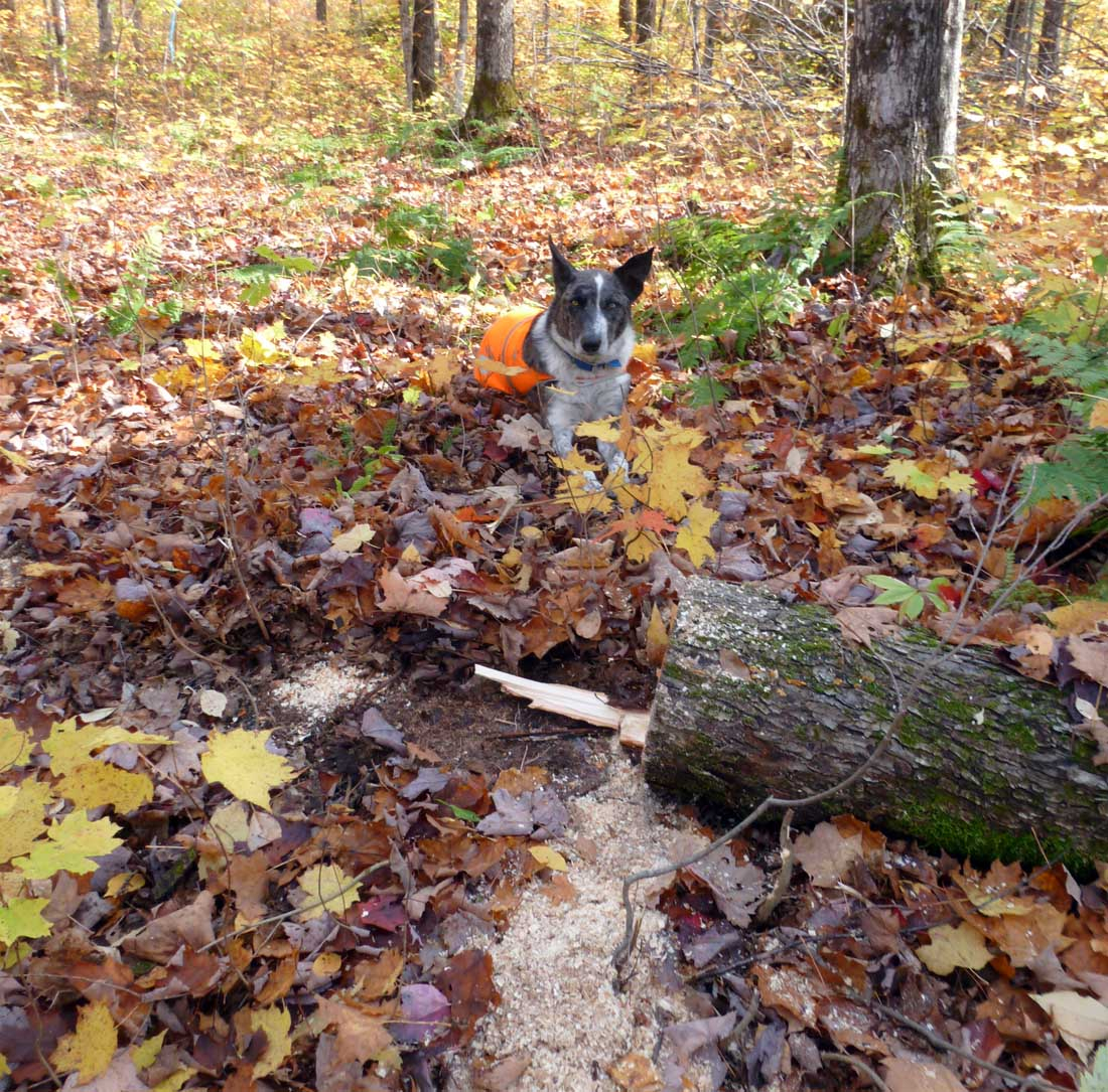

Pics taken today while clearing this trail. 2 legs of this three section trail have now been cleared.
This dead-fall was kerfed off so as to not hook an implment. Only pole saws used.
The sun coming up and getting over the canopy this am.
This branch will be pulled down by snow and onto the trail so its coming off.

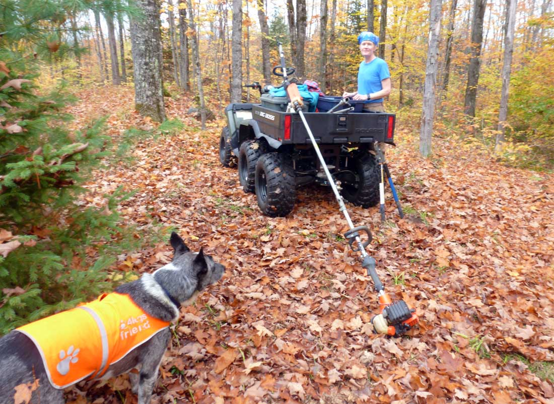

I did not see a make or model for the cam lock string cutter heads shown in you photos. I reviewed Amazon and stihl pages and yet to see a model quite like this you have such success with. I have several acres with fence and overgrowth and probably be able to squeeze a few more years out of a stihl string trimmer if I could locate a good string head. I had a walk behind gas engine string trimmer that used a similar head but the rest of the machine did not hold up. if you could provide a make/ model and source I would appreciate it.
   / trail clearing technique and tools
#239

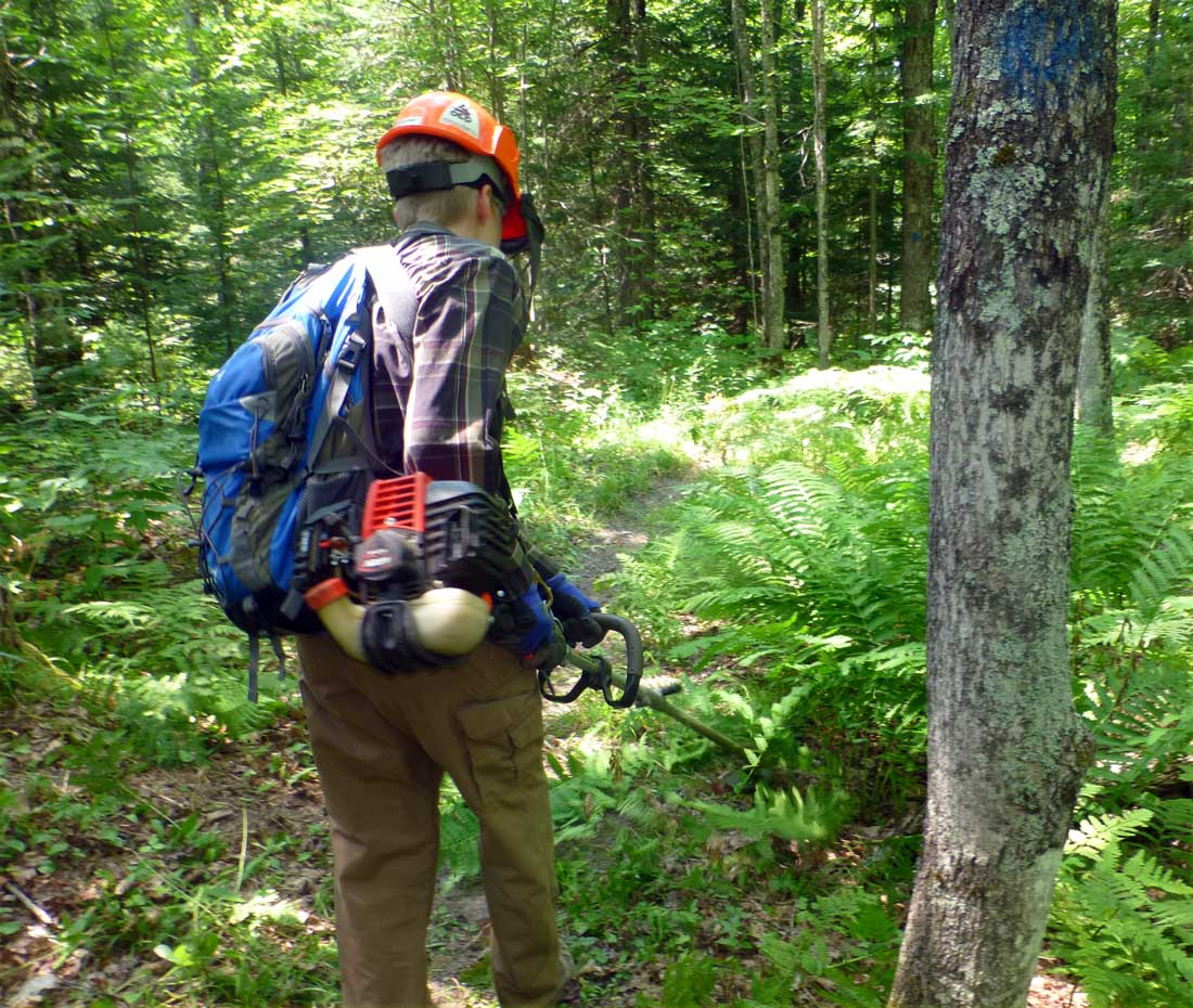

Its a "Fixed string head" but you need one that works for .155 string if you hope to run that. We used Oregon made ones for years but now I can't locate them. I did see some metal ones but we tried them and didn't like them. Plastic is the way to go so you can run them against the ground.. The last two we purchased were Stihl built so I'd suggest you call your locale dealer. Sorry I can't be of more help. :cry:
   / trail clearing technique and tools #240
My wife uses the same thing, she bought the head at our LHS that carries Echo (her trimmer is a light commercial Echo unit), but the head itself may be a Stihl. She also swears by the .155 for blackberries / oak shoots & suckers; before she starts I'll see her cutting a big batch of lines and then she goes out and works for a while.
