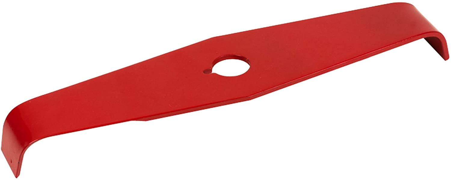

This blade isn't like any line or any conventional blade that you've ever used. You should try one. It doesn't cut the blackberries, it shreds them down to the ground. Just drop it on the top and the blackberries are in bits. You can just cut too if you want. Even grass. I got one for my BIL who has your same trimmer. He too was just blown away.
