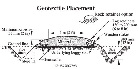

You may need to construct some puncheon. I looked for a video showing how it is done and couldn't locate anything I liked. Here is a photo of the idea.

That might work, would have to make wider since it will need to have a tractor roll on it.
What we've done is stake 6x6 down the width you need to be. Add 4x4's to hold the left and right 6x6's together because the material you add with be pushing the sides (6x6s) outwards. All these are of course ground treated wood. Add geo mat and put in the sand/gravel. If you have water flowing to the other side, then you'll need to add culevrts so your puncheon doen't make a dam. This is over simplifed but that's the idea..

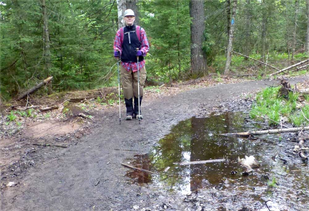

Out checking trails yesterday. Top two is a newly built ADA trail that needs further water control done to it...
Maple shoots we'll need to cut on a different one.

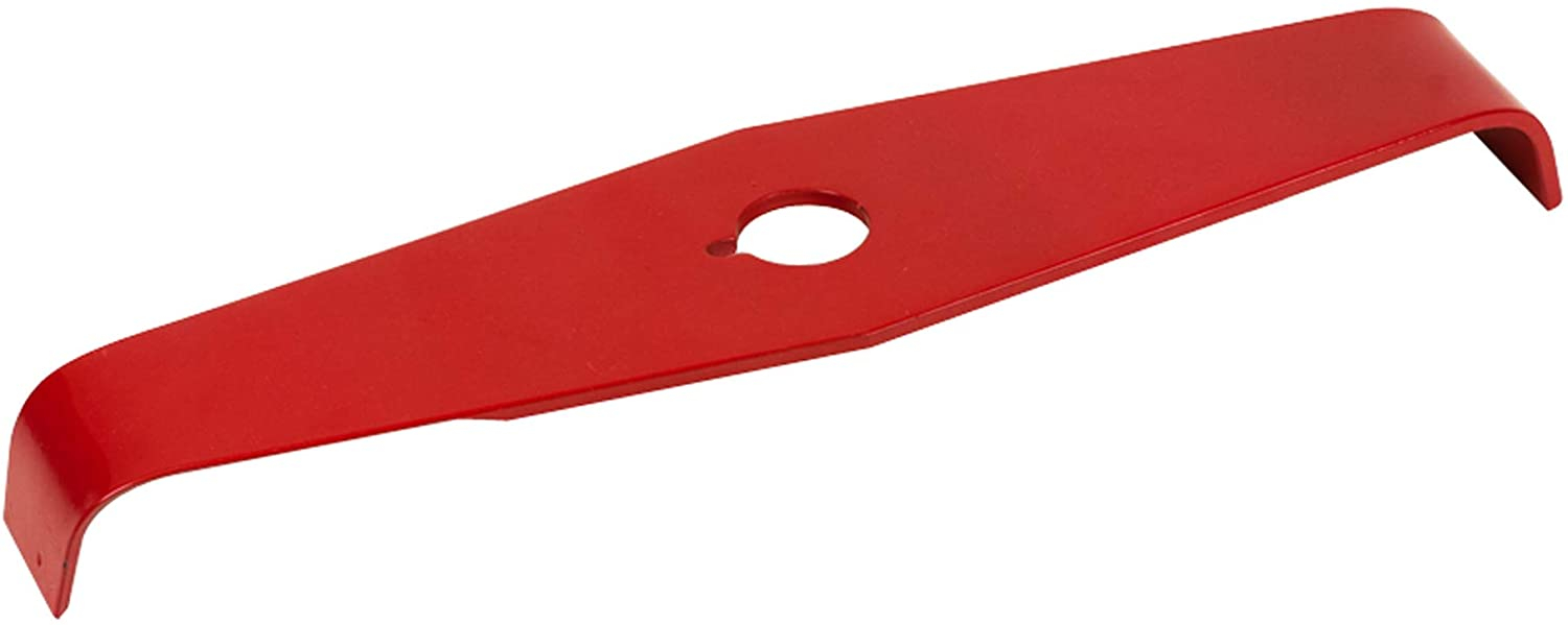

I work like to try one of these blades to cut the shoots down as seen in the above photos. Might be better in the gravel and rocks we work in. :unsure: Has anyone used these?

ArlyA Don't waste the money. The rivets break and send the knives flying. I had 2 that disintegrated cutting under 1" brush. When one gets knocked off it goes out of balance and all the rest go within a minute or 2.
Depending on what your doing a 12" saw blade works wonders for samplings, sucks in grass. All of the 3-4-6 knive blades only work for grass and weeds. I've gone back to just using .105 string and saw blade.

Thanks for the review! Could the rivets be replaced with 10-24 cap screws or some size along with nylon lock nuts??

Wouldn't waste the time. The knives bent when they hit hard stuff. You'd be way ahead getting the plastic knives gator head from the home improvement store. They work and last way better.

I was lucky I had steel toes and thick pants on when the steel knives came off. I had one slice thru my pants and catch on my boot. They are way to chinsy and dangerous to be any good.

Lucky no one got hurt. Sounds like a wonderfully dangerous tool from a place where liability is non-existent.
