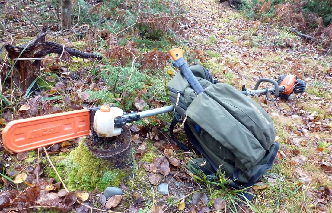

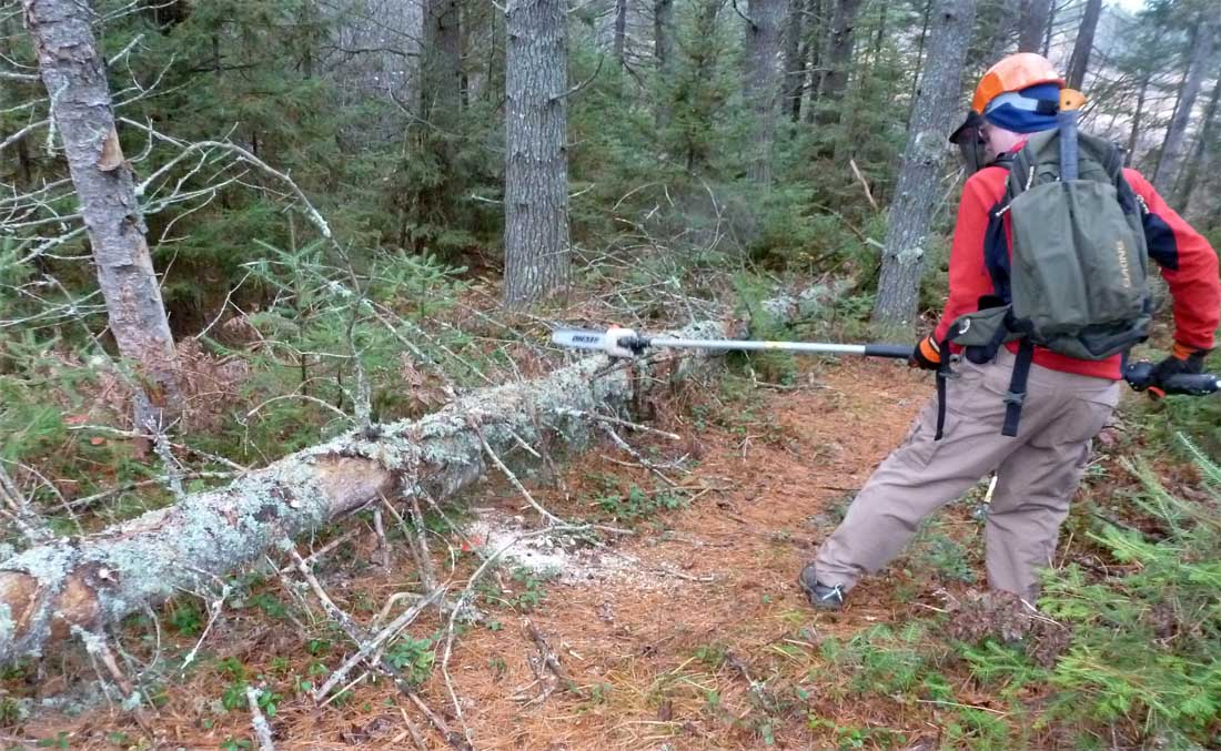

   / trail clearing technique and tools #485

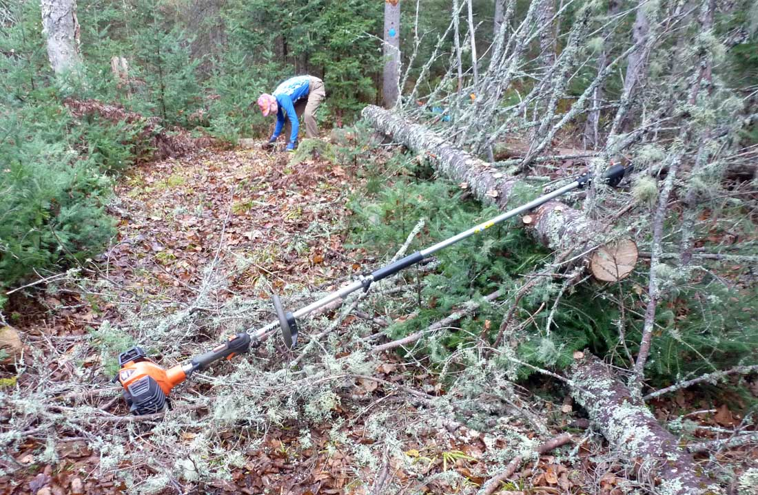

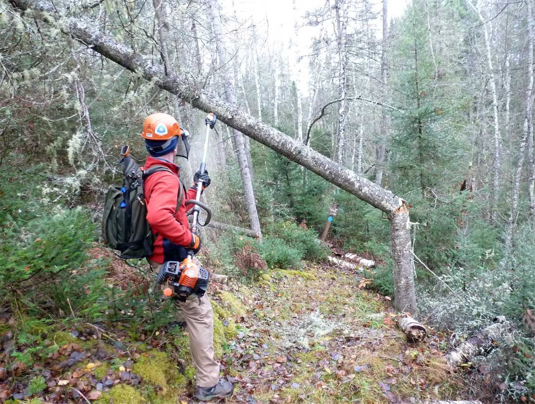

We've done a fair amount of walking/x-c ski trail development on our managed forest and surrounding Crown Land (=public land) in Ontario. A couple of comments:
1. Like OP (and some others in this thread), a pole saw is more valuable than a chainsaw for walking trail clearing. A gas-powered, professional multi-attachment tool like the Stihl would be nice, but we've had good success with the Kobalt 80V (=Greenworks 80V) line, the attachment-capable trimmer with a TrimmerPlus pole saw and brush cutter head in particular. We previously tried this on a 40V setup and it was not powerful enough, but the Kobalt/Greenworks 80V is. (Power is not driven necessarily by voltage, but higher-voltage cordless gear is typically engineered for more power. Exception: Makita and Milwaukee M18 Fuel, at least for chainsaws)
2. Where the Kobalt/Greenworks lags Stihl (or similar) the most significantly is not power, but durability/duty cycle. We've burned up a pole saw and trimmer by using the pole saw too much over a short period, heating up and melting some of the plastic in the mechanism joining up the attachment.
3. Don't neglect manual tools. There's typically 2 of us, one with the polesaw/cutter, and the other with a pair of 2X geared manual loppers or machete. We switch every 30 mins or so; you'd think the motorized would be less tiring, but the weight + level principle actually make it the more tiring job.
4. We've found the standard rotary brush cutter blades too flimsy and rock-intolerant. A Renegade Blade 56-tooth or similar rotary blade works better. Yes it gets dull (esp if you hit rocks) and can't be sharpened, but it fails less spectacularly than one of those triangle blades.
5. Around here, a trail is best built in the spring, when you can see terrain and also where there are drainage issues. But once established, it's best maintained in the summer, when you see what leafy growth needs trimming.

   / trail clearing technique and tools #493
What do these Kobalt 80V or Greenworks 80V units weight?? How many hours run time do you get? We also run considerably larger string that what this machines come with and it takes power to spin.
My subjective recollection is that they're very slightly heavier than Stihl gas units - the greater weight of the battery offset by somewhat more plastic vs metal (which is longevity/duty cycle related of course). I see from online reviews the Kobalt, with original trimmer head on, is 13 lbs including 2.5 Ah (200 Wh) battery. The Stihl is 10 lbs, plus call it 1 lb when close to full of gas. That feels plausible. That extra 2 lbs is on the end near your waist, where it's held mainly by your carrying strap; it would be a lot more annoying if it were on the business end.
I've seen promises of 40-50 mins nonstop run time for the trimmer for a 2.5 Ah battery, with normal 0.08 line I assume.
Your use of 0.155 line is new to me and I've stored it for reference. How thick twigs can the 0.155 handle?
It feels like we're dealing with different vegetation types. I can see trimmer-with-thick-string working very well where you have thick grasses with small bushes, blackberries, brambles, etc. Too much for 0.08 string but thicker string presumably lets you clear it with slow and steady sideways motion. For us, we don't have solid vegetation groundcover. What we have are hawthorne bushes and sumacs in clearings, and baby oaks and maples -- woody stuff with stems up to pinky size -- forming a forest understory. I have my doubts any string will work well on that, and we're not doing steady side-to-side clearing where width of path cleared would be crucial. We're walking along hitting specific stems for the most part. Hence the steel (Renegade) blade works fine. But I'll see if I can get my hands on some thicker line and give it a whirl! Always happy to try new stuff.
With our usage pattern in mind (sporadic not nonstop use), for a half-day, I take 2-3x 2.5 Ah batteries. I may only use one if all I do is brush-cut stems here and there, but I may need all 3 if I'm doing a lot of polesawing, pushing the capabilities of the polesaw setup with 4" thick stuff. There are larger (4 Ah??) batteries but they're heavy and I prefer swapping out. There are also 2.0 Ah ones, but they don't last as long, in fact delivering less than 80% operating time (=2.0/2.5) before the power gets low.
If your gas setup works for you, I think the battery setup still lags a bit in comparison, unless you have a compelling reason to switch. We want the quiet, and not to futz around with 2 stroke engines and spilt gas on clothes, etc. With those extra factors, I think it's good enough, but not quite equally good yet. Which means it may well be in 3-5 years!
