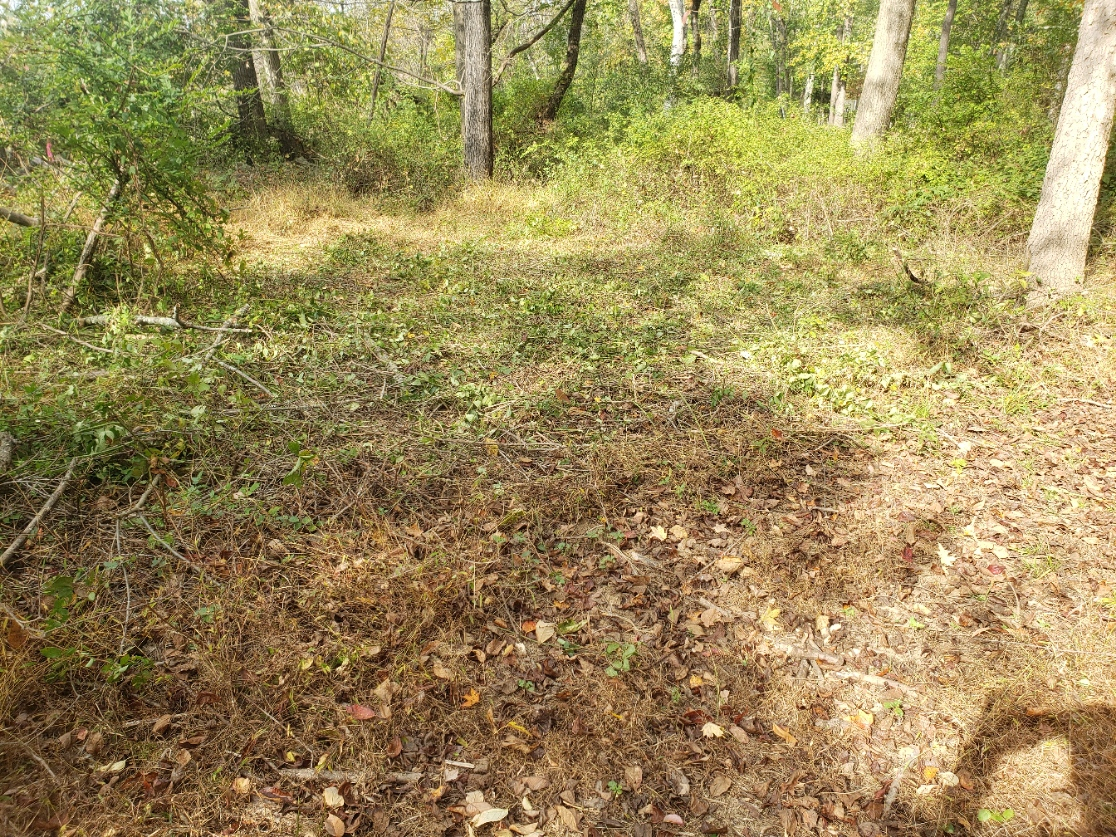

We had a tractor with a flail on do the wide parts of our trails over the weekend but we haven't seen what they look like in person. Here is pics we were sent by the fellow of did that.

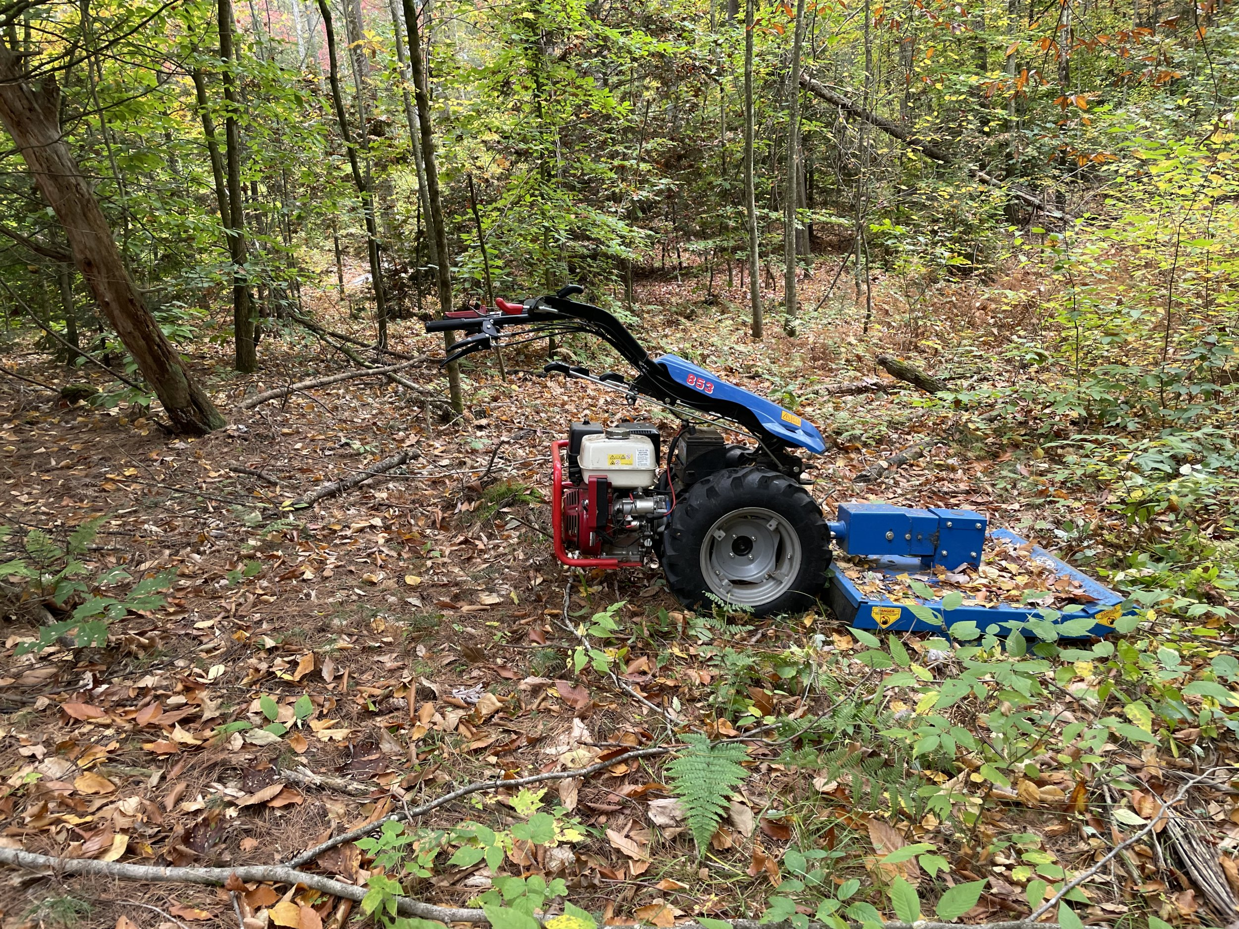

Its not been uncrated yet. Not sure when we'll be seeing or receiving this new unit. I will say that we used the old unit over the weekend and might be one of the best trail working investments we've made over the past 5 years. (not a recent pic)
