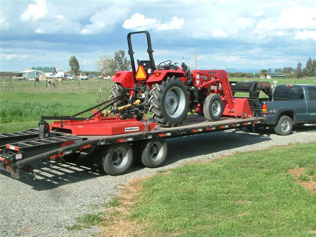

I have a 50 hp Farmtrac 60 with loaded 14.9-28" ag tires/fel and a 6' mower that rides on a new 10k GVWR bumper pull 18' dovetail with tandam 5200 lbs axles/10 ply rated tires. The trailer weighs 2460 lbs unladin.
With 1000-1050 lbs on the truck the load on the trailers axles is around 9500 lbs depending on the tractors loaction.
The bucket sits on the trailers deck and the mowers tail wheel hangs over about 24". In my state legal overhang is 2/3 of the distance from the aft trailer axle to the rear most part of the trailer.
I've pulled out to 250 miles a few times working on a lease. No issues
Previous trailer was a flat deck 16' 7k GVWR (two 3500 lb axles). It was severally overloaded. After one 75 mile trip I sold it and got the correct trailer. Much better towing especially with 10400 lbs of trailer brakes vs 7000 lbs on the old trailer.

Interesting thread as I am trying to figure out if I can fit a TN70D with a 32LA FEL and a Rhino TS12 flex wing mower on my existing trailer. The trailer is a 22' utility goose-neck with a 14K gross wt. A notation on the trailer says not to load more than 10K on the trailer.
I think the tractor/FEL/mower combination will weigh about 9800lbs (operating weight). The overall length of the tractor/mower combination is 21'6-1/4" from the front of the tractor to the rear axle on the mower (I will run the loader bucket up over the trailer neck).
If I add a 2' dovetail to the rear of the trailer, I think I can load and unload the tractor/mower without ramps. The older I get the less I like ramps!
My truck is a '06 Dodge Ram D3500 which I regularly use to pull this trailer at gross weight up and down the interstates (non commercial). I do chain it down according to DOT specs just for safety's sake.

I tried loading my TN70D with a 7' 3pt shredder on the goose neck trailer a few times and was semi sucessful. The trailer deck was about 24" above grade so I had to put the tractor in 4WD to climb it. That was okay except I knocked a couple of tire lugs loose on the back tires in the process. I was thinking of installing a 3' dovetail where the end of the dovetail was 12" above grade. That puts the dovetail angle at about 30 degrees. I should be able to climb that without any trouble. On the 12' batwing shredder, the back shredder tires would ride on the dovetail. If I have trouble with them dragging, I could hinge them at the back of the trailer and raise and lower them manually as needed. I would need to come up with a lever and latch system (pat. pending) to make this work.
